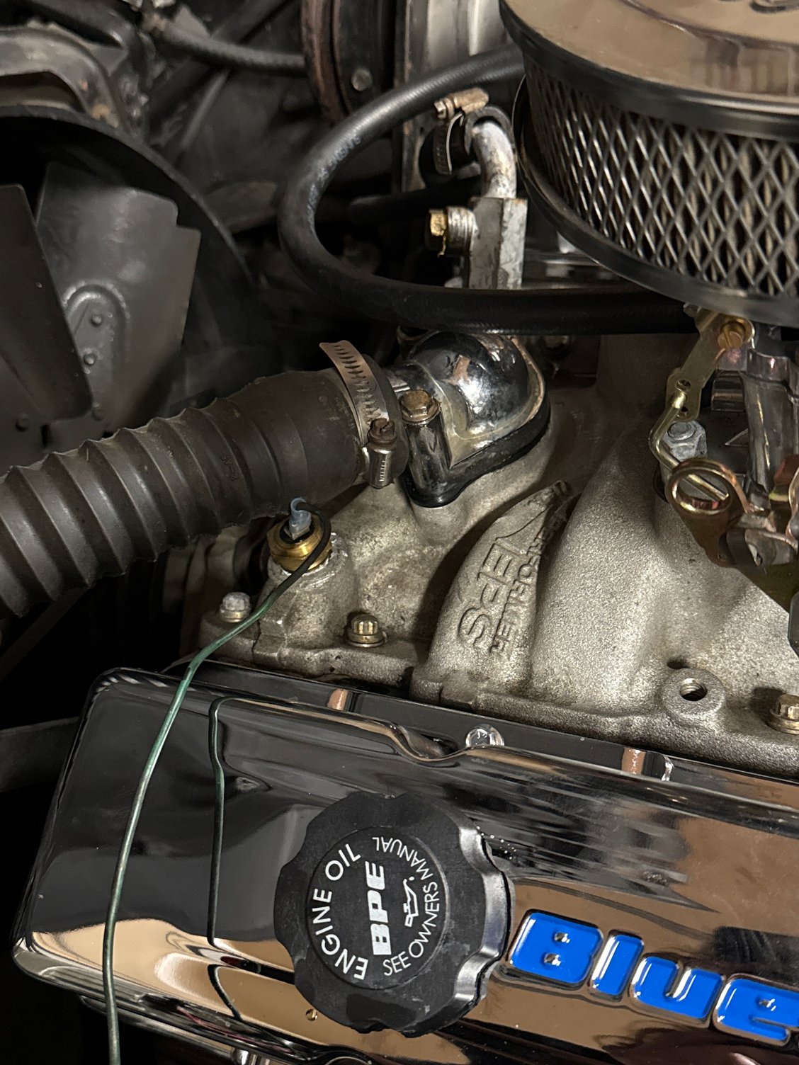

new update. I’ve come to realize that it must be an electrical issue. I understand that the water temp sensor and gauge work based off resistance. And I have come to realize that even when the car is off with the ignition in the on position the temp gauge starts climbing. I figure that somewhere in the electrical is an issue that is drawing power on the same circuit? I’m not really sure.

I suggest starting a new thread with the subject: "troubleshooting a '75 temp gauge"
That will get new attention to helping solve the problem.
So now you don't know that it's NOT overheating.
You should still get a temp gun, and check it out. It's a really handy diagnostic tool.

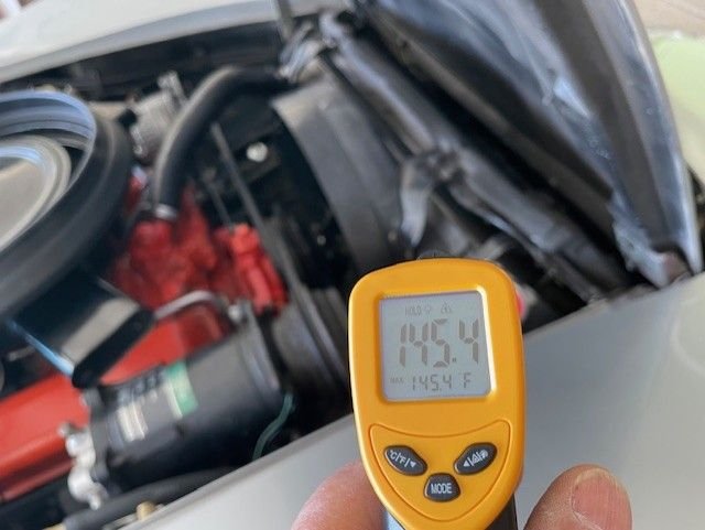

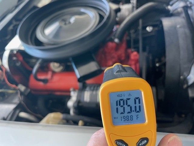

Old Jul 22, 2025 | 10:24 AM
Zanny1's Avatar
Zanny1
Joined: May 2019
Posts: 560
Likes: 261
From: Fountain Hills (Phoenix) AZ
Radiator measurement
Thermostat housing
70 MPH reading
Cheap Amazon IR gun readings.
1975 L48.
Hot day (105*) here in Phoenix, Arizona.
Have you flushed and drained the system to be sure no blockage occurs after running the motor? When I bought my car six months ago, the PO had mixed Dex-cool and Prestone 50/50 mix together, due to several leaks in the heater hoses. It took 2 flushes to get the "snot" out of the system.
I disconnected the heater hoses and plugged the inlet outlet connections for them. No need for a heater here.
Suspect an electrical problem somewhere. Hope it isn't the gauge.... PITA to remove. Sounds like your electrical connection to the sender is grounding after a few minutes.
