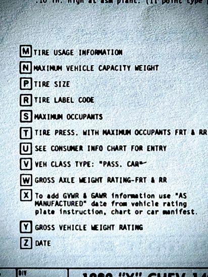

Below are the pages from the 1982 Assembly Manual showing the placement of the two labels, and the key showing exactly what info was to be typed on the labels. To correctly fill out the labels, besides the VIN you need to know the original tire size, build date, vehicle's gross weight and individual front and rear weights in both pounds and kilograms, the vehicle max load capacity, cold pressures for the front and rear tires and the spare, and additional information I forget at the moment but that I might be able to get off the labels on my 81 later (the 81 label is the same). The tough thing about accurately filling out the labels is knowing the GVW and the individual front and rear weights, as well as the max load. You may be able to get some if not all the info needed for the label by ordering a copy of your car's build sheet from the National Corvette Museum.

This is the key describing what goes into some of the positions.

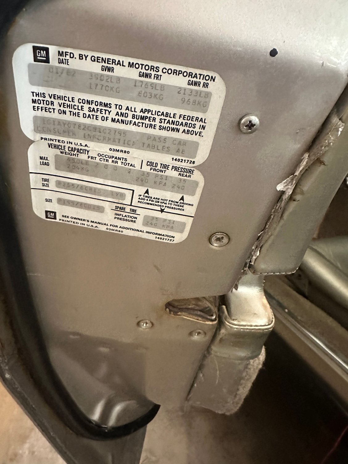

Here is a picture of the labels from my 82CE. Don't get discouraged. Tackle one problem at time.
