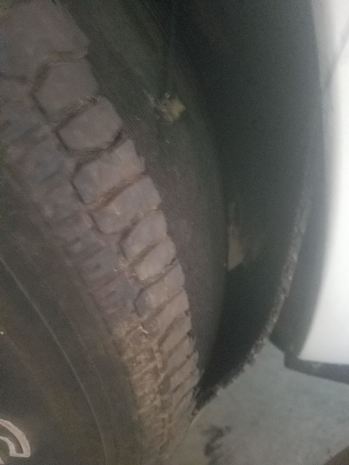

As others have said, its a risk. Pic is of an old tire I had used as a roller inside my shop that blew out just sitting there.... can't imagine the damage that would have occurred had the car been driving.
Bad example, this tire looks extremely dry rotted & clearly SHOT. None the less, you deserve what you get if you were driving on a tire in this condition. I'm not there, but I can see the cracks & it looks like it's as hard as a rock.
Glad it WAS PARKED !!!
