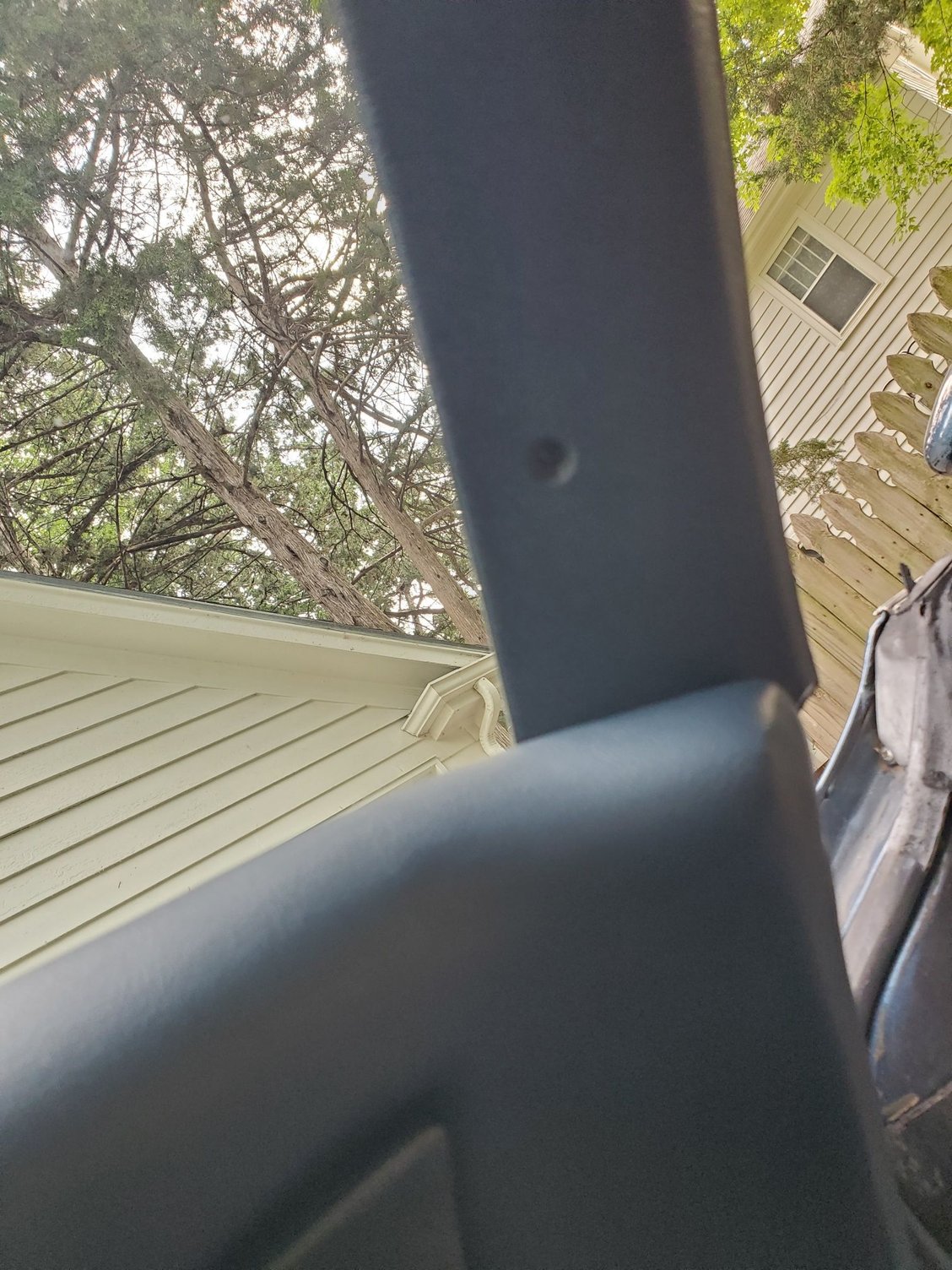

I seem to be missing all 4 of my inside windshield pillar trim screws, does anybody know what size they are? Thanks

#8 oval head sheet metal screw with a cone washer 3/4" long +/-. Some years painted other years silver chrome colored.
Agree easiest to get the interior screw kit.

The trim washers were usually only used when a screw was going through soft vinyl or padded vinyl panels and parts. From the pictures it looks like the OP has a 78-82 which had hard molded plastic a-pillar trim that used screws without washers.
Also, GM rarely took the time to paint screws. Usually the only time screws were painted was when they were installed in a part before the part was painted. In the 60's, just about every visible interior screw was chromed, but in the 70's Chevrolet started to use both chromed and black screws depending on the color of the interior. Generally, chromed screws were used in light colored interiors, so door panels, dash, pillar moldings etc in a white or tan interior would have used chromed screws. Dark interiors like black, dark blue, red, etc usually used black screws to install interior parts. Obviously, things that were black like console shift plates and center gauge clusters used black screws.

Thanks, it's an 80. I think maybe paint the heads black since dark blue interior.
