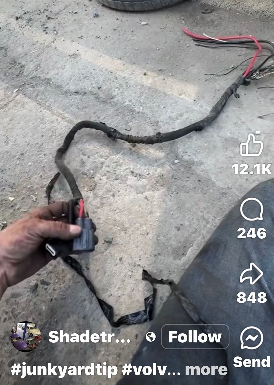

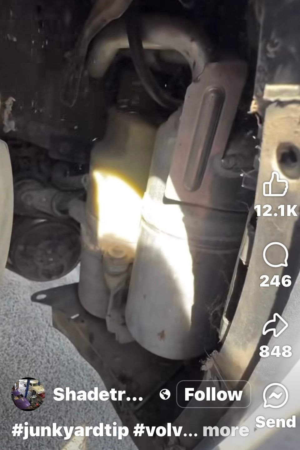

I came across this video on FB, and on one hand it sounds sacrilegious to put one in a C3….but on the other hand, it’s got some wheels turning in my otherwise quiet brain housing group.
https://www.facebook.com/share/r/1KYT2VKSCr/?mibextid=wwXIfr
I posted a video above, which will not link up for some reason, but you can copy and paste the link.
But just in case, here’s the Cliff Notes version:

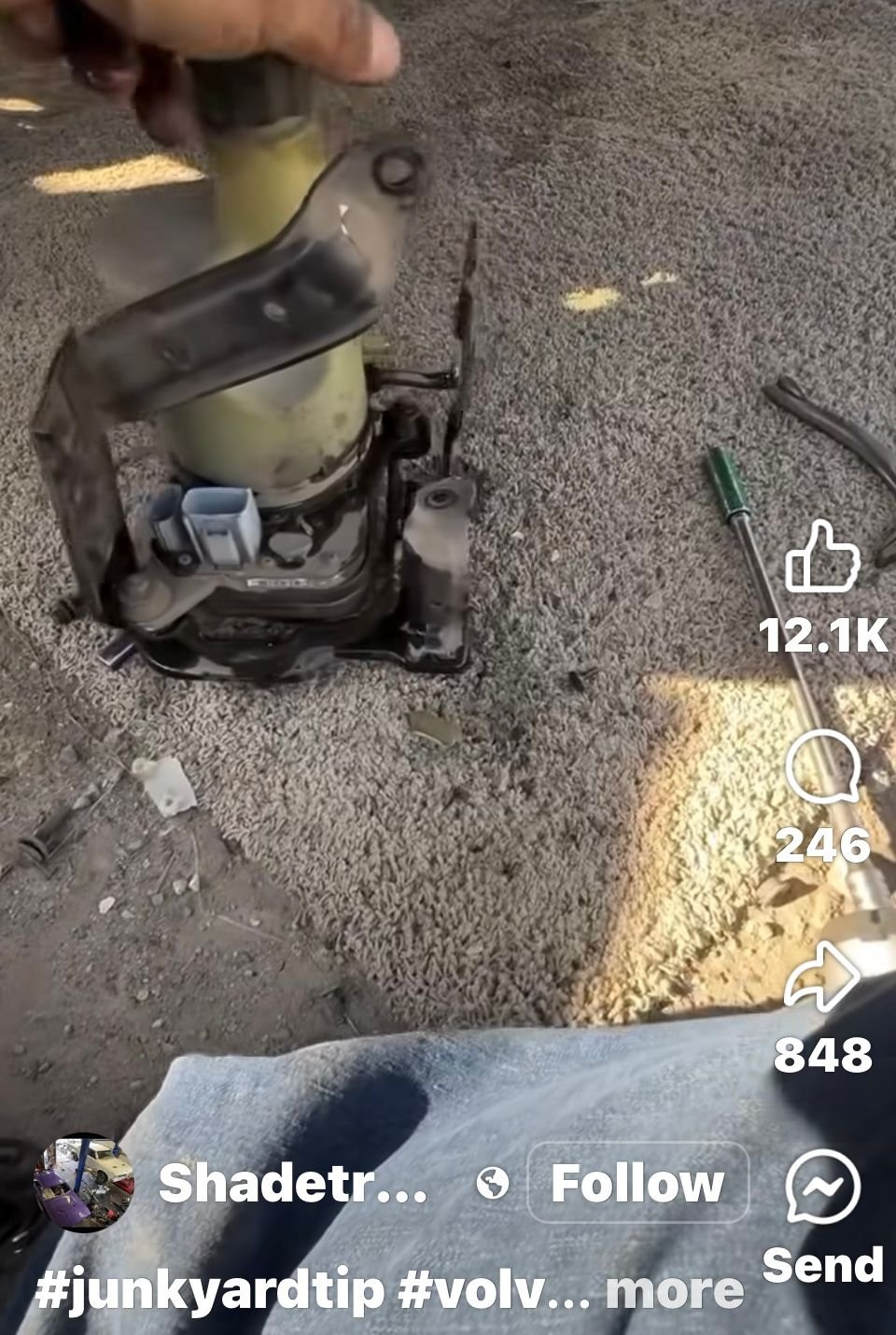

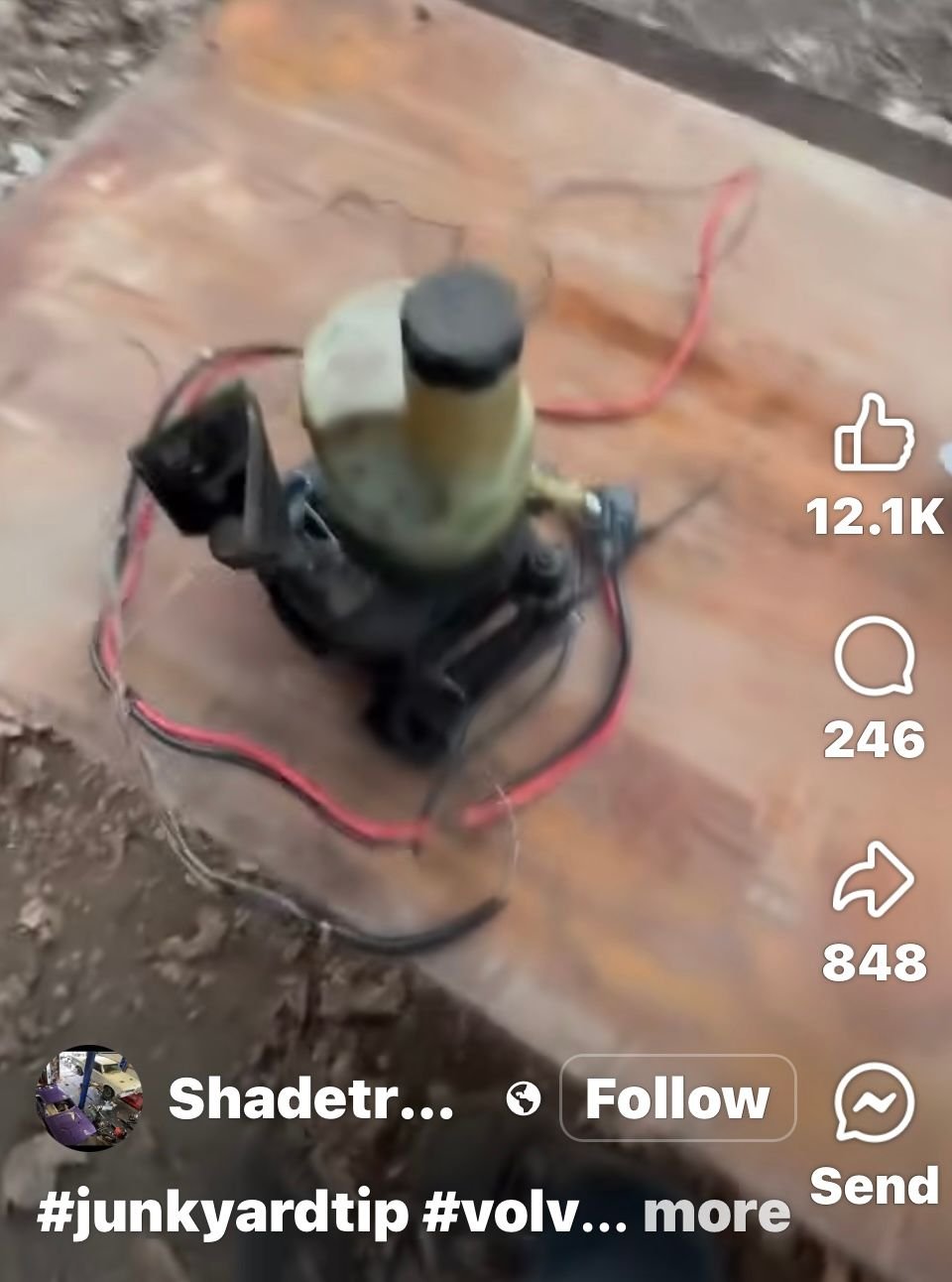

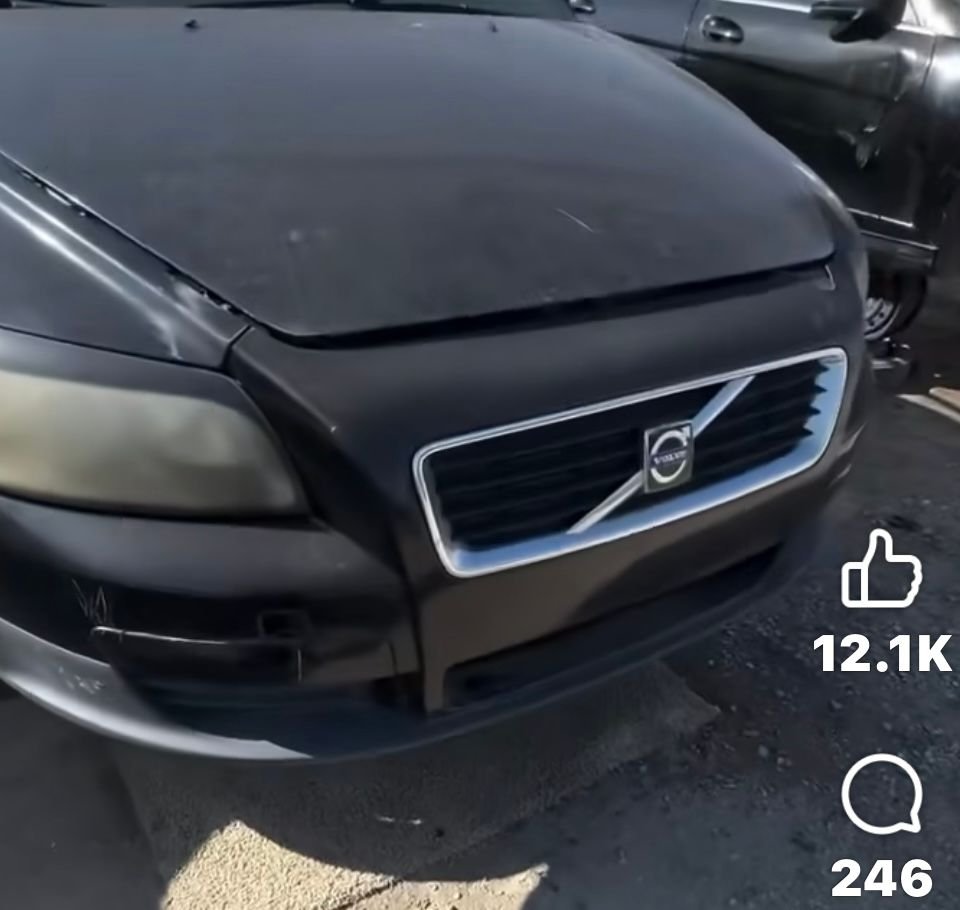

Appears to be an early to mid 2000’s Volvo electric power steering pump.
The guy in the video showed how to remove it, including a portion of the donor vehicle’s wire harness that supplies power to the pump.
States that this standalone electric PS pump can take the place of a serpentine style PS pump.
It piqued my interest as to whether or not it would be a viable option in our C3’s, particularly my 74, which is FAR from stock.
So here’s my questions:
Would this be a viable option to eliminate the alternator vs PS pump cap issue?
Will it work in unison with a Borgeson steering box?
Has anyone heard of or tried this?
Thank you for your thoughts!

Upon further research, I understand it would still need a CAN controller or potentiometer.
So, to answer my own question, no, it will not work as a stand-alone unit.
I’ll keep my belt driven PS pump.

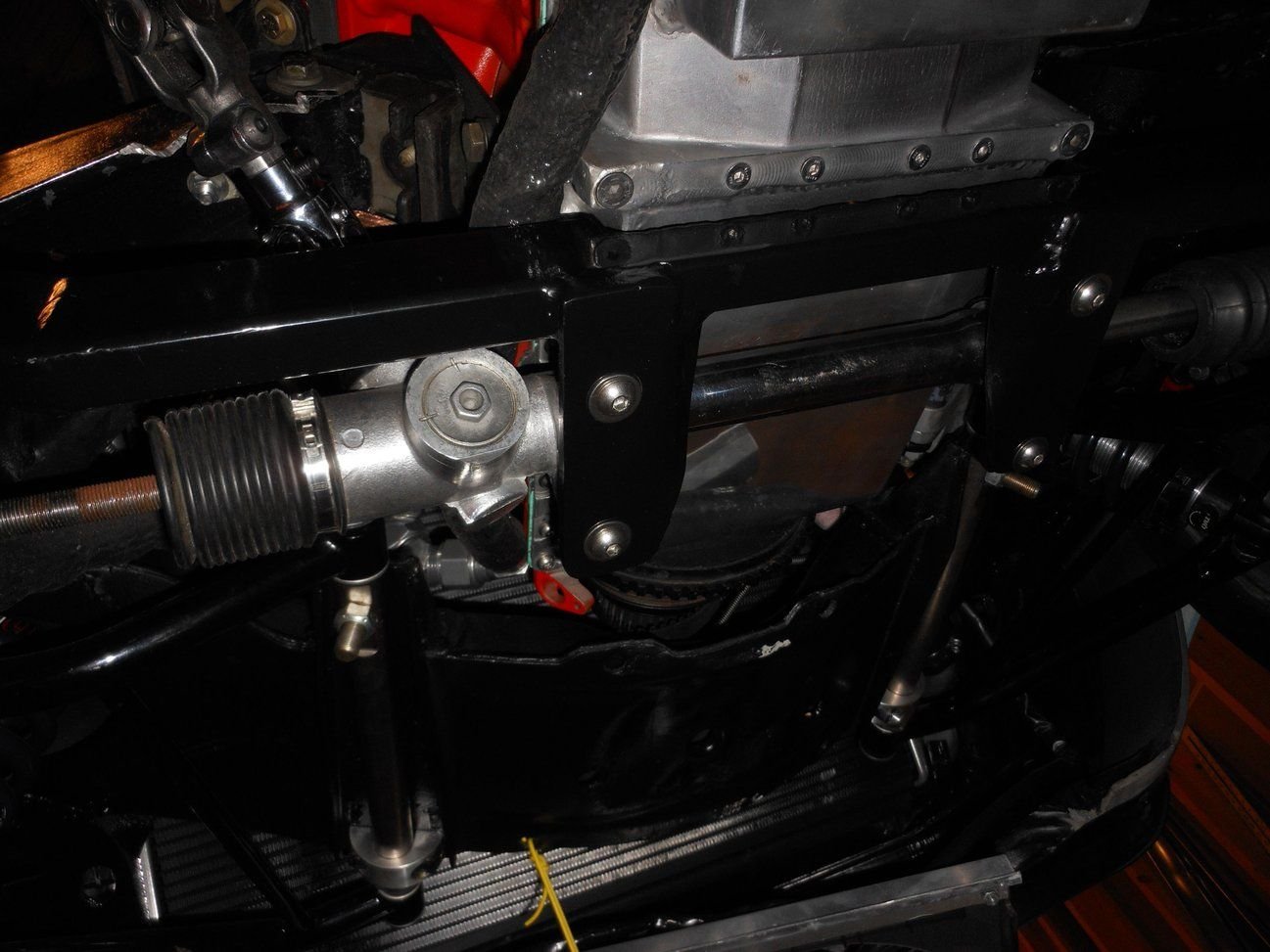

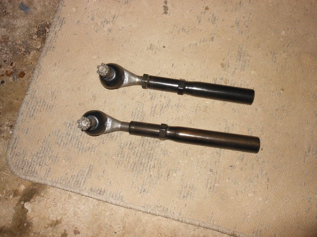

I modded the cradle- lowered the rack and mounts- made my own tie rod ends- all to minimize bump steer. There is no rag joint- so i used a "telescoping" shaft.
My 73 has factory power steering- and there is no comparison between the two. Feel is incredible- in the parking lot and driving down the road. You do not need a potentiometer ( like the Saturn motor) to adjust the input vs output- it does it with an internal torque sensor.
