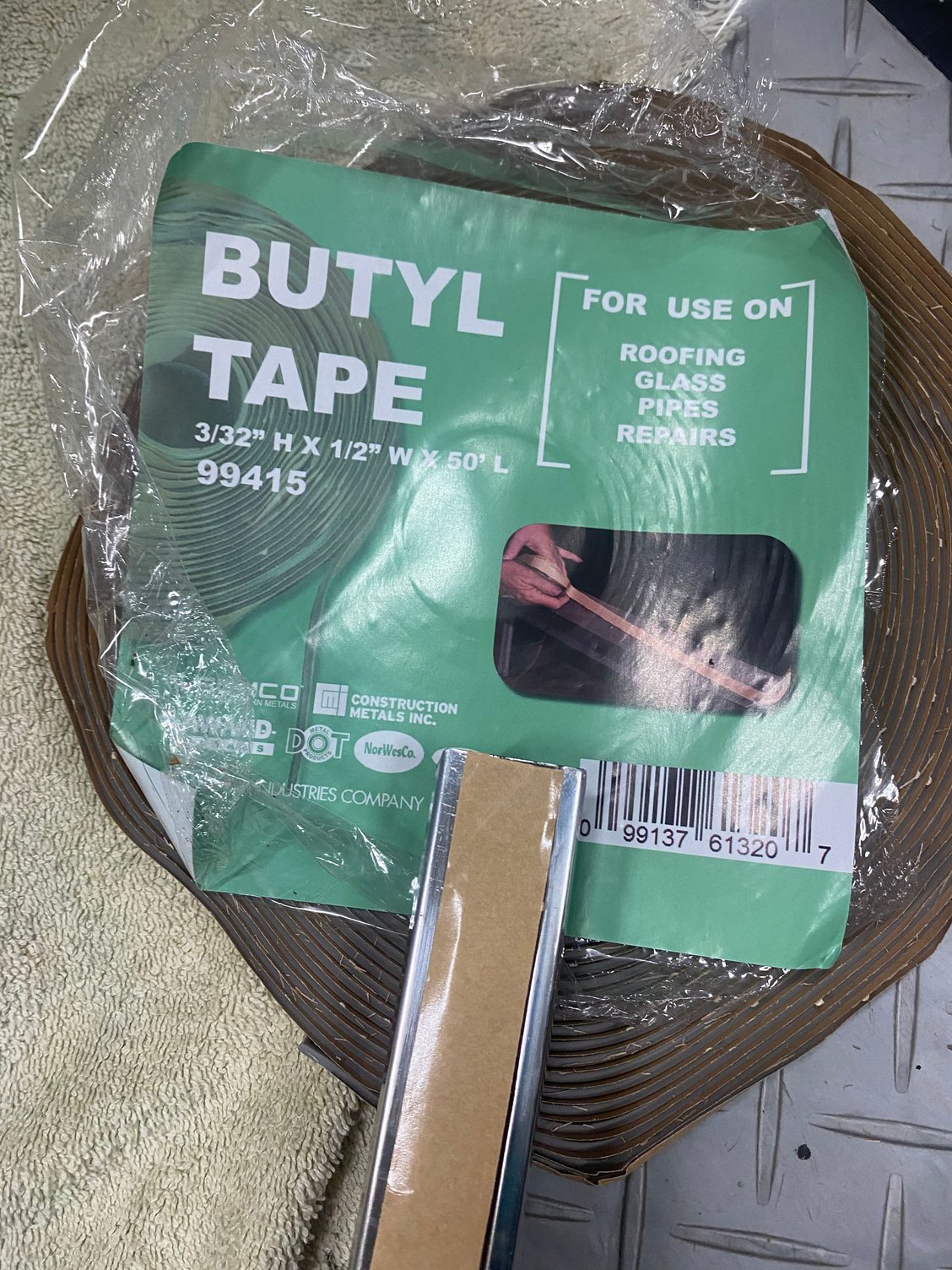

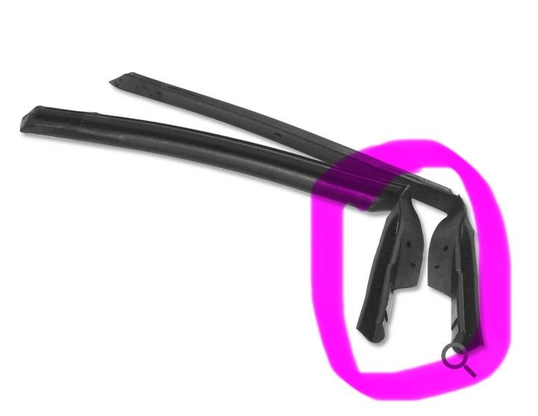

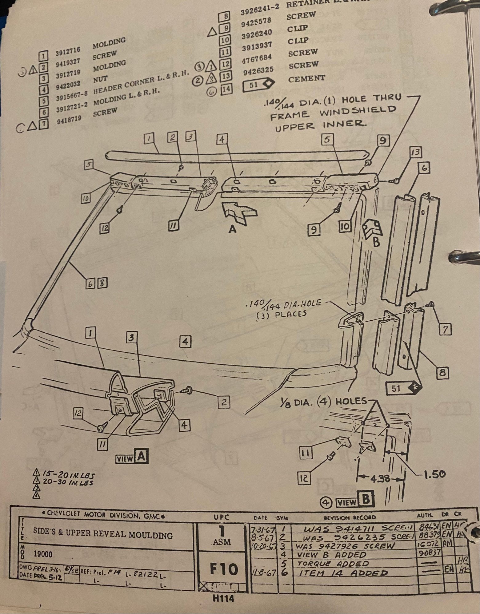

I’m using the original trim and weatherstrip retainer piece so fitment seems to be good. However, the weatherstrip I ordered is not fitting great. Posting up pictures and hoping others have information that may be helpful. The AIM, in this instance like others hasn’t been terribly helpful either.

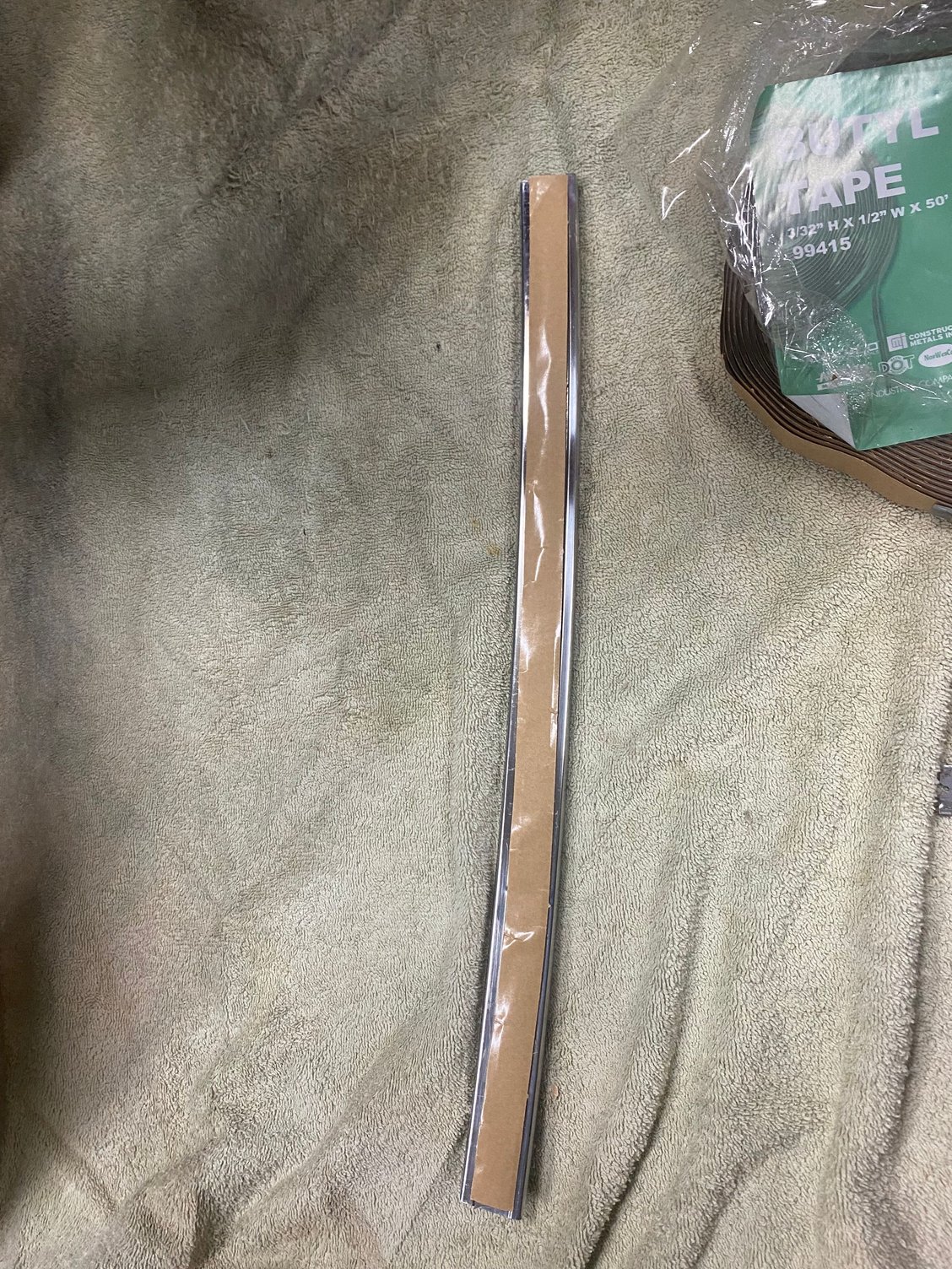

On someone else’s recommendation, I did go to the local hardware store and get some butyl tape which fit perfectly into the retainer to provide waterproofing between the two metal pieces.

AIM does not indicate that the upper weatherstripping has any screws, just the molding and the retainer.

Under $7 and fit like a glove into the channel between the retainer and a pillar windshield molding.
The extension part of the replacement weatherstripping is what I’m struggling to determine placement of.

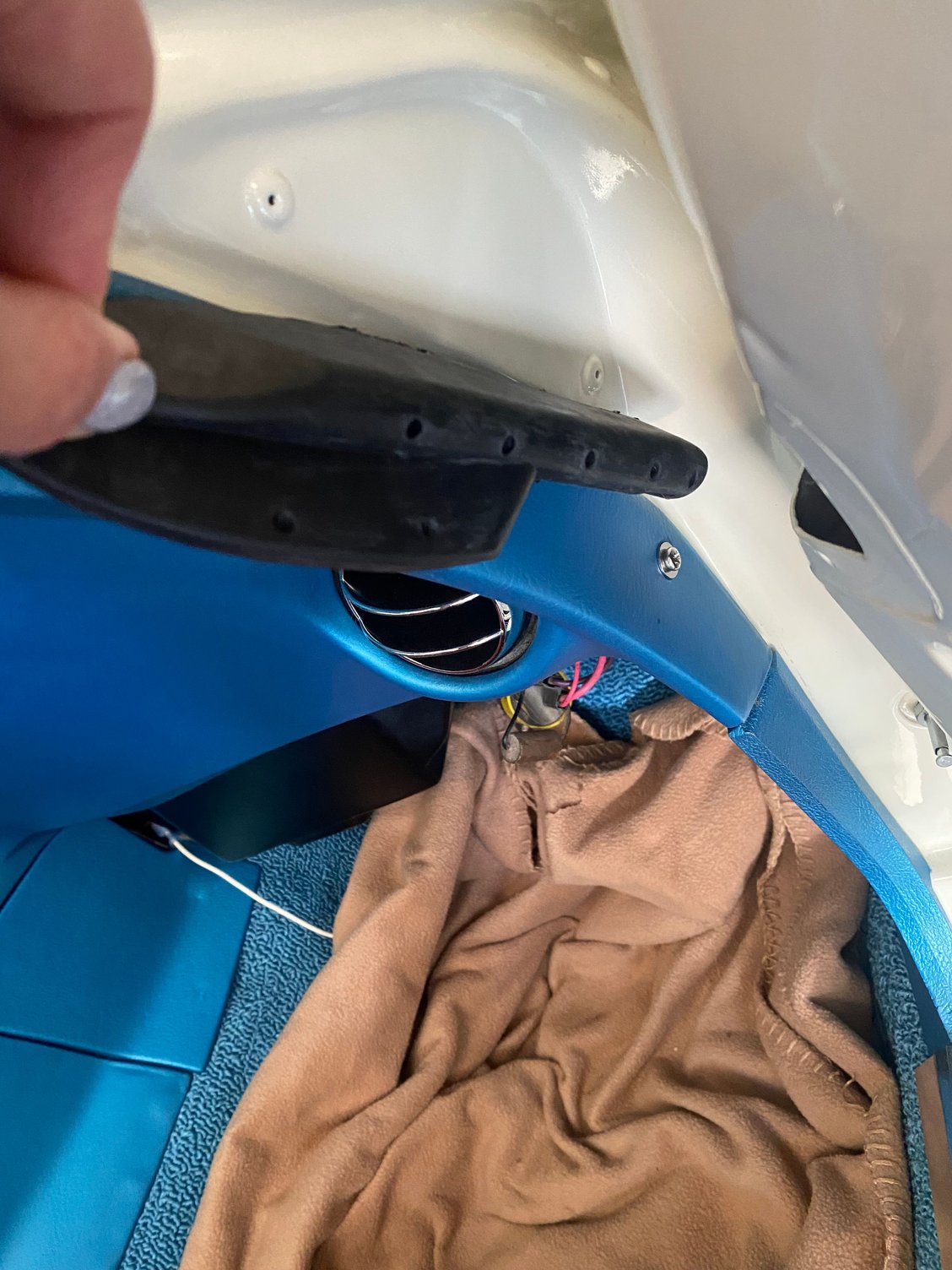

this is how it is on my 68. I dont have any issues with it, and I didnt install it.
great picture. Thank you.
