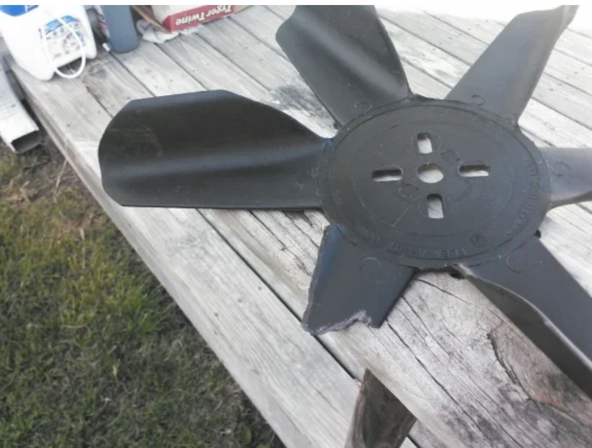

Not true, the whole point of the clutch is that it disengages when the air moving through the radiator from the car moving is ample enough to cool the engine. They’ve been used on millions of different vehicles, including high performance ones well into the 21st century. After which electric fans became commonplace.
Flex fans on the other hand…

Engine Masters did an episode on fans a while back. Whether you like the show or not, it was still an interesting episode (S2E2).
They tested hp effect. They did not specifically test the effect on cooling ability; however, I would think drain on hp would correlate to movement of air.
The factory, rigid mount steel blade and plastic/fiberglass flex fan drained the most hp which indicates, to me, they moved most air.
The factory clutch fan drew down a little less hp.
The aluminum flex fan pulled down very little hp. Indicates the flex doesn’t move as much air.
None of the three were supportive of the flex fans.

Car Craft May 2000, page 50 and 51. Dyno test. Max power:
alternator, no fan 496 hp
plastic flexfan 460 hp
low-profile flexfan 466 hp
hi-perf flexfan 476 hp
6-blade rigid fan 449 hp
4-blade ridid fan 473 hp
HD thermal clutch fan 476 hp
thermal clutch fan 487 hp
non-thermal clutch fan 485 hp
alternator, electric fan 494 hp
