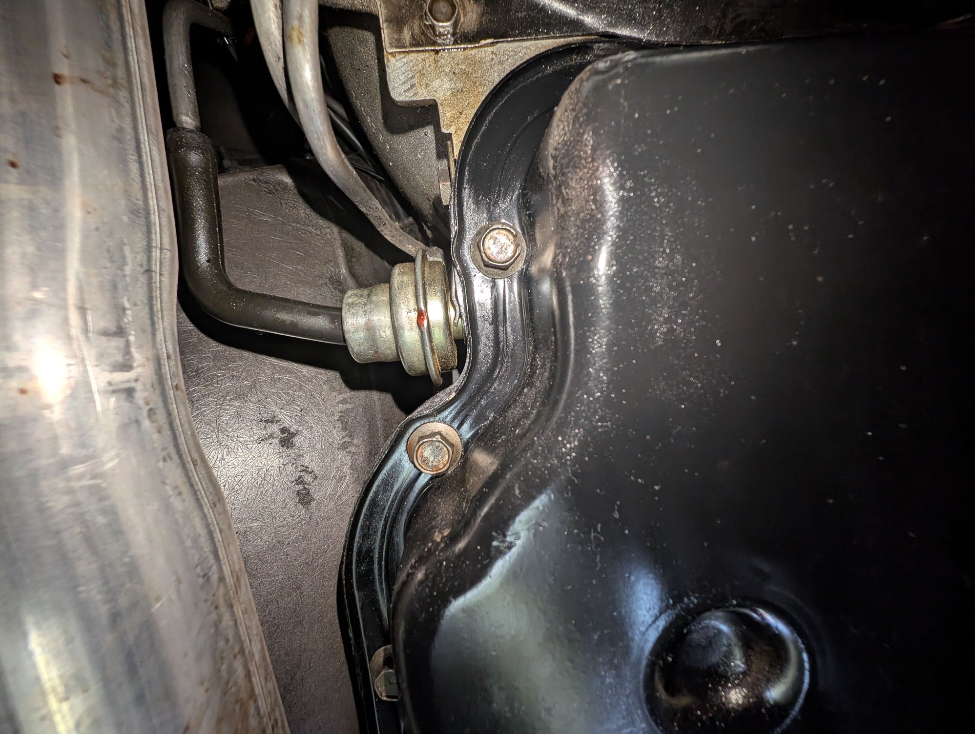

Next up: transmission leak. After cleaning everything up and waiting a few days I’m fairly confident it’s coming from the vacuum modulator or possibly the O-ring.

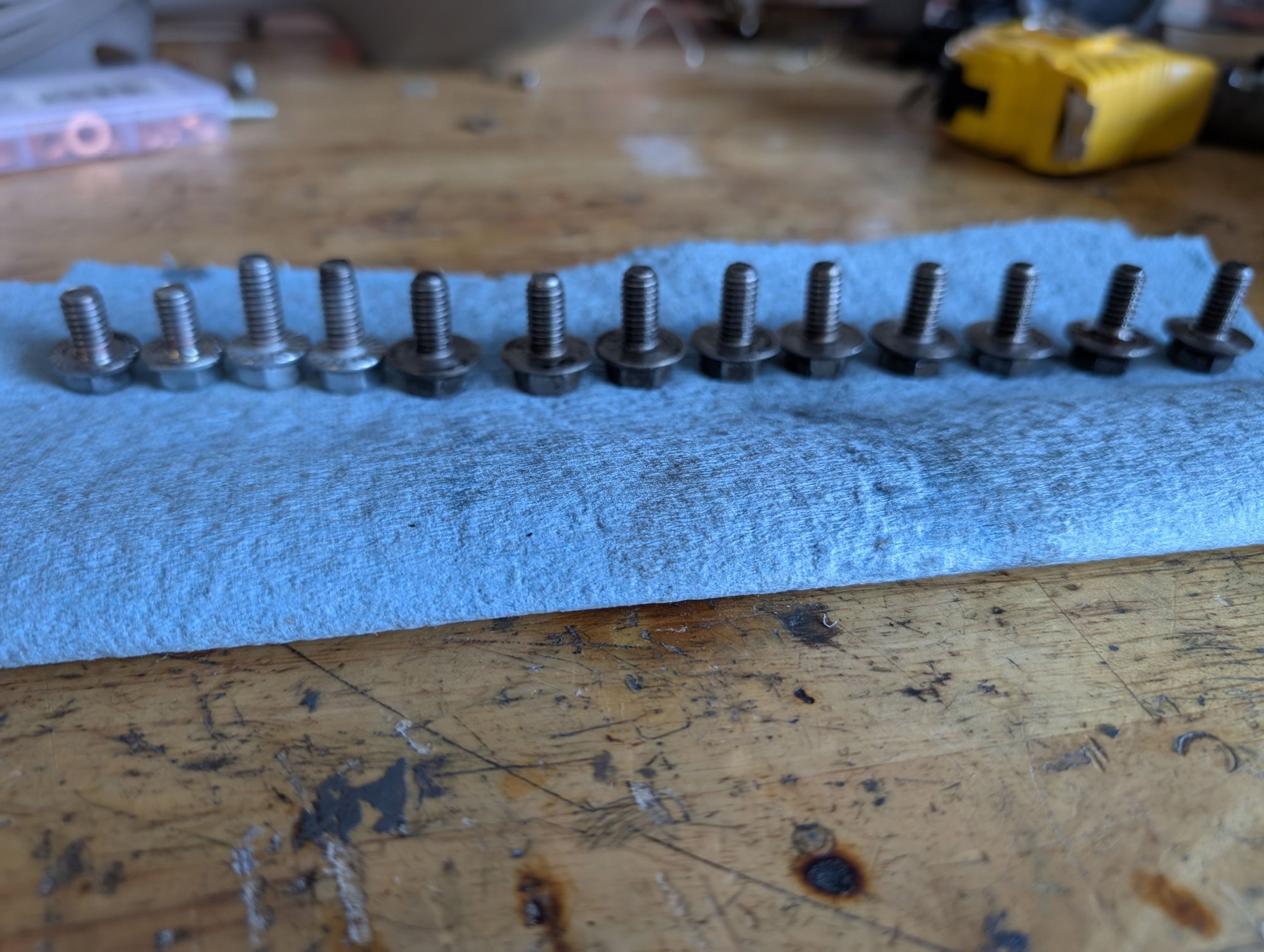

When I pulled the pan, I noticed something odd two of the bolts are noticeably smaller. Some of the hardware also looks like it’s been replaced at some point.
My question:
Do those smaller bolts belong in a specific location, or were they just replaced with whatever was handy? If they’re incorrect, should I replace them all with the proper size?

They should all be the same size 5/16-18x3/4

As a suggestion, I would replace the vacuum module.
I had one fail on me and the engine started sucking transmission fluid into the intake.
The engine smoked like crazy and pulled about a quart of transmission fluid out before I could get home.
Back then it was a $10.00 part and only took ten minutes to replace.
I did, it came in a nice kit
