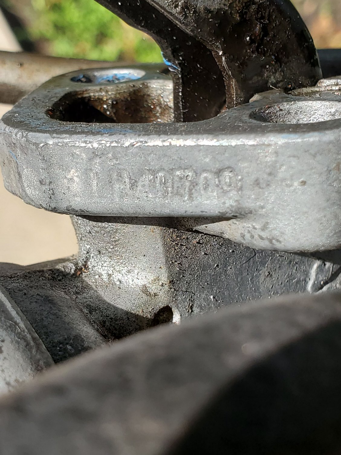

Another forum member posted a WTB ad looking for a specific # AC fuel pump, so I went to look at mine. It says LH 40709 on it. Came off my 1971 LT1. Since the car sat for 10 years, and I don’t care about originality, I plan to put a new pump in. What I’m wondering is if the “L” is specific to the LT1 and if so, what is different about it? What I mean is, if I just buy a pump for a standard 350 would it work or was this model made to maybe pump a little more than say a base 350 would have in 1971? I want to know if I buy a fuel pump that says it works on a 1971 350 would I be good to go?

No, the L isn't referring to an LT-1. Current belief is that crimped-style pumps have a 2-letter code before the pump number (40709) where the first letter is the month and second letter the year. The months begin in January with A, Feb = B, March = C, etc.; the years are 1966=F, '67=G, '68=H, '69=I, '70=J. For '71, the coding changed to a Julian and year code. This pump should be December '68.
Not just any '71 SB spec'd pump will work for you. The differences between the various pumps are the inlet/outlet locations and connection angles and whether there is a return port or not. If your pump above aligns everything as needed, match up a new pump to do the same. The pumping volume needed is basically the same for all engines, ~5-7psi.
New pumps seem to put out a lot more than this (~10-12psi) so be aware of any over-pressure symptoms after installation. I put a new Carter on my 427/Holley and the carb leaked at the pressed plug where the fuel inlet is located. Had no leaks before using the original pump, so I believe this pump is over-pressurizing the fuel delivery.

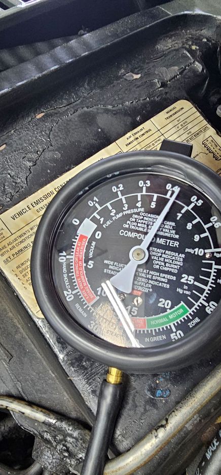

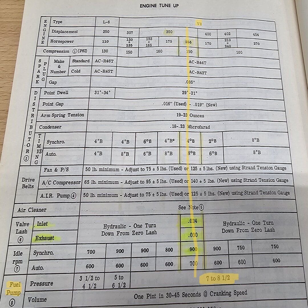

72 LT1 should be very similar to 71. I get 6psi dead headed. I dont run a regulator and have zero problems.

From the service manual
