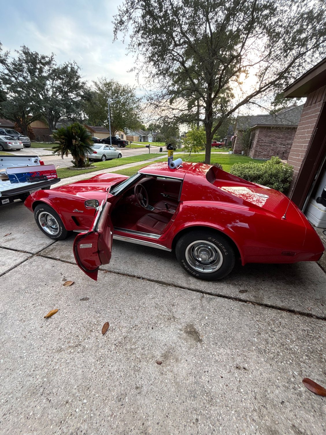

Hey y’all, I just bought my dream car, a 1976 corvette. Automatic transmission, power steering, a/c, etc.
However, there are a few areas of concern Id like to get to and I figured there’s no better place than those who have a c3 rather than a newer car with different hardware
Motor and transmission are great save for the transmission pan, which is probably the easiest fix I’ll do on the car. The vehicle came with a set of new bushings that I’m going to install first and foremost.
Areas of concern:
-When driving slow, there is a clicking noise from passenger side front that sounds like two legos clicking one another (maybe a new driveshaft is needed, perhaps just bushings and bearings??) the sound goes away as speed increases
-When going down a steep hill, the car likes to pull to the right and there is a clacking sound accompanied by a shift felt in the cabin but i can tell it isn’t transmission related
I was fully aware I’d need to put some work into the car when I bought it but that’s no issue. I have experience doing suspension work on my 2024 maverick, used to do my own maintenance when I had a Toyota, and i have all the necessary tools to do the work myself.
What should I focus on switching out first?
suspension related items?
driveshaft/axle related items?
etc
Thanks in advance and God Bless!
