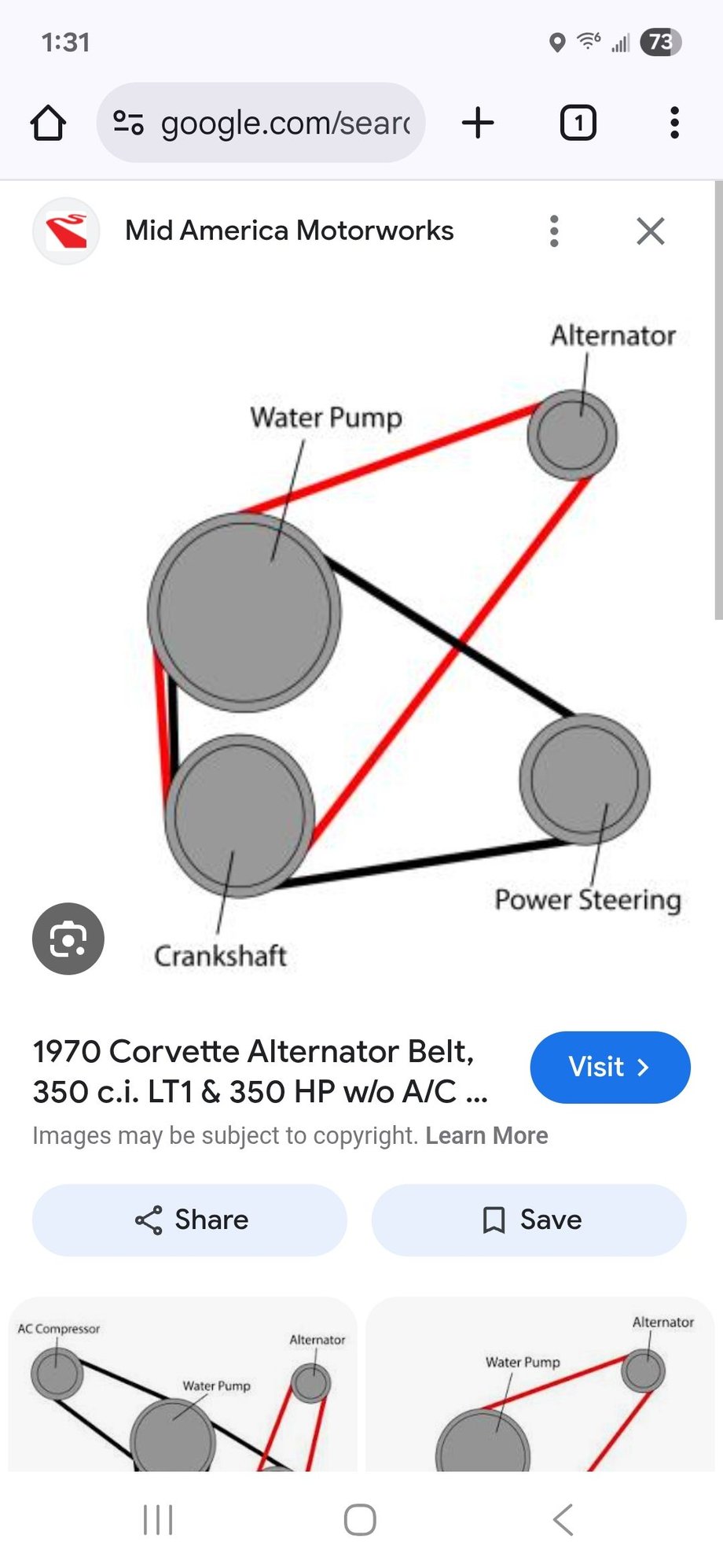

Perhaps a silly question, i am ordering a power steering belt, I have two options... 1. I can run a 35" belt around the crank pulley and PS pump pulley or 2. I can run a 44" belt around the crank pulley, water pump pulley and PS pump pulley.
I find both configurations on line and both belts options available... is there any advantage/disadvantage to either routing?

On my 68 I ran the short belt but only because my other pulley grooves were taken up with a/c and alternator. Haven't had an squealing or other problems (well, since I went to BRAND Name belts) but I would have run the long belt if I had a groove available.....but that's when I added a/c I was out of grooves and I was making adaptations to make things work.

Thanks... I do have the groove available on both the crank and water pump... I will likely just run the longer one around all.

If you run the longer belt all the way around, you may have issues with PS pump cap / dipstick removal.
A longer belt really isn't needed. And the more belts on the waterpump, the more strain on the W.P. bearing.

good thinking on the extra tension to water pump... thank you

The shorter P/S has more belt to pulley contact area.

thank you... I did order the shorter one.
