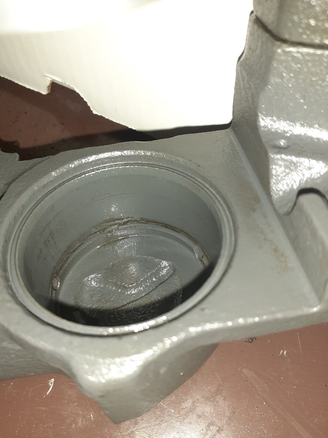

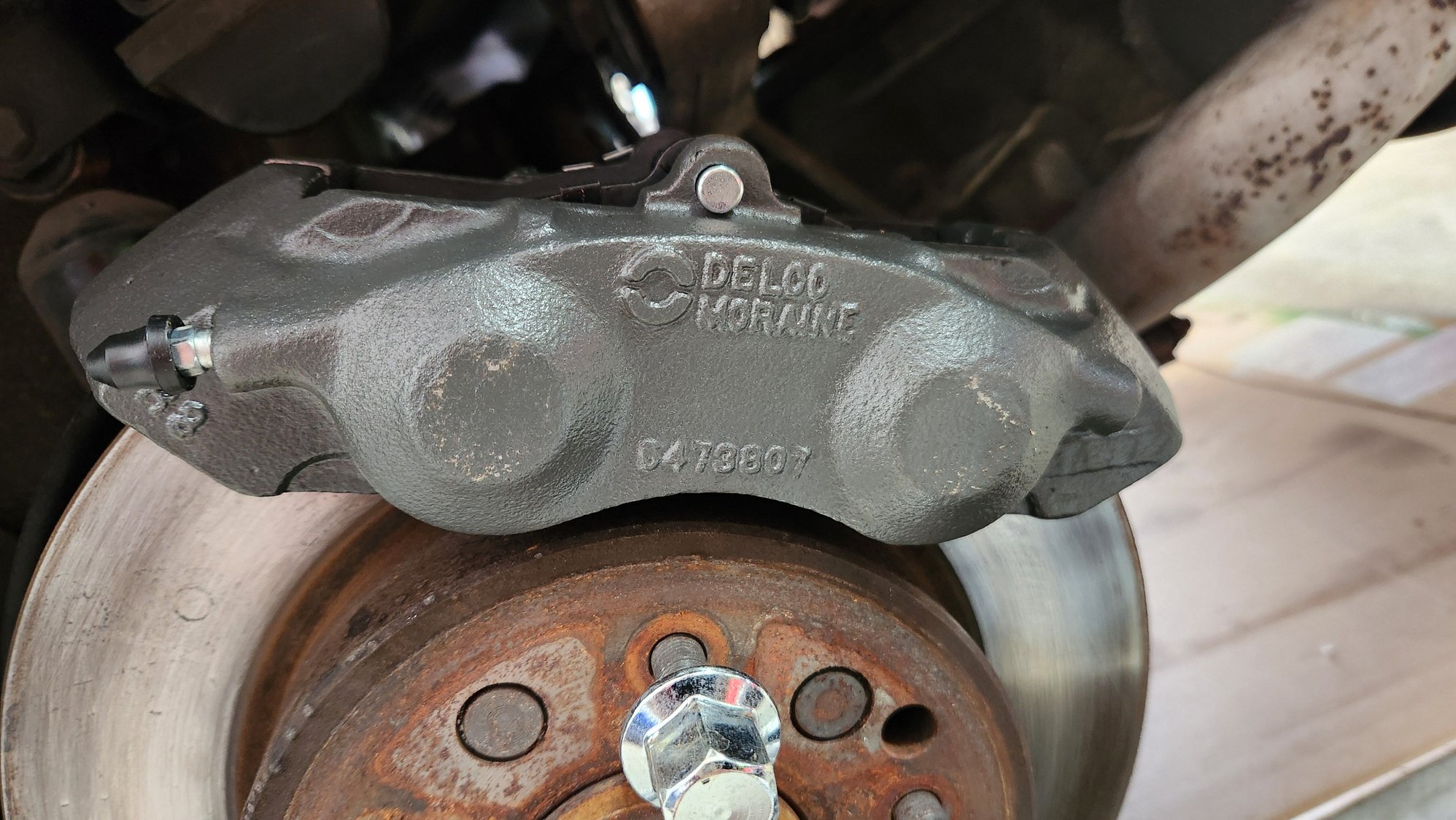

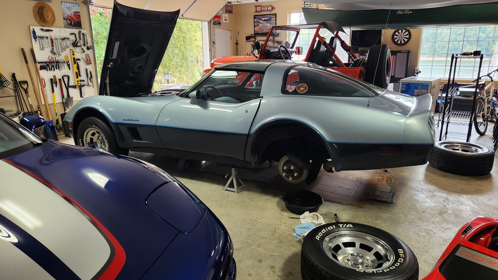

Like most of y'all, I'm doing my part to keep the old girl on the road. Arguably, if I drove her more often this wouldn't be a problem.
I replaced the brake calipers with parts from AutoZone when I purchased her in 2003. They have the lifetime warranty and, due to a small leak on the driver's rear, I picked up this remanufactured Delco Moraine at my local AZ yesterday; $0 cost to me - 22 years later. Replacing the rear pads at no cost too. Total job is setting me back $10 for brake fluid and to be honest, I'm having fun!

Autozone calipers are junk since they started to rebuild them in Mexico.
They sandblast and paint the bores. They will always leak because all of the pits from the sandblasting.

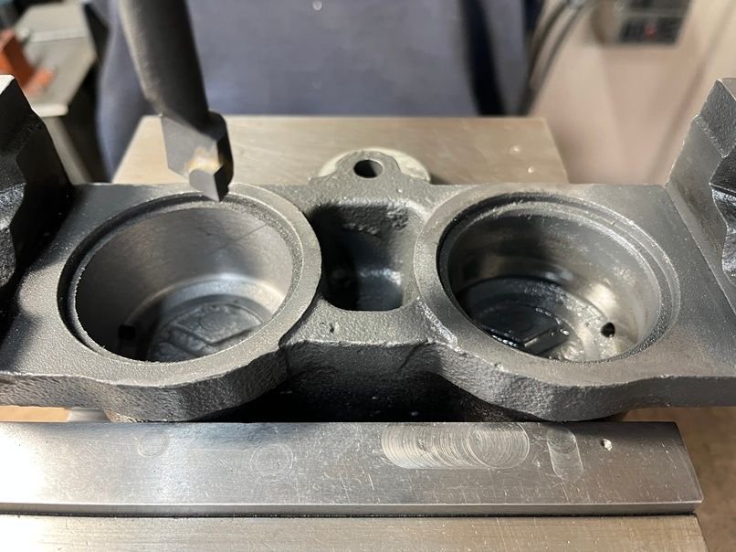

I went through 3 of them on the drivers side. Gouged and not even smooth enough to seal. I bored them and sleeved them. No issues now.

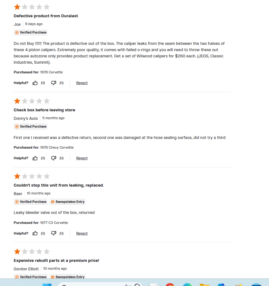

Read the reviews if you don't believe me. Brakes are the last place you want defective parts.
