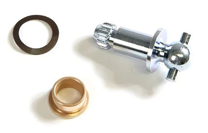

I have a window crank issue. When cranking the window up it will go up but eventually the crank starts “slipping” so to speak and I have to assist the window up with my hand as I crank. Before I tear everything apart does anyone know what parts I should grab that will fix this symptom?? Thanks so much !

Without taking it apart and looking at it, my best guess is that the piece that connects to the lift mechanism is probably worn out. When I took mine apart the pin in it was worn out and almost as sharp as a razor blade. It isn't expensive, when you get in there, I would lubricate anything that moves. If it hasn't been worked on before, the grease has probably turned hard. I almost had to chisel out some of the old grease to ensure everything moved easily. This part is what connects the window crank to the lift mechanism.

It could be that the gear is stripped.
Top Flight # 33645
https://www.topflightautomotive.com/...r-gear-manual/

It’s starts off good then starts slipping and can keep turning while it’s all the way up. It pops like it’s jumping teeth.

I’ll add these to the list of parts I need. It’ll be a long one !!
