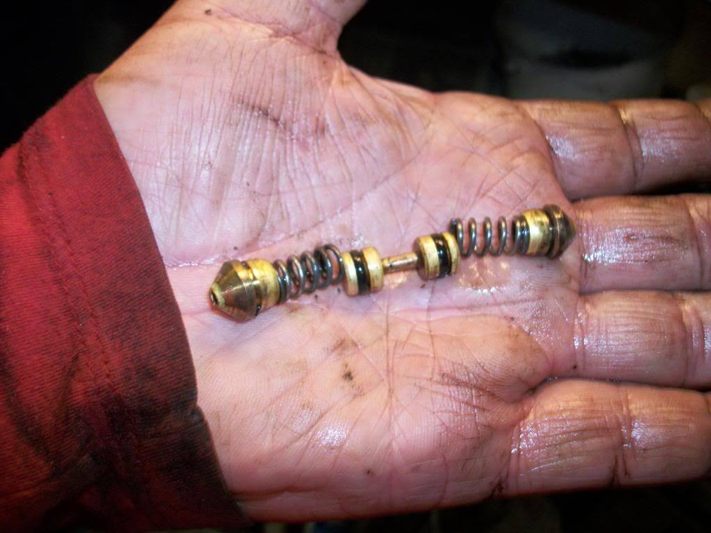

don't confuse the low-pressure switch with a prop valve
Sometimes the little double-ended piston in the center needs new o-rings.
My DIRECTIONAL/LOW PRESSURE SWITCH VALVE WAS CLOGGED WITH GUNK WHHEN i DISSASEMBLED IT...PIC SHOWS IT WIPED OFF A LITTLE.
