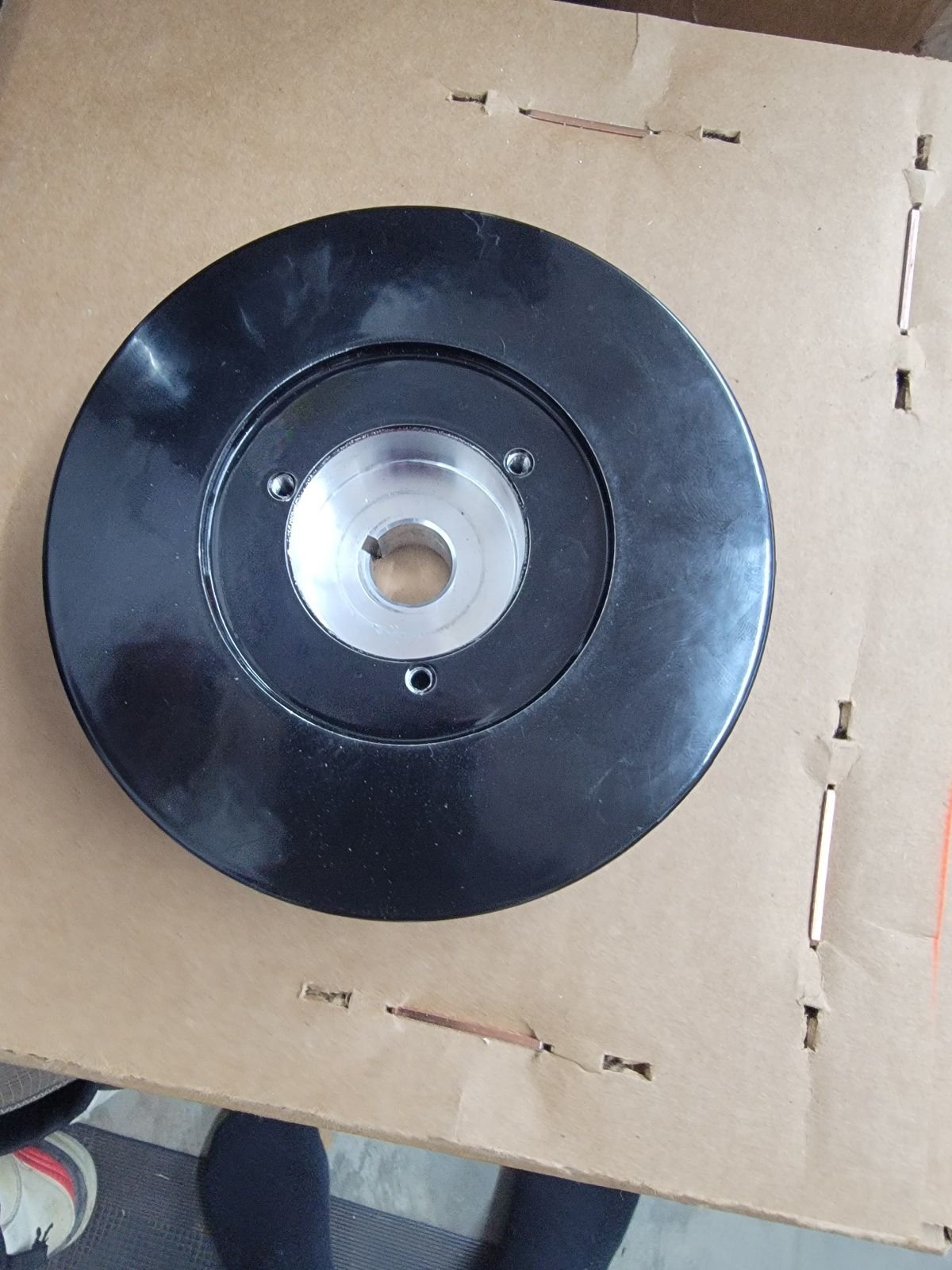

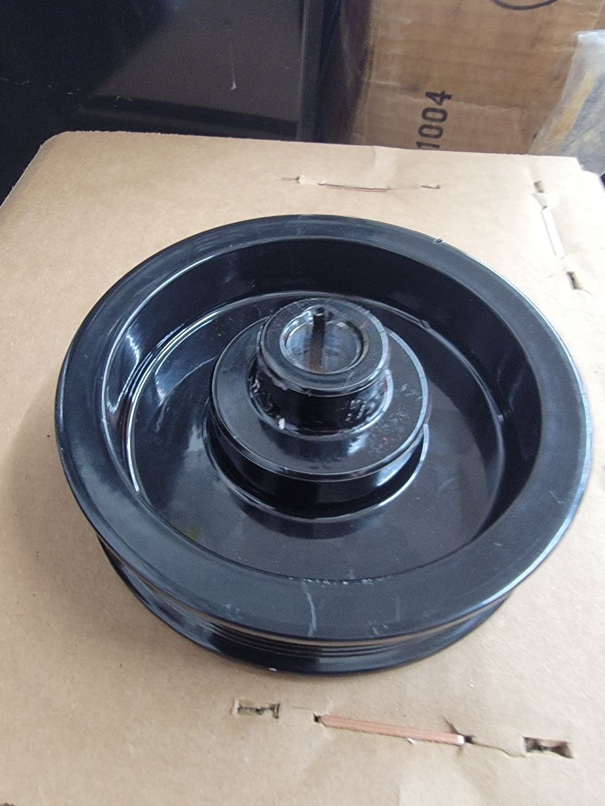

It's a pulley that came with a serpentine belt kit and it is too close to the cross member. It seems that it is the wrong kit entirely and I am trying to find a pulley with a smaller od so I don't have to take the entire kit off of the car. I can find one with either the correct bore or a smaller od but not both. My only other option is to replace the entire kit, which is probably what I should do.

I see - I believe we were of the assumption you were having problems with the GM parts.
What company is the supplier of the kit? That may help come up with solutions from others with the same kit. Perhaps post a couple photos of the pulley.

How much space are you needing to take up? I'm thinking maybe a strip of shim material inside the bore from key way edge to key way edge may work unless you want to go the full route my guy did to do my repair. Whatever shim thickness you use, remember that you're doubling up the correction - i.e., 0.001" is going to take up 0.002" of bore space.
