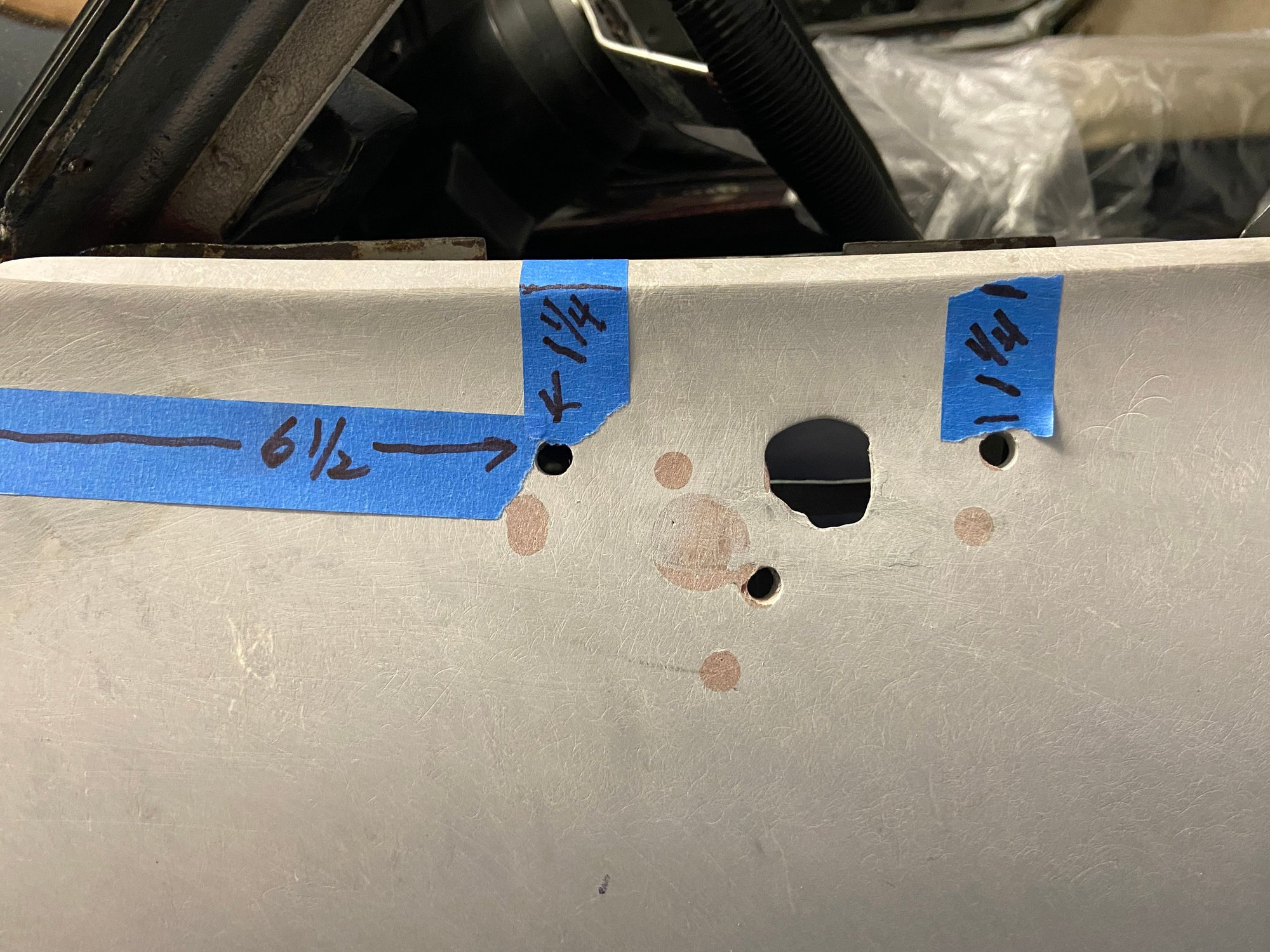

It just so happens that the car is apart waiting for paint and I am sitting herre waiting for a call, so here are the pics
On the driver door

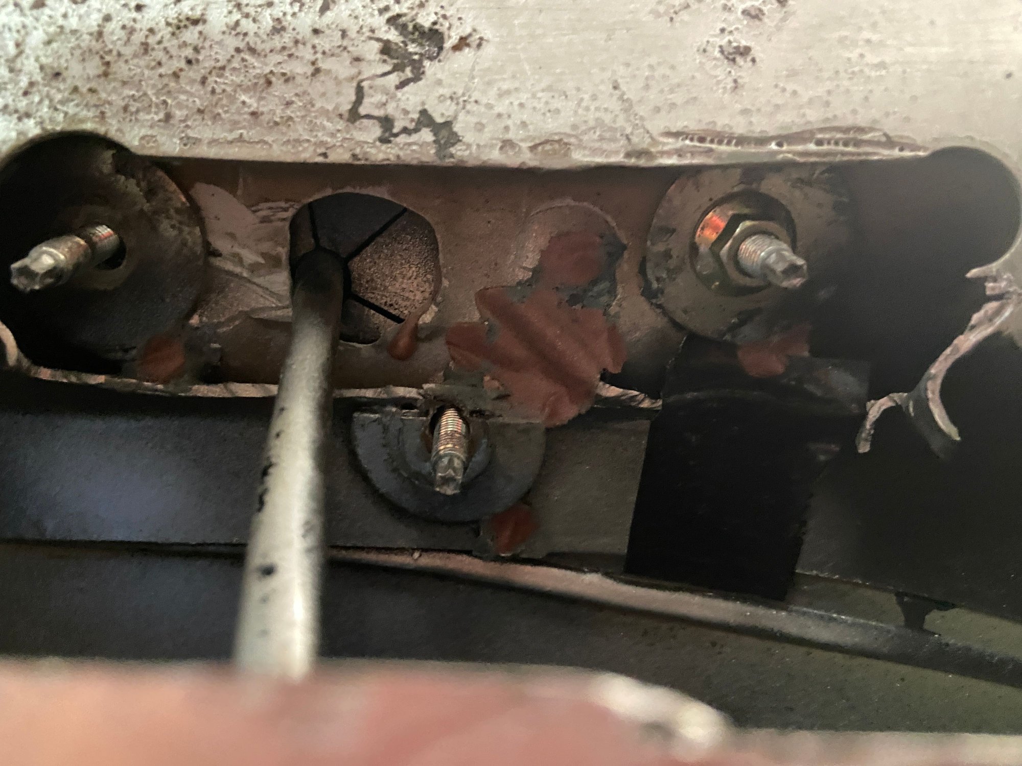

I had to cut away some of the metal to get the nuts threaded.  You can see the 3rd stud that misses the metal.  I just put a fender washer on it
Front stud 6 1/2
Front stud 6 1/2" from front of door, 1 1/4 down, second hole 1 1/4 down also

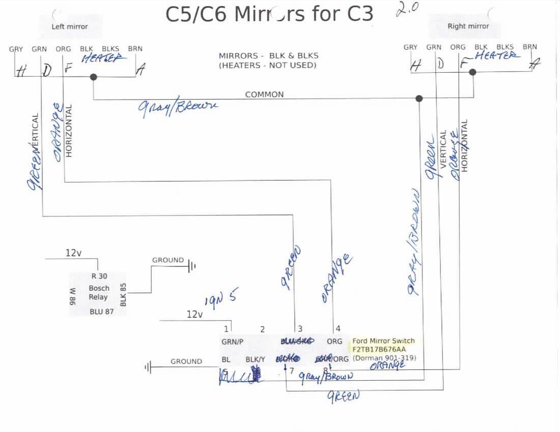

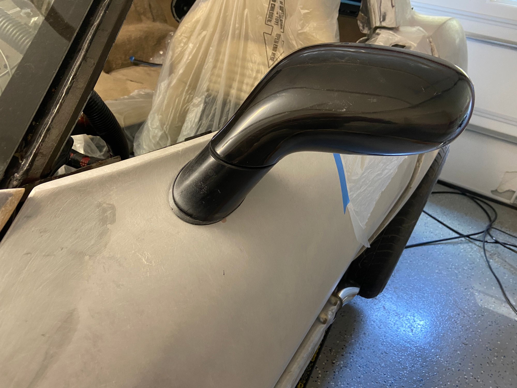

Just lay the gasket on top to get the third hole. As said, this was the hardest because none of the OEM holes lined up enough to place the mirror to make sure it was in the right place! The red marks are the filler in the the door from my first version, which didn't give me the rear view I wanted. . And here is the wiring
I don't know what switch you are going to use but someone graciously put a Ford mirror switch note on this diagram ( Can't recall where it came from). I was using a joystick and switch from a C4, which was another nightmare for my project. I hope this helps.
