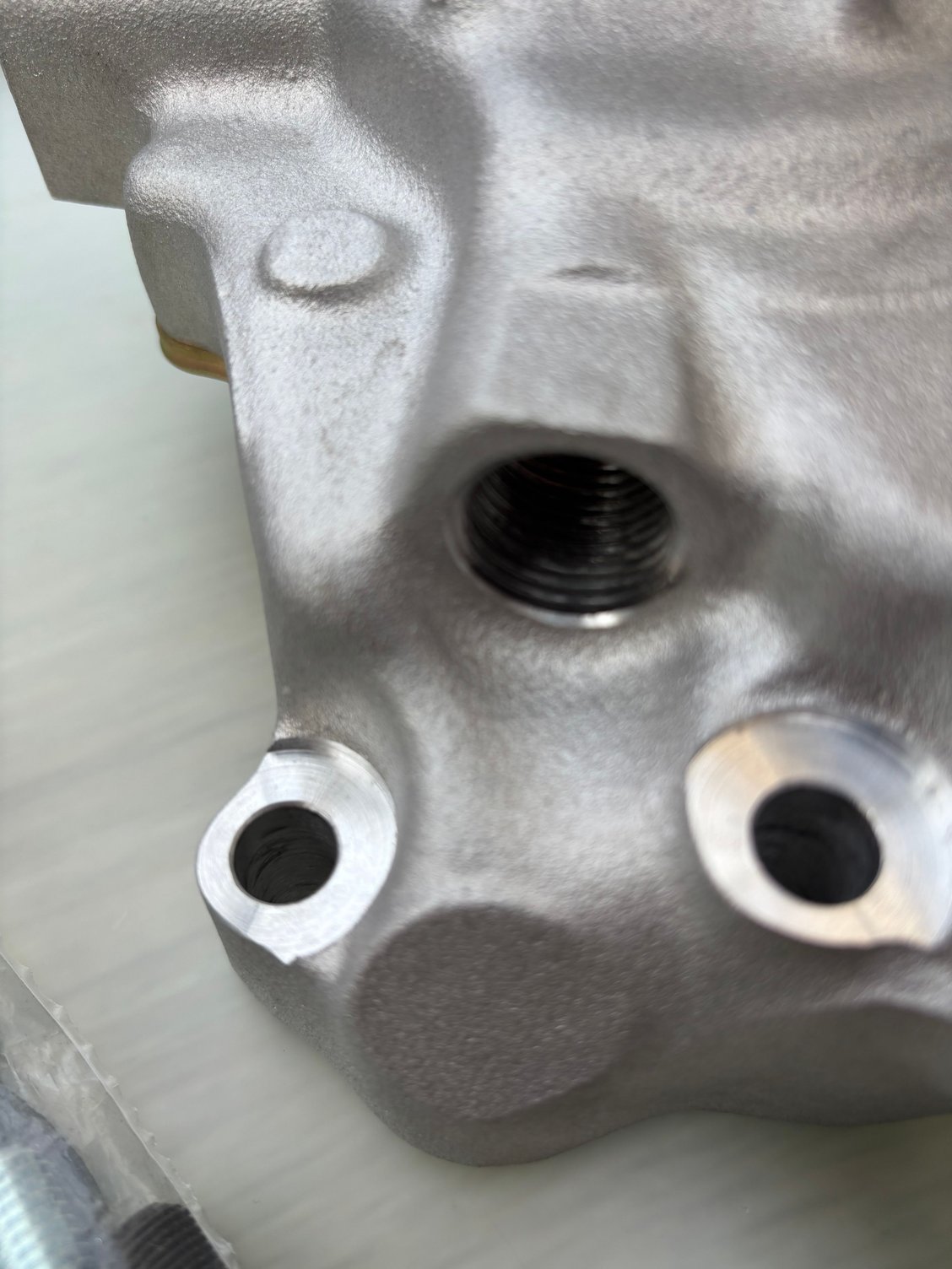

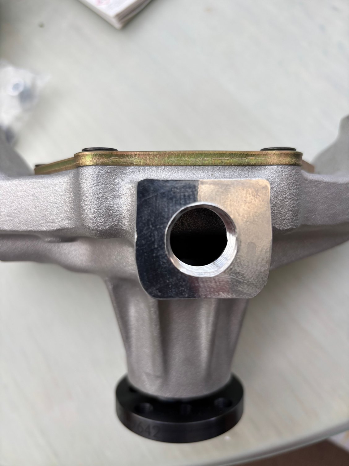

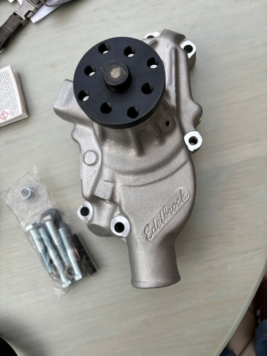

I removed my old radiator and waterpump, and now I’m prepping and cleaning the areas around to instal the new aluminum cooler gear (rad. + pump).
I have some questions regarding my waterpump and radiator fittings.
1. What is the best material for the plug on top of the pump? Brass?
2. What is the best material for the heater hose fitting on the side of the pump? Aluminum, steel or stainless? (Can’t find brass.)
3. Can I reuse the studs on my old pump? (For the fan + pulley). What locktide should I use?
4. What is the best material used on the new alu. Champion radiator transm. cooler lines? Can I just reuse my old ones from the original radiator?

It seems your new pump is Aluminum.
1. Aluminum
2. Stainless Steel
3. Yes, reuse old flange studs on new flange. Loctite Blue. New flange has Two bolt circles; ensure you select correct bolt circle !
4. Yes, your old trans cooler lines can be used with new radiator. Although that may (or may not) require adapter fittings.
* see the unused threaded bolthole at lower edge of pump; when pump installed (about 3 o'clock in picture) ?
If your motor does Not have retrofit roller cam; simply disregard that threaded hole.

do not do not use aluminum plug will strip threads been there done that
brass safest with never seize

use only brass fiting or metal
not not use aluminum
on heater pipe use aluminum or steel\ original from factory was steel
aluminum fitting screwed into that aluminum water pump will gall the treads will be stripped and be a bitch to remove it
same goes for a aluminum intake manifold
same with fitting in alumium radiatoe for automatic transmissionm lines
