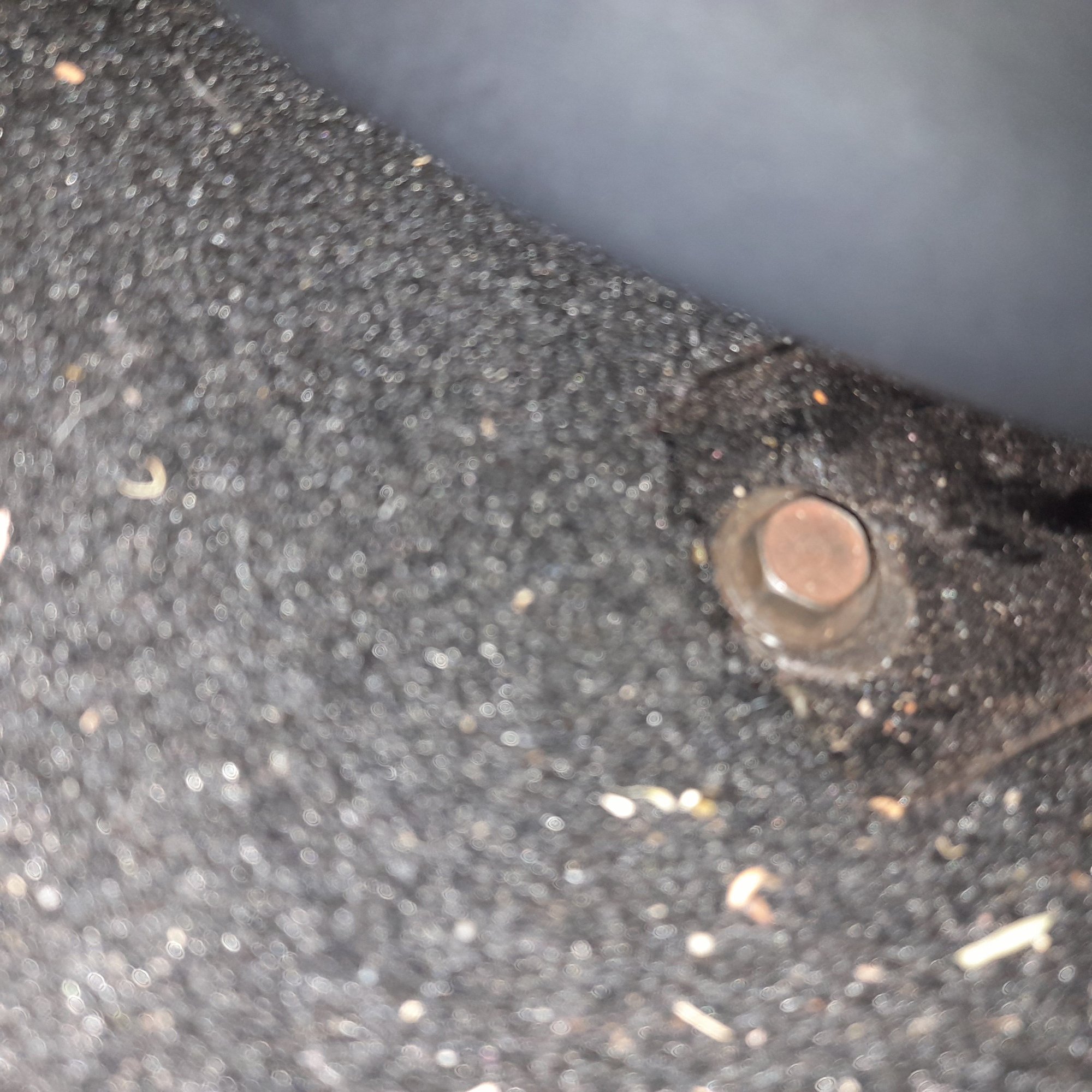

On a 77 Corvette. The bolts that hold the tracks to the floor?
These ones?
Hoping that's what your asking. I removed one. Absolutely factory original bolt.
5/16ths course. Standard body bolts. Captive washer. 3/4 inches long.
Go to a junk yard. The metal cars hold there front fenders on with these bolts.
Can't imagine what 8 proper bolts might cost. Your certain you can afford fuel?
