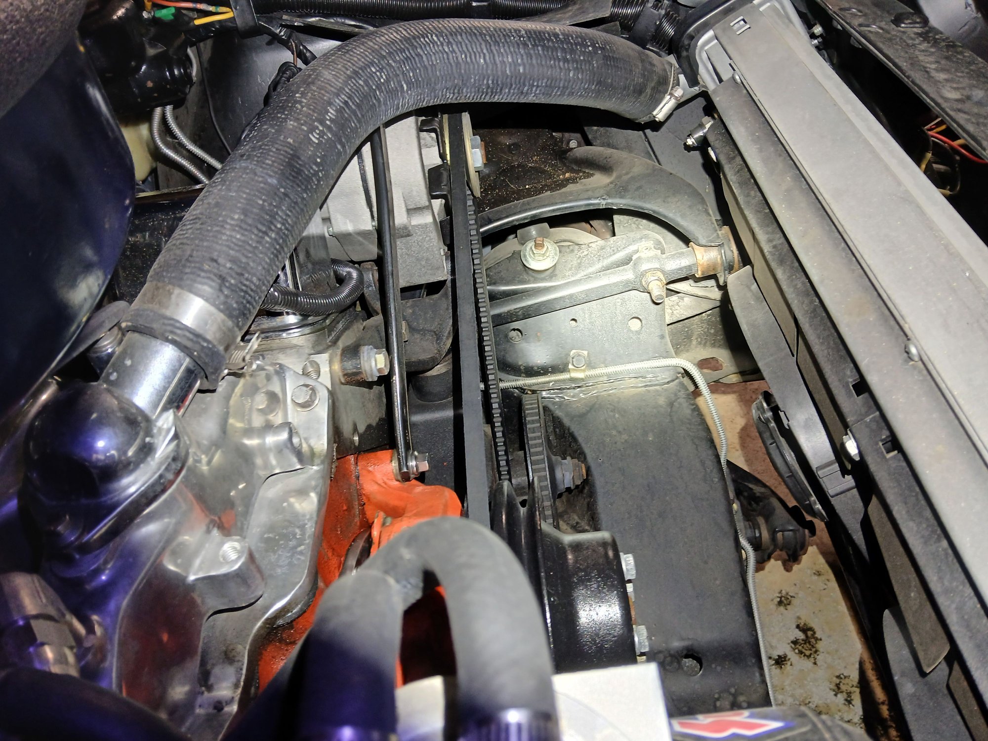

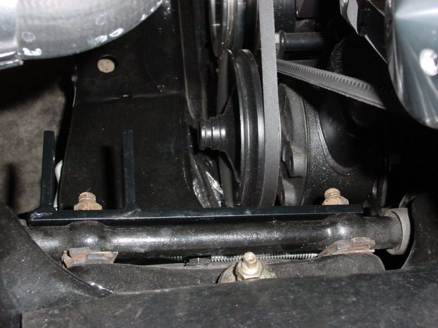

No need to get underneath, I'm thinking photos of the upper a-arms from the top of the engine compartment will show shims to give a clue as to caster adjustment.
Something like this:

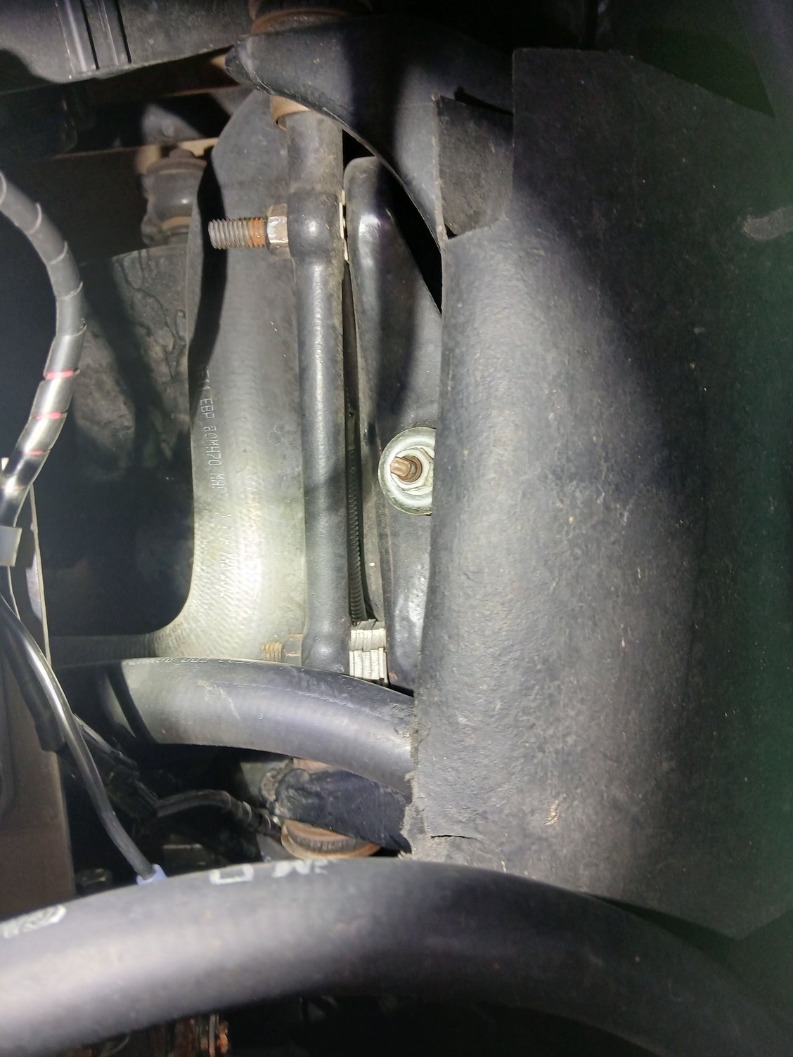

Not sure what I'm looking for here...

I was looking to compare the alignment shims front and back (yellow arrows). Having a thicker set of shims to the rear indicates there is at least some caster angle in there. Caster determines the self-centering qualities after a turn. Is the passenger side similar with thicker set to the rear vs the front?
The white arrow points to one of the a-arm bushings - both the top and bottom a-arms have two bushings. This one looks like the rubber is pretty cracked. If you poke it with an awl or screw driver, does it easily chip out and crumble - or is it firm but cracked? Are the end bolts into these bushings tight?

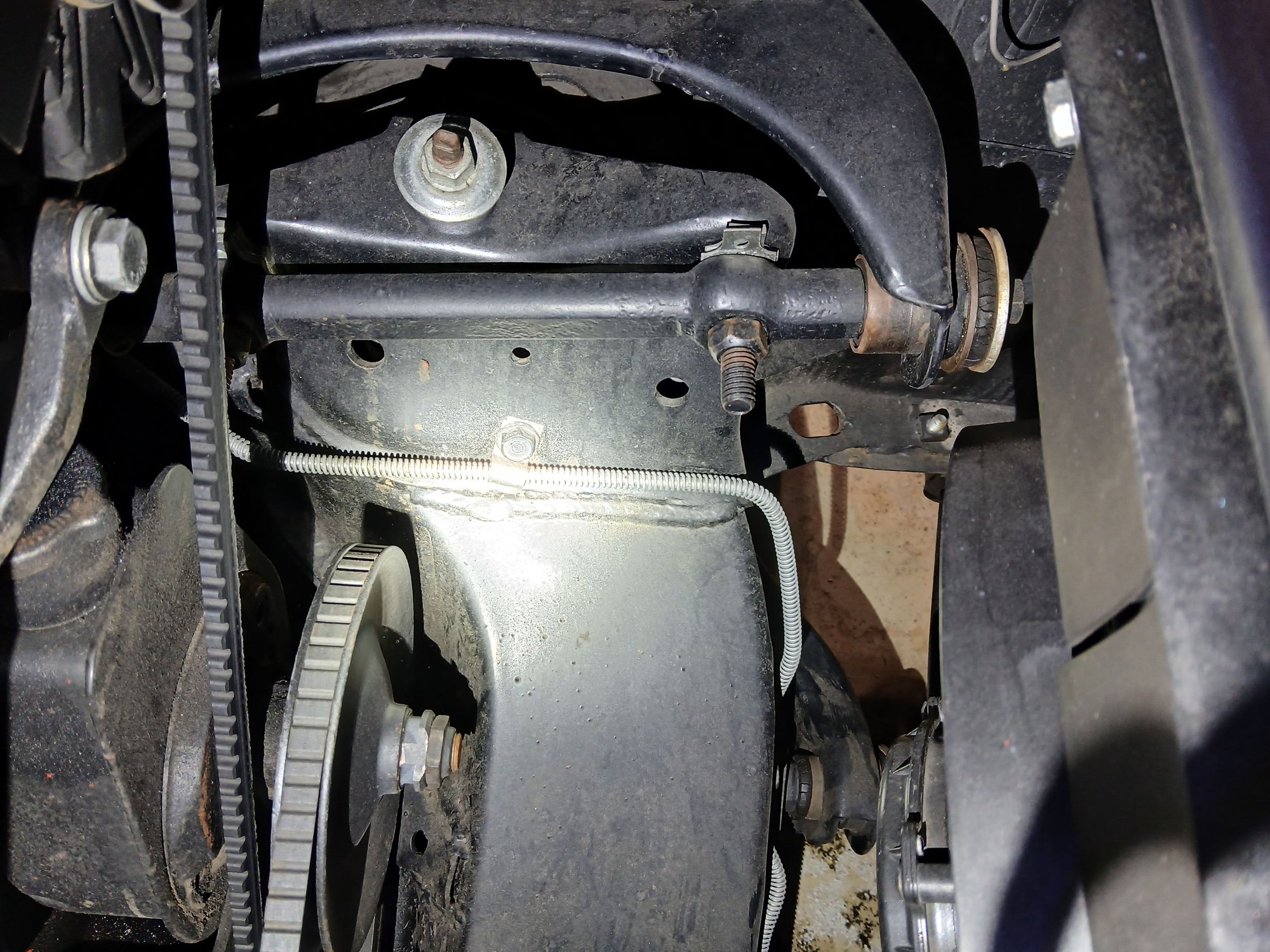

Both sides are shimmed thicker at the rear. As for bushings, no flaking or crumbling when poked at. All felt firm, just the obvious cracking as noted

Your passenger side looks to have quite a bit more shim thickness than the driver's - that's not definitive of the caster measurements but I kinda doubt they are similar measures, which they should be.

By the way, is the belt off of the power steering pump in the picture you posted in post number 4 above???

I wasn't questioning the belt on your pump, but instead I was questioning the belt on the pump in the picture below that Barkingrats posted. That belt sure doesn't appear to be on the pulley.

The pic in #4 is just something I found on the 'net, not my car.
