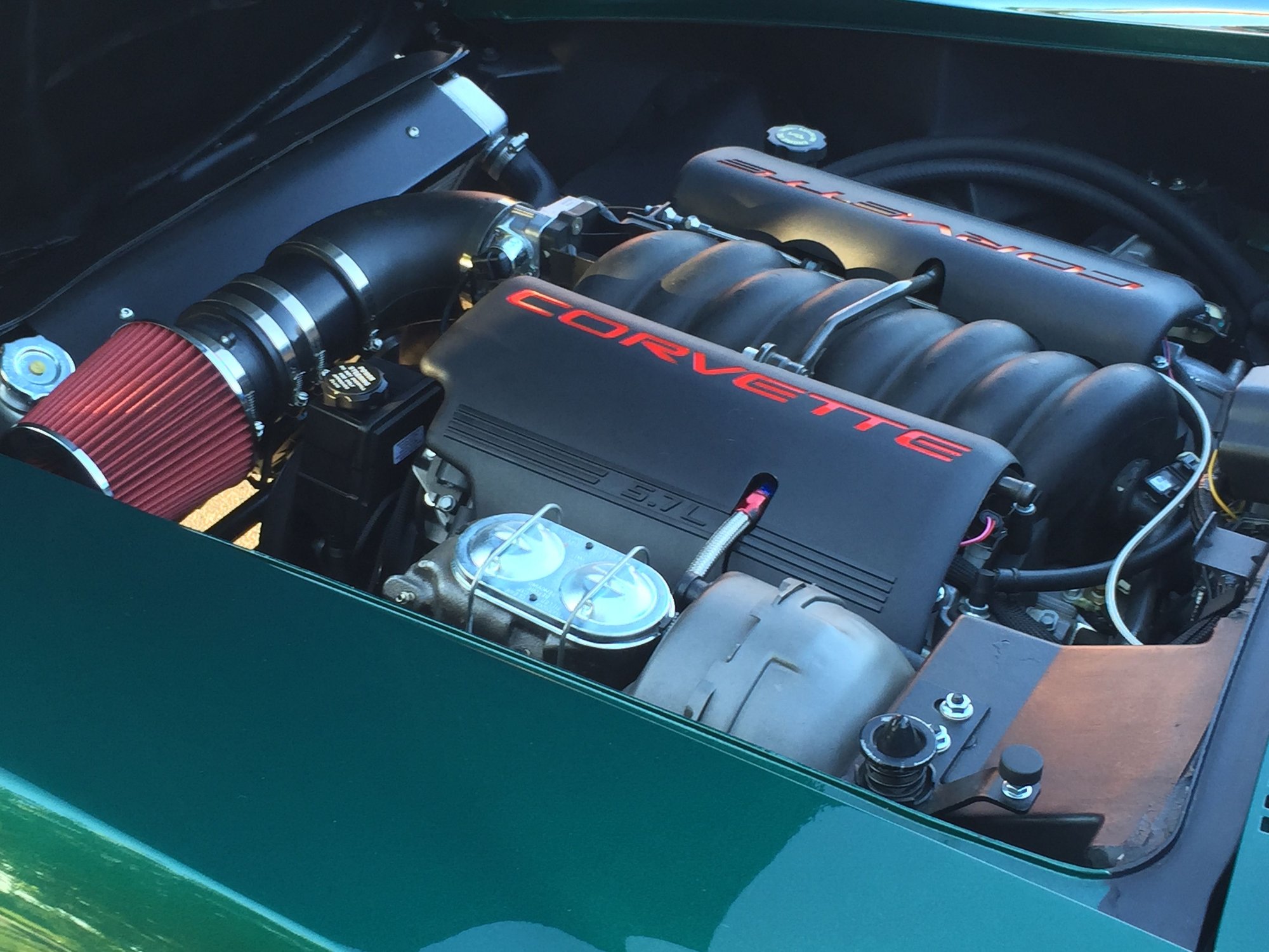

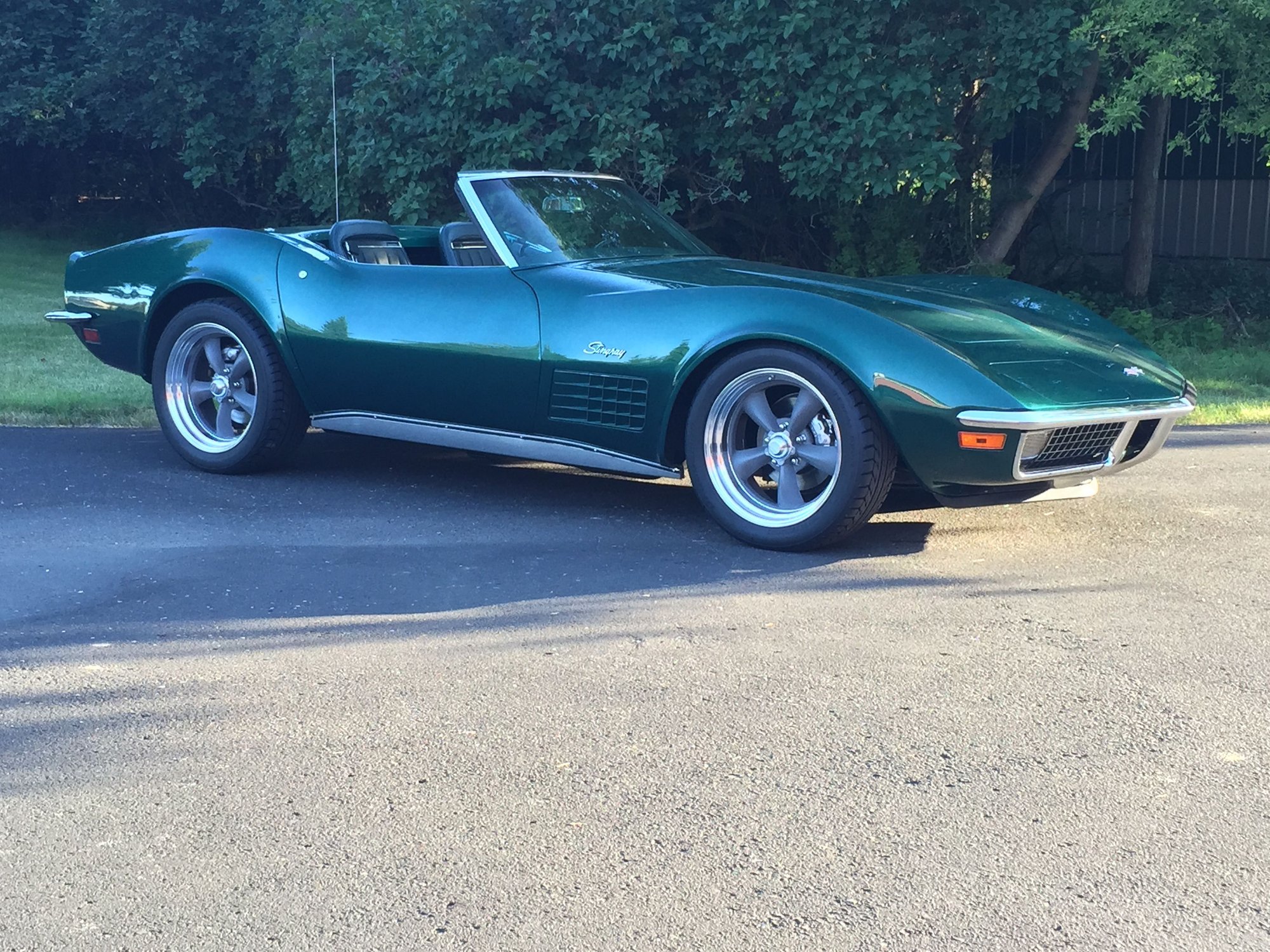

Pic of my 71 C3 with a LS1/4L60E combo. The LS1 was last "new" from Pace GM built they had in stock. Sold it a number years ago to make room for a new project. Was a great project.
Current project is a 80 Camaro with a LS3/4L60E swap.
