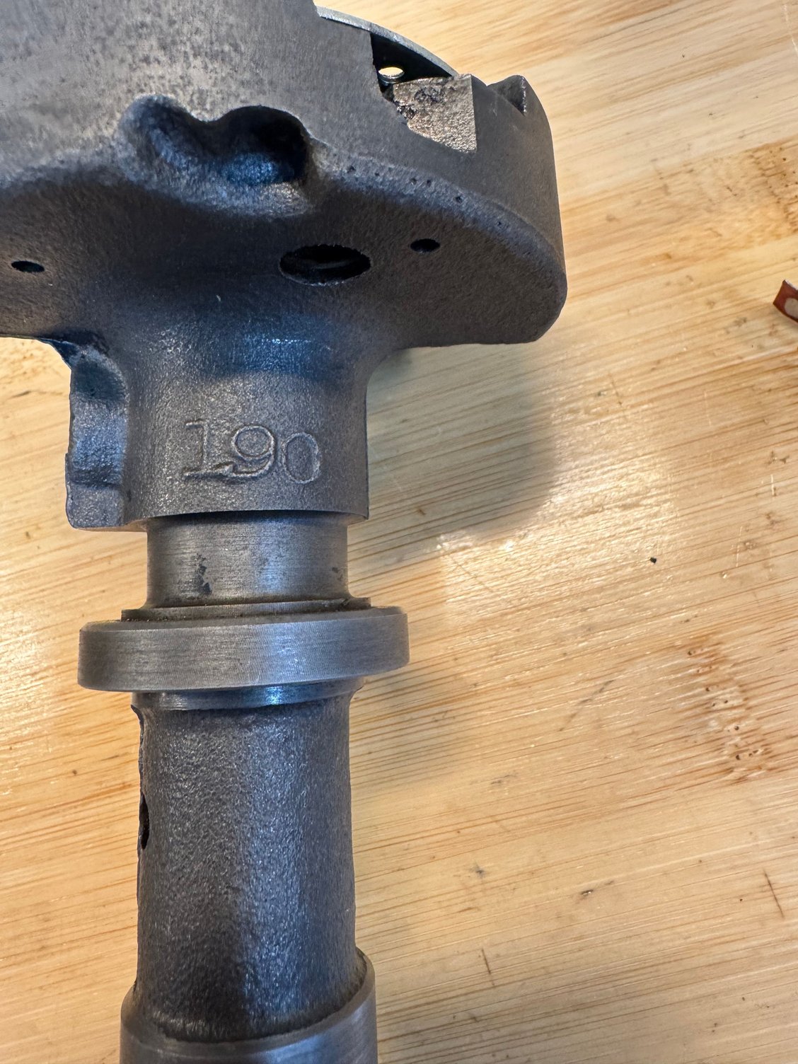

I have a couple of distributors that are missing their bands, so all I have is the casting numbers. They appear to be 3 digits, can anyone tell me how to decode them?

From what I understand, the distributors were only identifiable by the aluminum bands. The primary housing design change was the drilled hole at the end of the tach drive gear pocket, according to the '70-'72 judging guide, appearing in mid-70, but my '67 guide says it appeared in '68. 🤷🏻‍♂️
What casting numbers do you have?

Yes, I think it was around 71 the hole for the bushing button began to appear on tach drive Delco Remys. If the VAC is known to be original - that might be a clue.

The Corvette forum has this pdf posted:
https://www.corvetteforum.com/forums...352d1386500596

One is from a 72 LT-1 - I believe the casting is 681
The other is probably from a 69-70, casting is 190 pic attached
