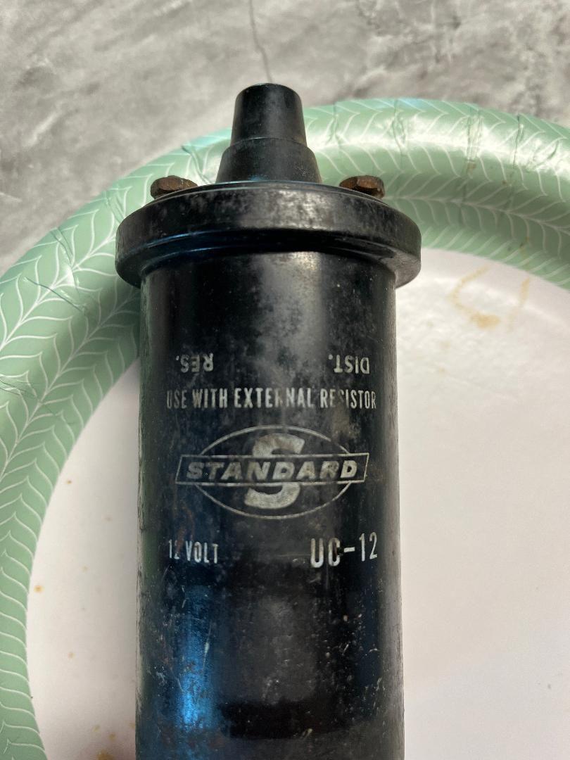

hello friends , I have this coil and was wondering if it is for a small block 69 Corvette , did it fit on a lot of different cars back then? thanks Bill

parts store special.

OMG!. That Standard ignition coil fits just about every SB and BB Chevy engine with points distributors. And just about every Buick, Olds, Pontiac and Cadillac engine with points distributors. And a lot of other auto manufacturers with points distributors.

It's not an original or OEM but it's just the same. Assuming it's in good working order - Yes it will work in a '69 Corvette. And a million other cars too.
You can check the ohms if you like - should be around 2 across plus minus and around 11k across plus/output as I recall.

^^^THIS^^^
quite so. A very good coil.
UC-12 remains in current production. Also UC-12X is SMP's "Blue Streak" performance version
