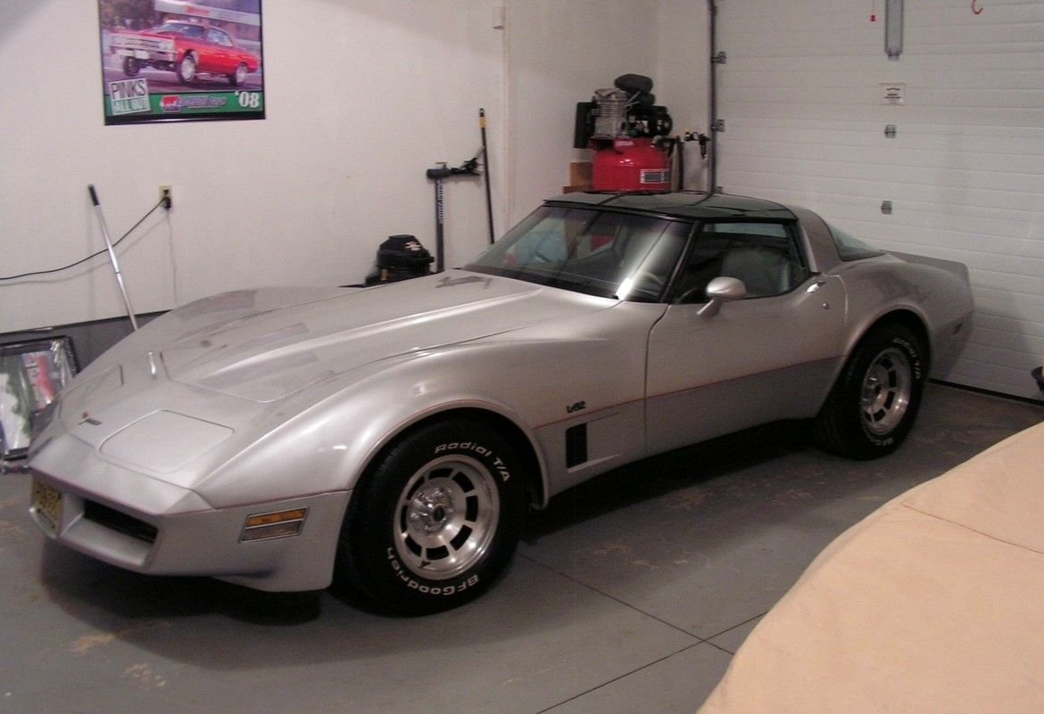

Hello C3 forum! I am new to C3's but not vettes. I have a C4 vert, 6 speed. I will soon be getting an 81 from the estate of a long time friend who passed recently. It is an automatic. I want to convert it to a manual!
A friend of my Dad has a fresh 1970 Muncie M22 rock crusher in his 72 Chevelle with a Hurst Comp shifter that he will give me if I swap back in his original automatic for him.
I have read a lot of threads about various swaps, but could not find a definitive answer. What would it take to swap this transmission into the 81? From what I have read, I guess that I will likely need to change rear end gears to maybe 3.73 or 4.11's for one thing.
The situation is the car has been sitting for probably 15 years, so it will need a lot of work ($$$) just to get it back on the road again, so budget is a concern with a transmission swap!!!
Thanks!
-Rick

are you certain its an 81? It says L82 by the photo which wasn't an option in 81... might be an 80? or badges just added to an 81
Good eye! GM didn't make any 1980 L82 4-speed cars at all, so this will be special once you are done.
The cross-flag emblems had chrome trim in 1980, and black trim in 1981. Check the VIN! There's a decoder here:
https://corvettec3.ca/vin.htm
Do you have a plan for adding the clutch pedal? Working under the dash is likely the most difficult part of this swap. If you decide you need new gears, consider a hybrid rear axle, using the 79 and earlier iron diff, with your aluminum batwing. The Dana rear end that came on 80-82 cars is a known weak point, and cars that came with automatics originally had the even weaker version of that. You may have to shorten the driveshaft for diff swap.
But by all means get the 4-speed in there!

Yes, I am sure it is an 81. My buddy's Dad bought it new. He blew up the original L81 many, many years ago before passing the car on to my buddy! It was replaced with an earlier L82 and the shop who did that added the badges.
