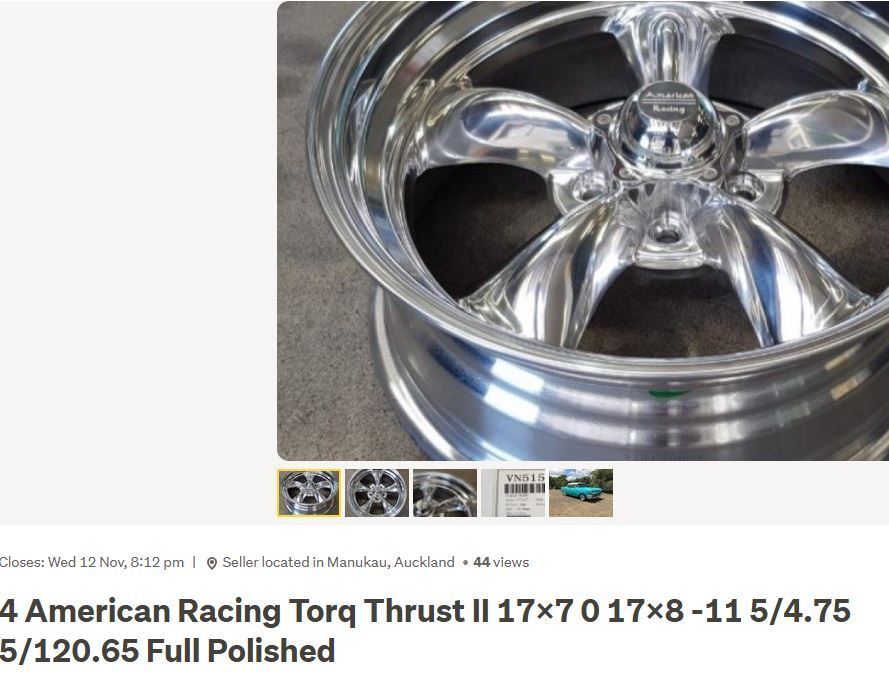

Does anyone have these wheels on their C3? if so do they fit well and what tire size do you have.
Does anyone have these wheels on their C3? if so do they fit well and what tire size do you have. I have an 81.

I have the gray version. 255/50/17 tires. No problems at all.

0 offset on a 7” wheel is 4” of backspacing, while -11 on an 8” wheel is about 4 1/16”. Your factory wheels are 8” wide with 4” backspacing, meaning the fronts will sit 1/2” inward because of the skinnier wheel, and the rears will be in 1/16” because of the increased backspacing.
Like what was said above 255/50r17 works well on the 8” wheels. For the 7” ones 225/55r17s could work.

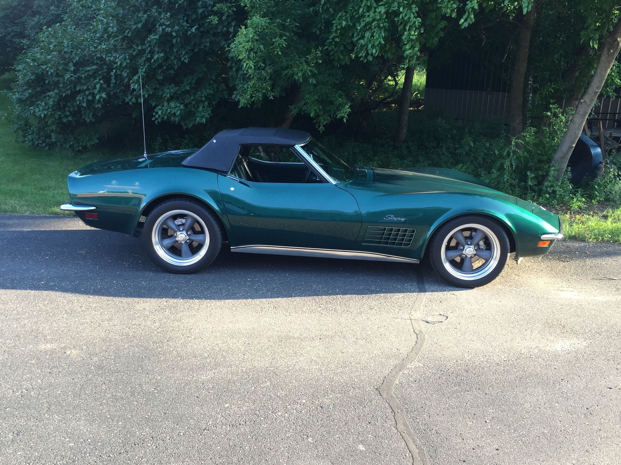

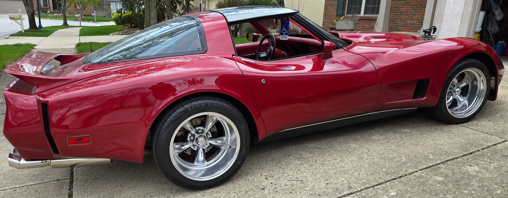

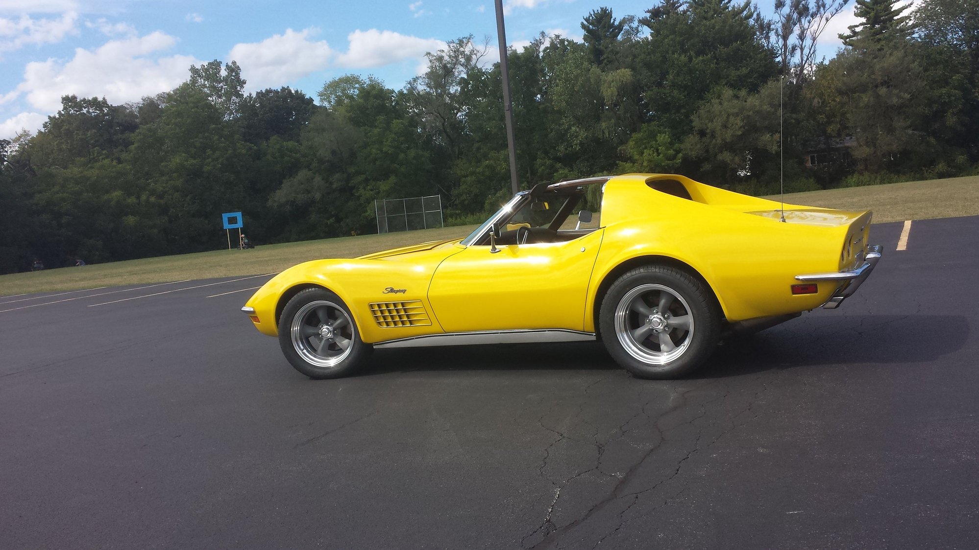

Old Nov 15, 2025 | 05:00 PM
71 Vert LS1's Avatar
71 Vert LS1
Joined: Sep 2010
Posts: 3,254
Likes: 686
I'm a fan of TT 2's. Pics of my 71 C3 and 80 Camaro.
Both have18". 275/40 in the back and 245/40 in the front.
Zero rubbing on either car.
One of the nice things about the grey centers is that the outer polished areas are clear coated, I think clear powder coat so no polishing.
The polished 18's need polishing once and while.

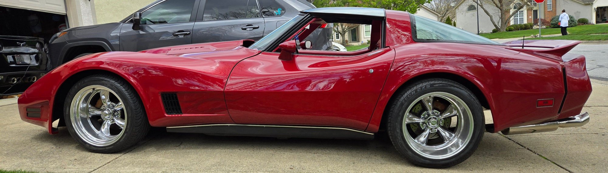

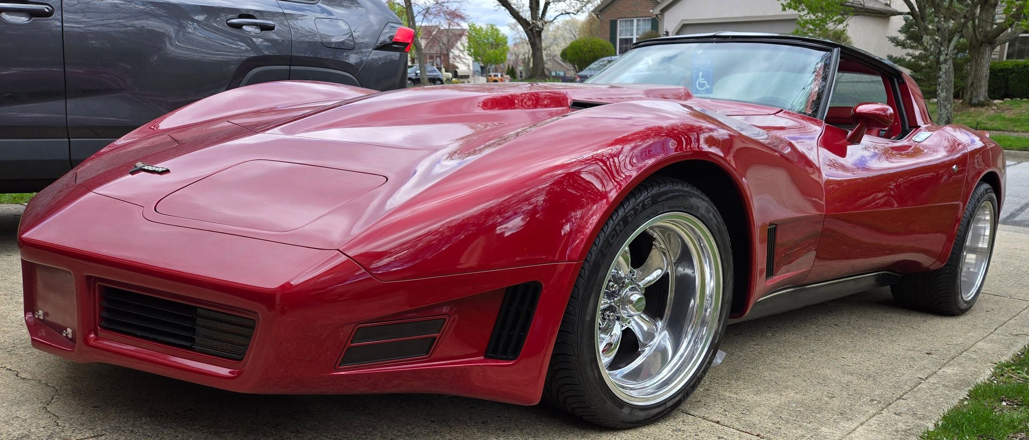

All done now.
All done now.
255 on rear and 235 on front. Speedo is spot on now and cruise at 100 km at 1900rpm
