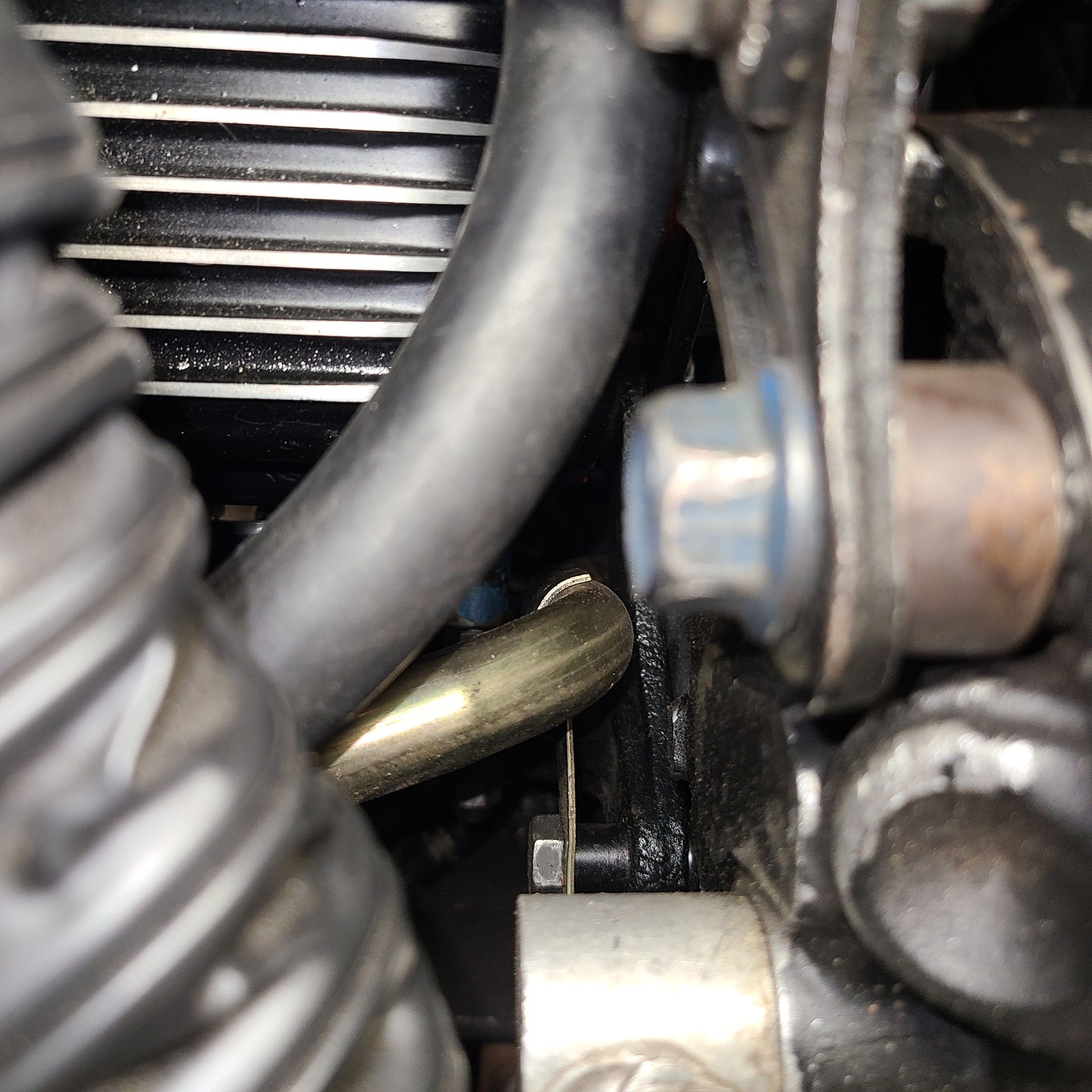

This is on 1981,when I did a lot of work with engine over a year ago,never hooked hoses back up,just set them aside,now hooking them back up,no issues with One going to intake,I guess that’s the 5/8 hose,but the one going to the water pump,it had like a metal tubing two bends in it,the nipple,then a short piece of hose maybe 2 inches long then the metal tubing from there to the hose,well,now don’t see any way to hook it up properly,I’m assuming because of the headers,not sure,but can’t I just,discard the metal tubing and get another piece of hose,and put like a pvc connector to hook the two together.

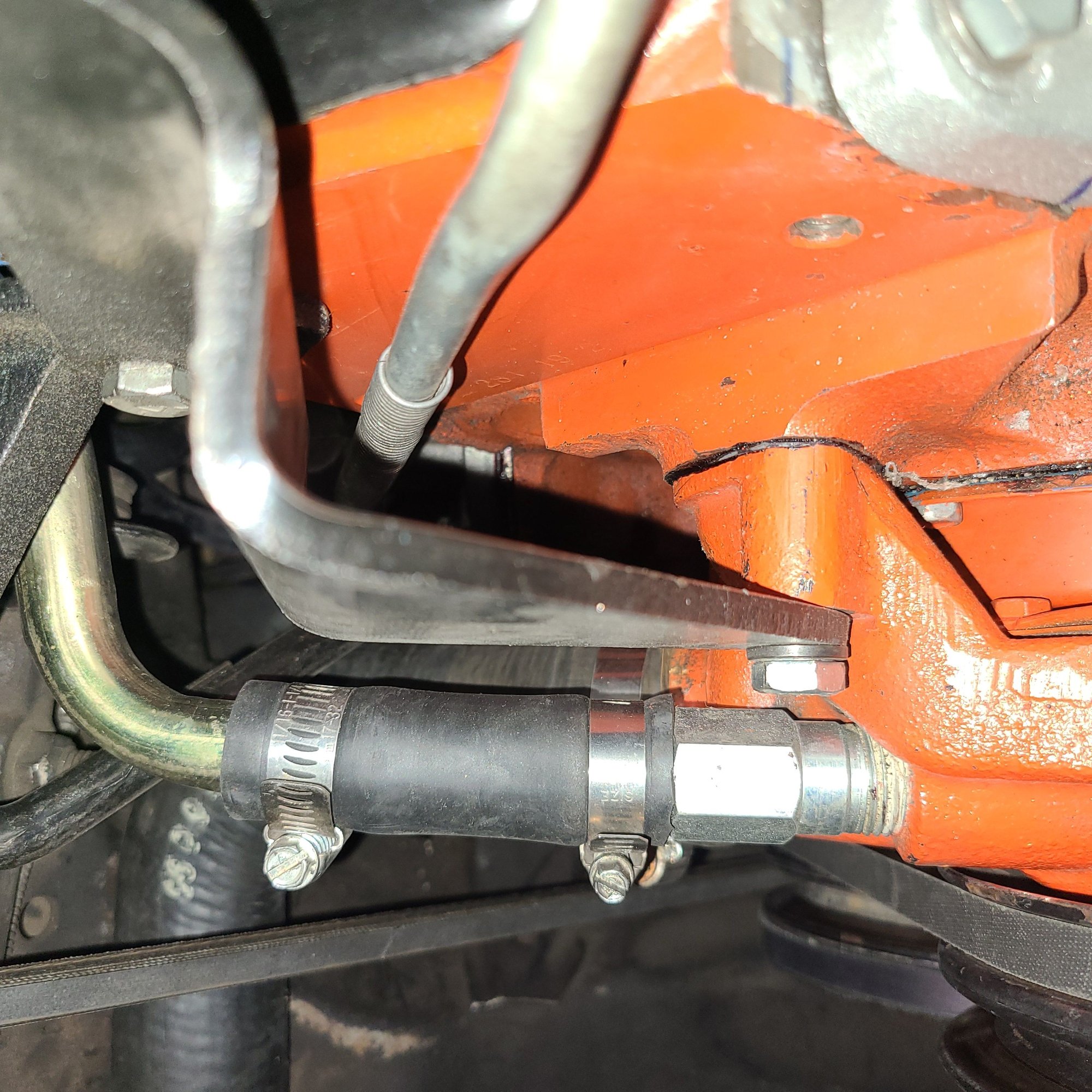

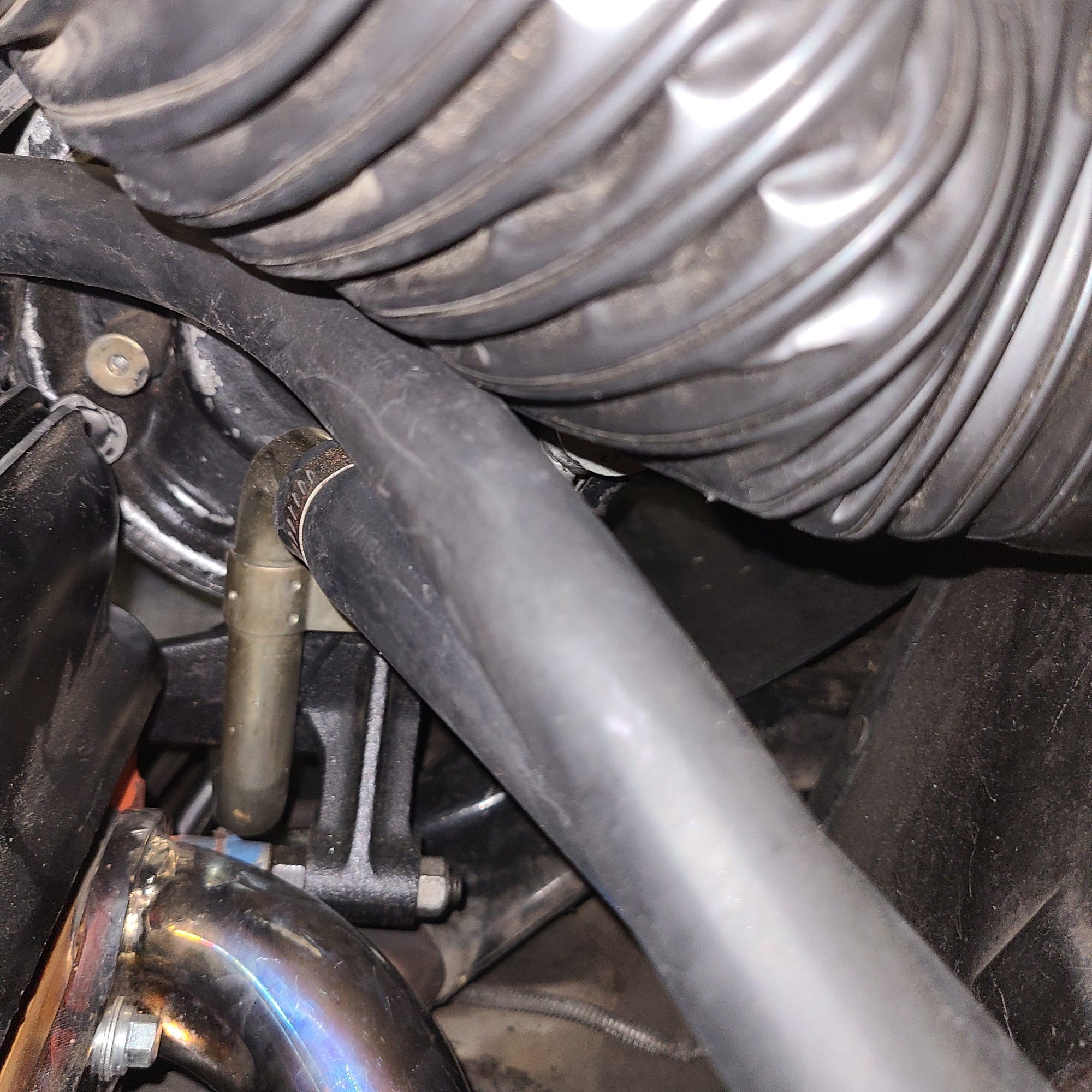

It bolts to the back of the A/C compressor and works fine with headers. Keeps the hose routing safe. I would just use it.
Bolts to back of A/C compressor
Keeps hoses away from hot header tubes
Short run tp water pump.
Short run to water pump.

Thanks,I knew it went somewhere behind it.
