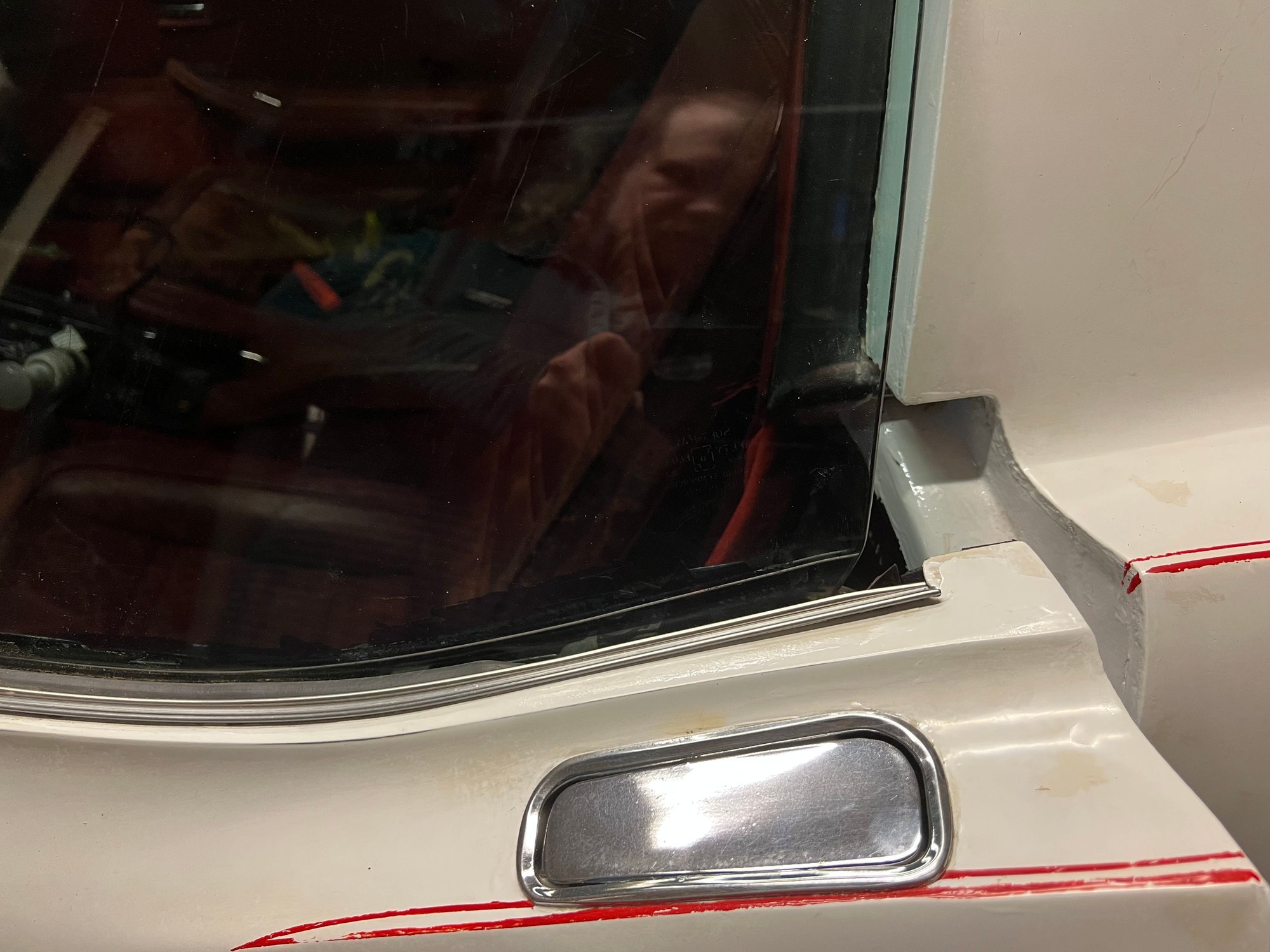

My window glass seems to be forward about a half inch too much. Been messing with window and door, but not sure how to fix it.
i assume there is something that bolts with a slot somewhere.
you can see in pic the windows forward roughly .5” more than the passenger side (and that one closes fine)
can’t even close door with it right now, thankfully it is inside.

Hi there @a kungfu mastah This is an often posted about concern. I have more than this suggested video, but am hoping you can watch this one and learn to solve your debacle. Let me know if not so that I can attempt to maybe point you to another source of a possible solution.

BUY the AIM for your year. it has the procdure right in it....some other good info as well but the drawings are pretty bad

Here’s a few more that may help you to understand the workings:
That guy (The Driveway) has a ton of useful vids
