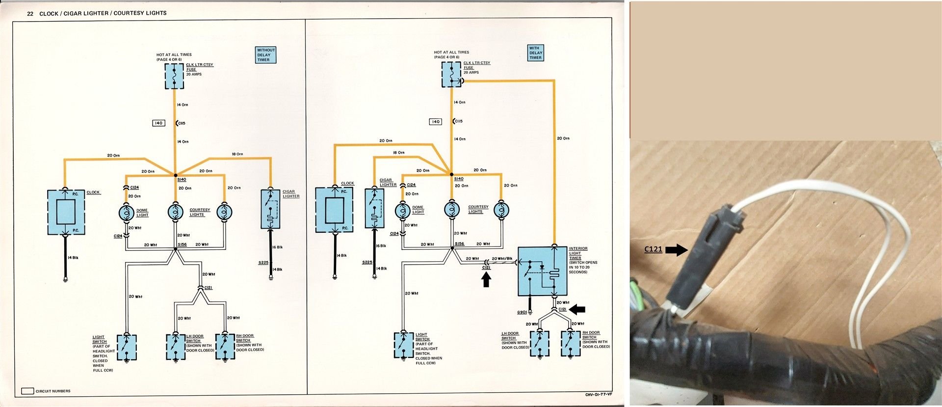

Just a FYI:
This timer GM #461294 was used on the 77 & early 78...
Ebay Link:https://www.ebay.com/itm/37474674969...SABEgJqefD_BwE
Once you locate the timer it is easy to bypass...
The connectors on the drawing I marked with a black arrow C121 C=connector
At the timer harness you will see a pair of connectors, one with a single white wire with black tracer...And a connector with a pair of solid white wire...
Disconnect those 2 connectors from the timer and plug the 2 connectors from the main harness into each other as shown in the photo right of Courtesy Electrical diagram...
