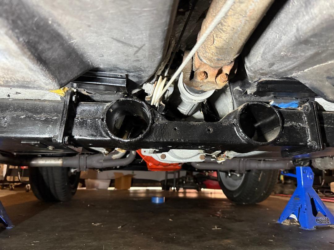

Frames: For several years, GM Parts sold the 1973 frame as a service replacement for 1968 through 1973 C3 frames. I ordered a frame for a manual so it came with the frame mounted bracket for the clutch assembly Z bar. The tranny crossmember was, of course, welded in. The cross member fits with either the manual or automatic tranny.
My opinion: You should convert the tranny crossmember to a removable configuration. It greatly facilitates removing the tranny to service the clutch. I had my 1968 frame converted to a removable configuration. Here's a picture of the tranny crossmember now.
The work was done by J&D Corvette in Bellflower, CA. The brackets shown here, on the tranny crossmember, were fabricated by J&D. They converted my 1970 to the same removable configuration two weeks ago. The brackets used for this conversion were purchased by me from the internet. Paid $99. Forget who the vendor was.
Notice the rusty headers and exhaust pipes for my N14 factory sidepipes. I'm now in the process of transitioning to an all stainless steel configuration of headers and mufflers. Stainless steel headers by Sanderson Headers in San Francisco, stainless steel sidepipe mufflers by Hi Flow Performance in Michigan.
