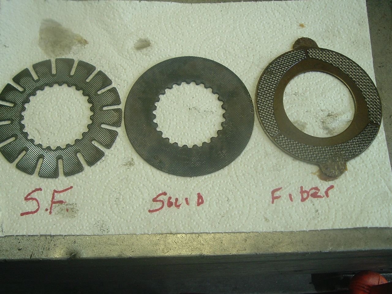

1971 Eaton Posi
You may have solid steel clutches or what I call snowflake clutches since they look like a paper snowflake from grade school days. Most 71's had solid steels. The 72-79 had the snowflake clutches and they were an attempt to resolve posi chatter, which was a problem with this posi setup since 1965. It didn't work and only made the clutches weaker, often with abuse they broke into pieces.
You need to first confirm the posi isn't cracked, if you find a crack, even a small one, the posi is junk and needs to be replaced. If the posi checks out you can use it as is, I never do and install new clutches.
New clutch choices today
  1. Snowflakes- yes vendors are still selling them even though they are known to break
  2. Solid steels, I use these all the time. I tune posi's using these clutches.
  3. Fiber, I have plenty of these in stock at low prices, but I rarely use them. They resolved the issue of posi chatter because they smudge at every turn. Over time the fiber ends up in the oil, the clutches have play and they start to chatter again. They cannot be tuned, only used with the heavy springs they come with. At that point the answer is to buy another clutch kit and install it. Not what I would recommend but some like them. Most don't know anything about them.
How you build the posi will make a huge difference in how it operates and lasts. You can follow the manuals and get an ok job at best or Do what Tom Watt and myself have done for decades, tune them. Do it right they outperform and last, do it wrong and you will either have an open diff, excessive axle endplay, or break the spiders. It is more than leaving out the spring pack and I once taught guys how to do them, but no more.
Whoever said solid steel clutches only last 60k miles is clueless.

Here are the clutch types used in Eaton posi's, 65-79 and aftermarket.
