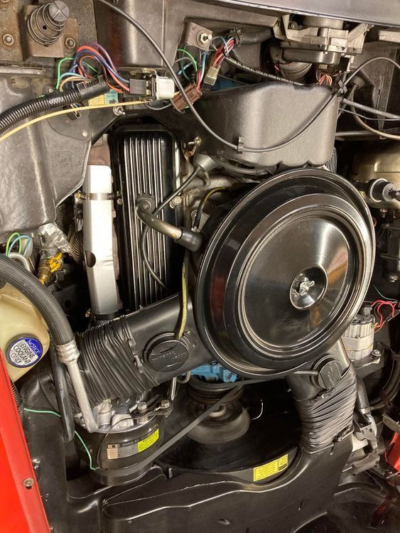

I’m getting some heat from the Rams Horn manifold that is causing the paint on the hood to bubble slightly. Until I can address the paint issue, I’d like to minimize the effects of the heat from the exhaust on the hood.
There’s currently no insulation (or mounts for insulation) on the hood. I’m open to any short or long term solution at the moment, including covering the manifold.
Thoughts?

It’s possible that the paint is blistering due to multiple issues; however, it’s only happening on one side (right), and only directly above the exhaust.

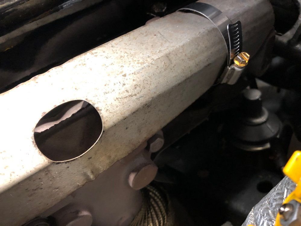

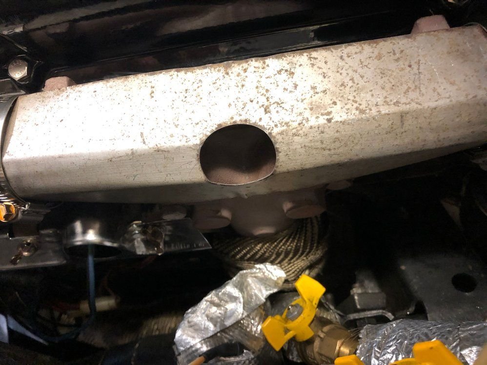

i used a factory heat shield on passenger side.. one year only..80 .Worm clamps and sheet metal..hole was for exhaust flapper removed.
thread on mine
https://www.corvetteforum.com/forums...at-shield.html
@vince vette 2 pics

thanks - I feel like something like that heat shield would help.

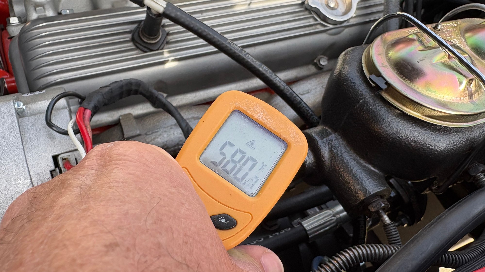

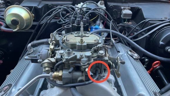

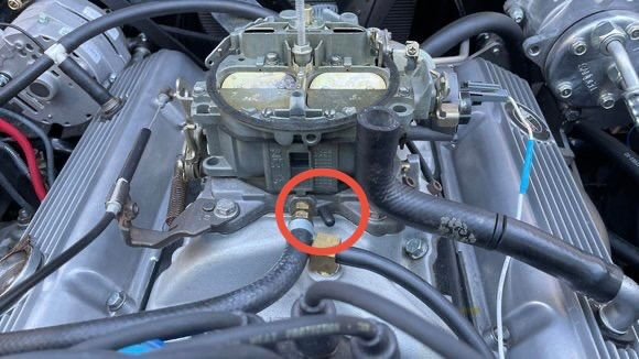

timing shows about 10 at idle and a little over 30 at speed.
Right
Right
Left
Left
this is pointed at the center collection point on the manifold.

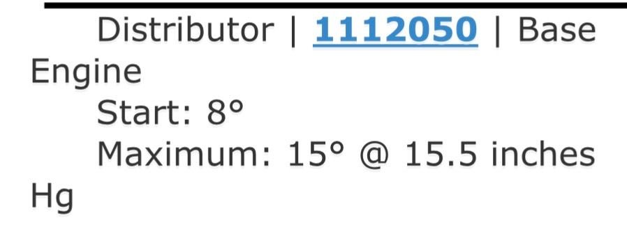

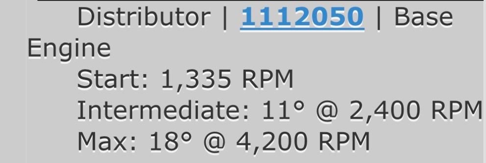

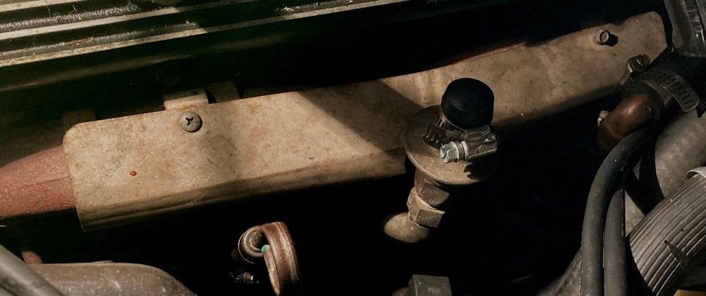

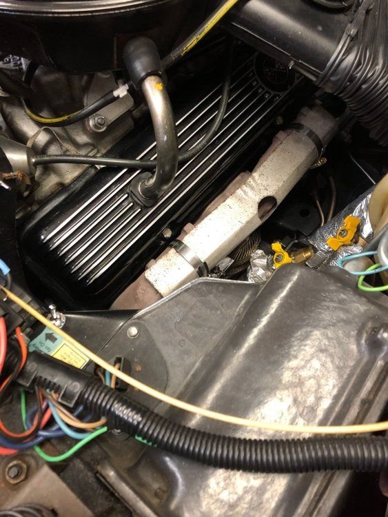

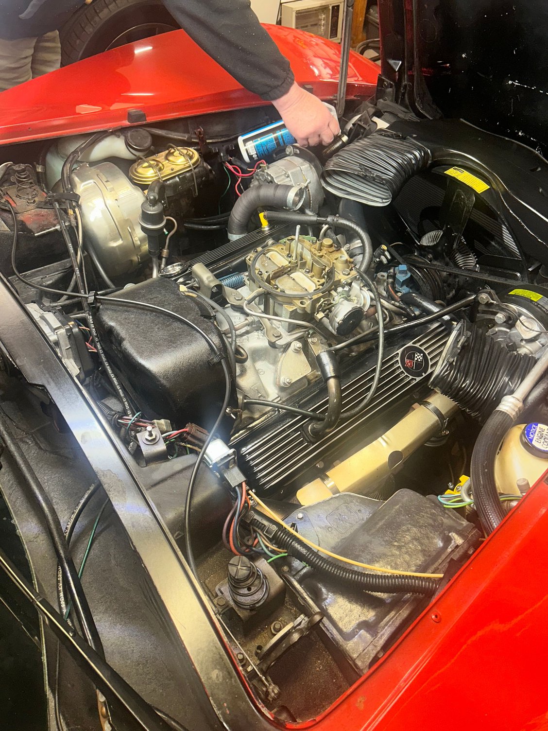

These pictures are from a different thread of yours. This is assuming your setup is the same now.
Your vacuum advance is hooked up to a ported vacuum source. This will retard your timing at idle and make the engine/exhaust manifolds run hotter. Finding a manifold (has vacuum at idle) source will add in your vacuum advance timing at idle and make the engine run cooler and better.
A source like here
These are the ignition specs for a factory ‘71 270 hp engine. Your distributor should have an 18 degree swing of mechanical advance. Meaning to get the maximum 36 that a small block with older style combustion chambers likes you’ll want to be running 18 degrees of initial timing.
Add 15 degrees of vacuum advance on top of that and you should be measuring 33 degrees at idle, assuming your vacuum advance is hooked up to the proper port. That’s much more than the 10 you have now!
15 degrees of vacuum advance will actually be a little bit too much timing, but getting a limiter on it that restricts it to 10-12 will put you in the 28-30 degrees at idle range, which is right in the sweet spot that I quoted on post #2.

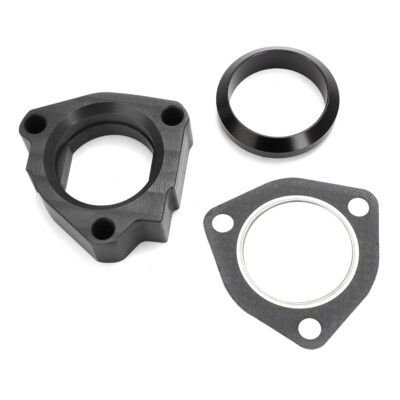

As for your heat riser valve, personally I would wire it open or get a spacer so you’re positive it isn’t/wont ever get stuck closed.

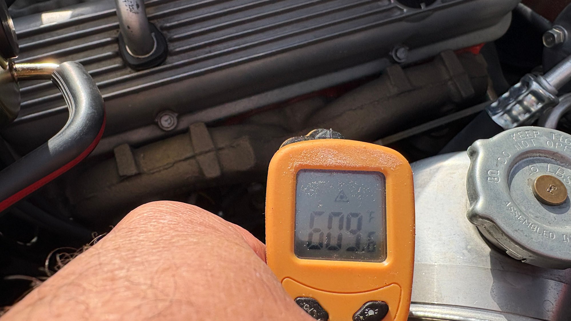

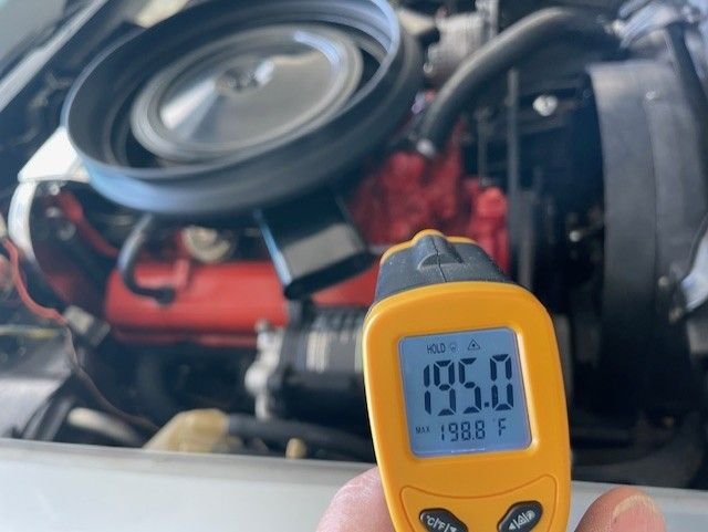

As I have posted here before, here are some temp readings, after a long drive on a HOT day here in Arizona. I have headers, but as others have said, you have a larger problem generating the heat. First pic is the water neck temp, second is the hood temp on the outside, not the underside.
Let us know what you find.... will be interesting to see what you determine
