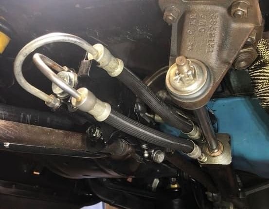

Have you rotated the steering wheel lock to lock a couple times to assist with bleeding the system?
Do you have the valve to ram hoses crossing in an X arrangement at the valve?

Yes and Yes

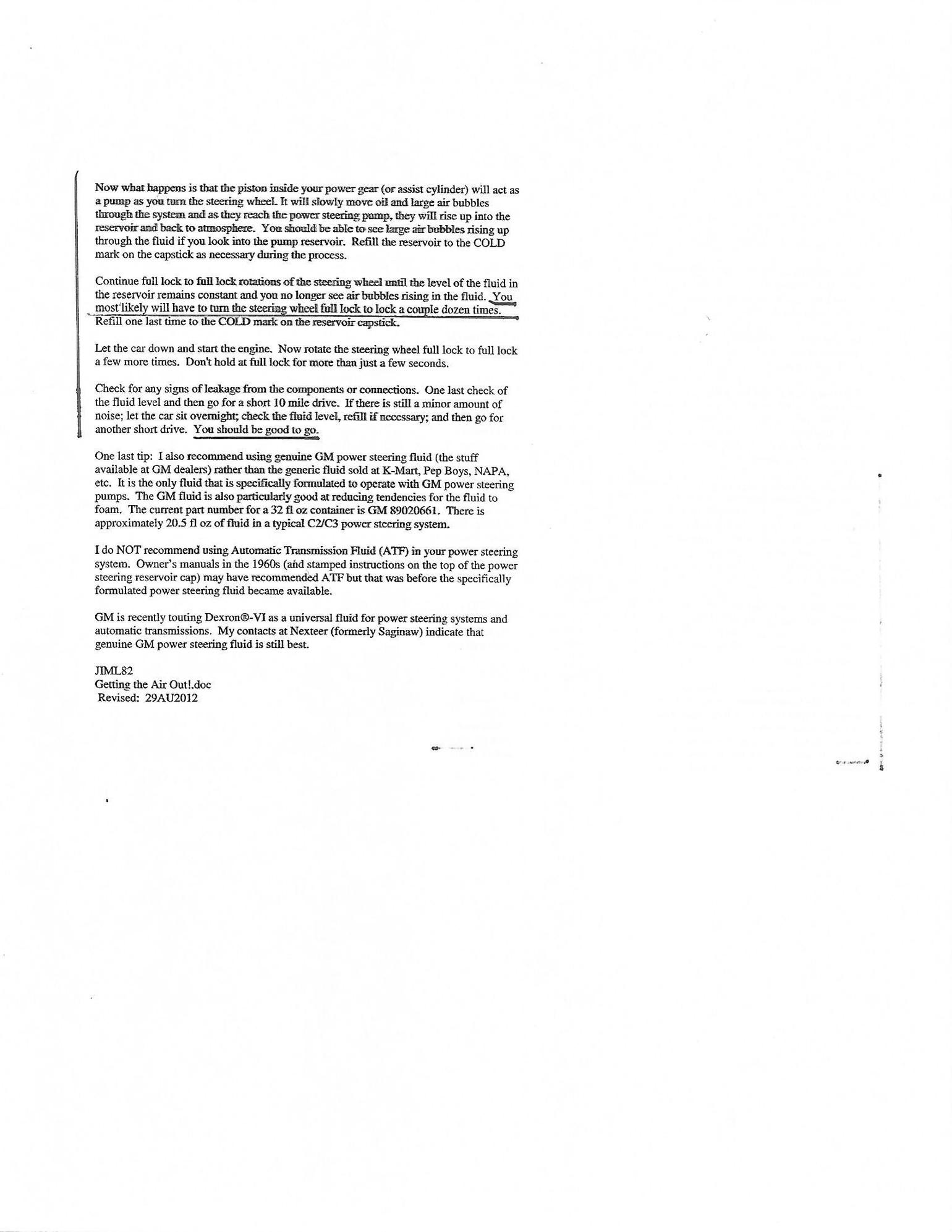

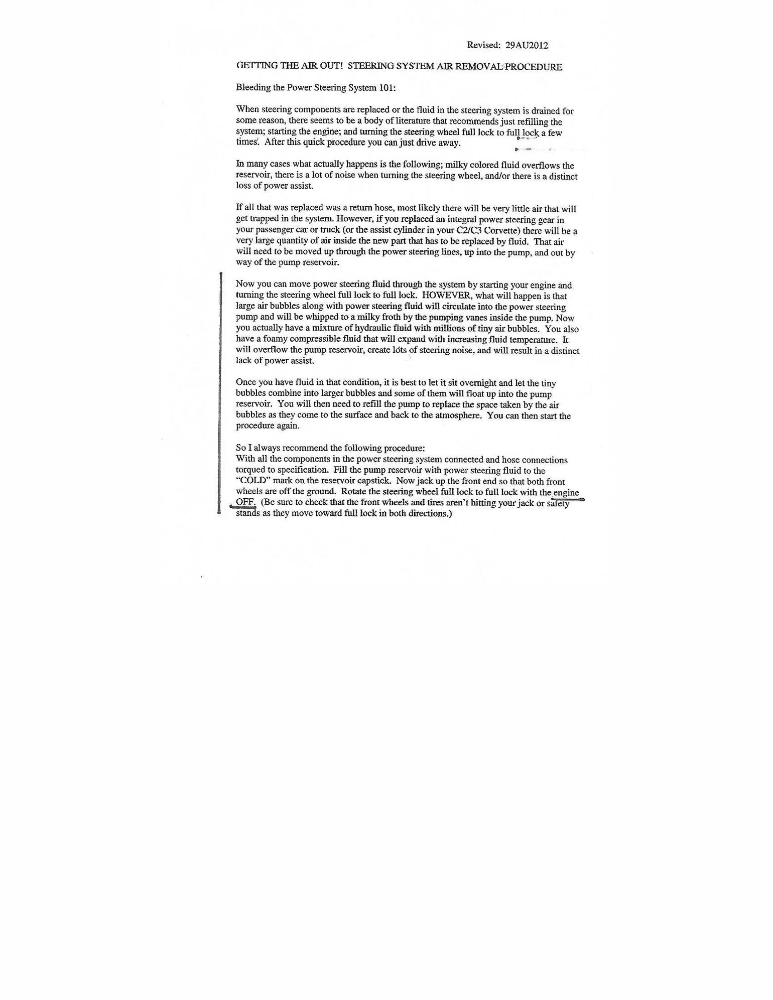

Follow THESE INSTRUCTIONS BY Jim Shea, AND YOU WILL BE GOOD TO GO.
