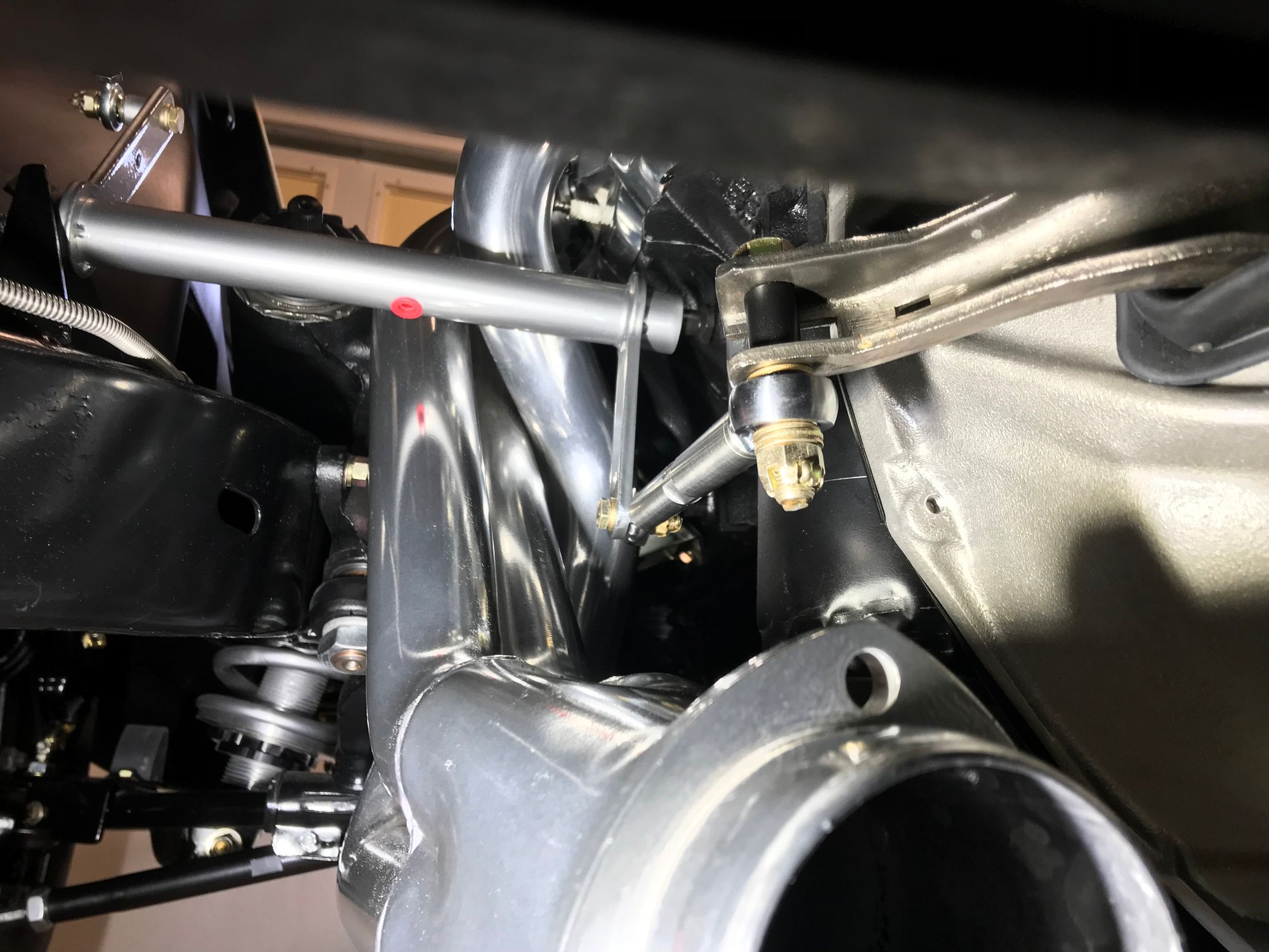

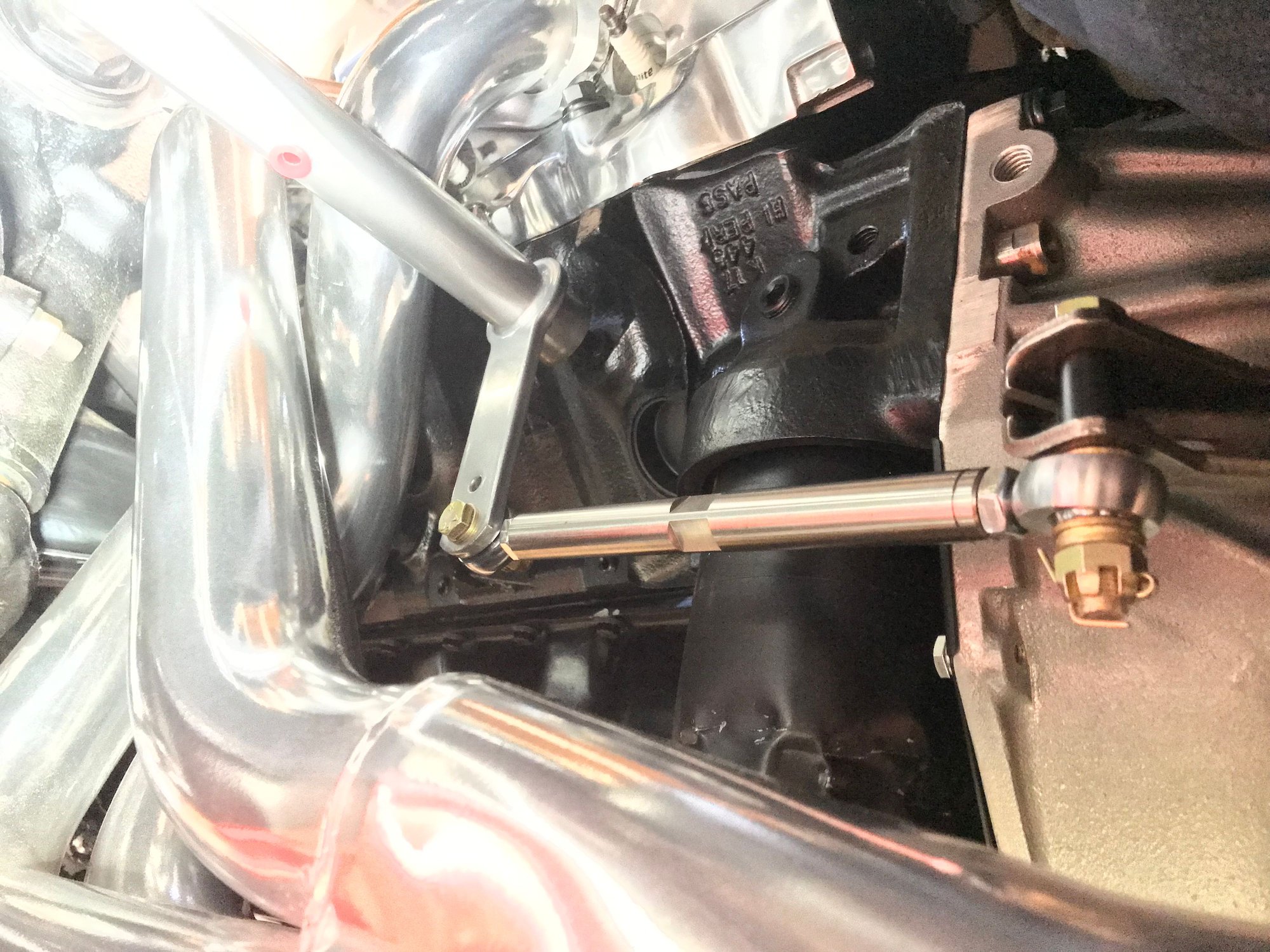

Before you start tearing things apart, you might look into the Speed Direct clutch linkage kit.
Numerous of us have installed them, all you need to do is replace the linkage rods to the new spherical rod ends and it is supposed to make a world of difference.
I just installed the kit on my car but haven’t driven it yet.
Ignatz has the kit installed and many others do as well.
The kit is nice, but we have all upgraded some of the components to make it even better.
There have been several threads on the kit and the modifications.
I also posted a recent thread of the install and upgrades.
To me it would be worth the try before you go with a hydraulic clutch set up.
