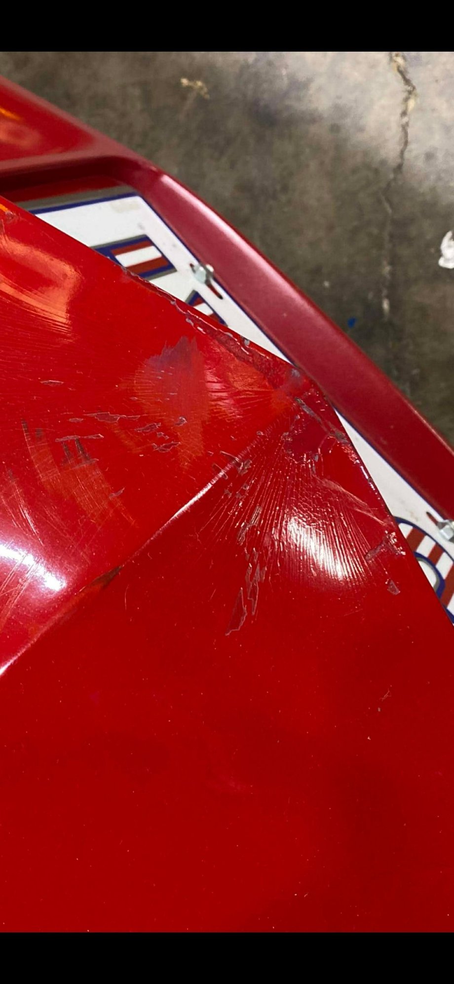

I am thinking about buying a vet but was wondering if the fiberglass body is going to cost me money down the road. Ive looked at a few with the paint spidering and some fiberglass damage. I was told that old fiberglass will spider and be a lifelong issue as long as I own it. Any ideas about this before I invest in one?

Post #107 of this thread has a lot of good buying advice. Besides rust, paint can be one of the hardest and most expensive things fix on one of these cars. Spider webbing is pretty common on a car with original paint. It’s up to you to decide if it’s bad enough to do anything about it. A good paint job can easily cost 10-15 grand. Usually a ‘76 with good paint costs less than that.
Post some pictures of the car you’re looking at! Theres lots of very knowledgeable people on here, and they can tell you anything else to look at on it.

It may be that the fiberglass is effected as well.

The front and rear bumpers of ‘74 and up (only front of ‘73s) are made of polyurethane rather than fiberglass. They commonly look like that. Luckily they are much easier to replace and paint versus the actual body of the car. The fronts are especially prone to cracking because people often bump things forgetting how long the front ends of these cars are.

Spider webbing and crazing had more to do with the characteristics of lacquer paint rather than being put on fiberglass. Lacquer is a brittle material where the body flexes and the paint doesn't. Original (pre-1980) or old finishes (prior to ~1995) were most likely lacquer. Modern base/clear is much more flexible and forgiving.
Jeffmo64, I don't consider my Corvette bodies and paint difficult to care for — the costs to repaint a Corvette are about the same as doing the same level of repaint on any other vintage car. It's not the body that makes an expensive paint job but the expectations of the owner.

This is clearly DAMAGE / NEGLECT, once a Corvette is painted "CORRECTLY" & I say again "CORRECTLY" garaged, & taken care of, it shouldn't have any paint issues. The rest of the car now that's a different story ( especially RUST ) !!
