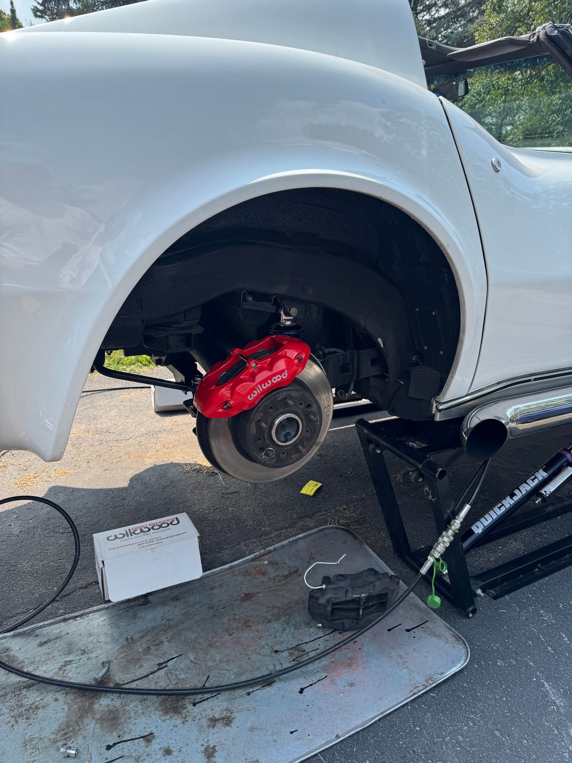

From: Minnesota
Not at all. I have Wilwoods on mine.
