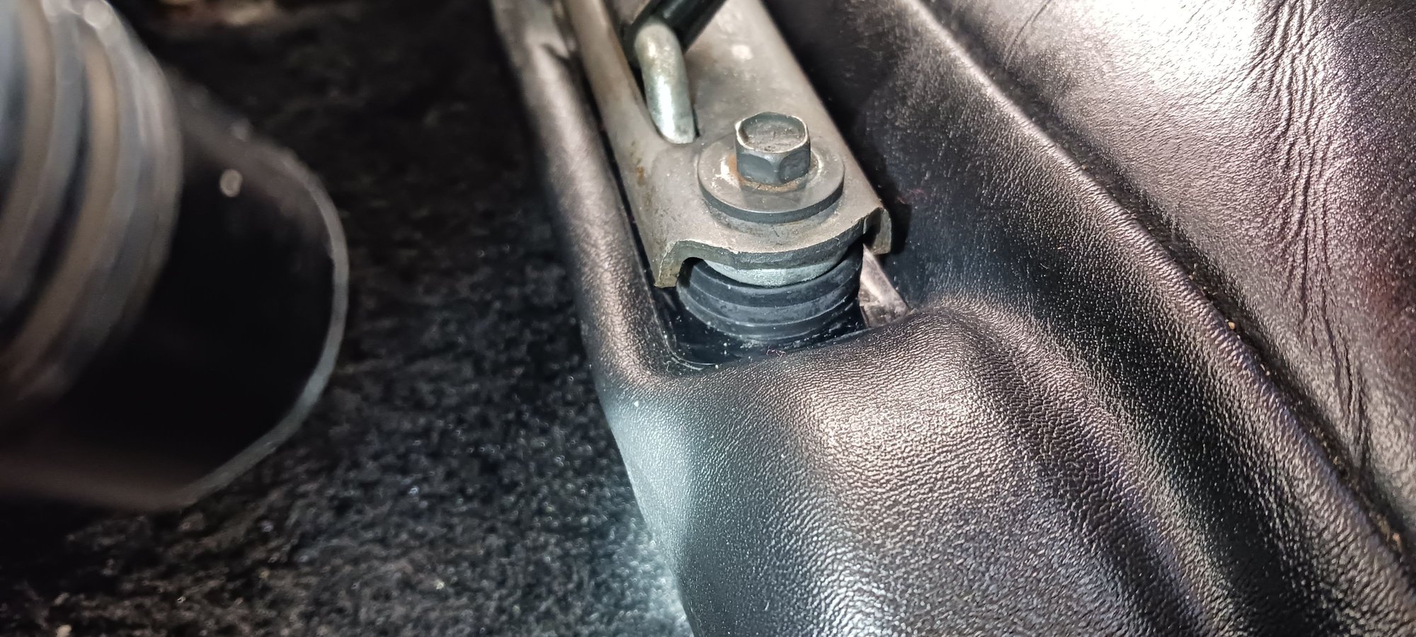

Here are some pics:

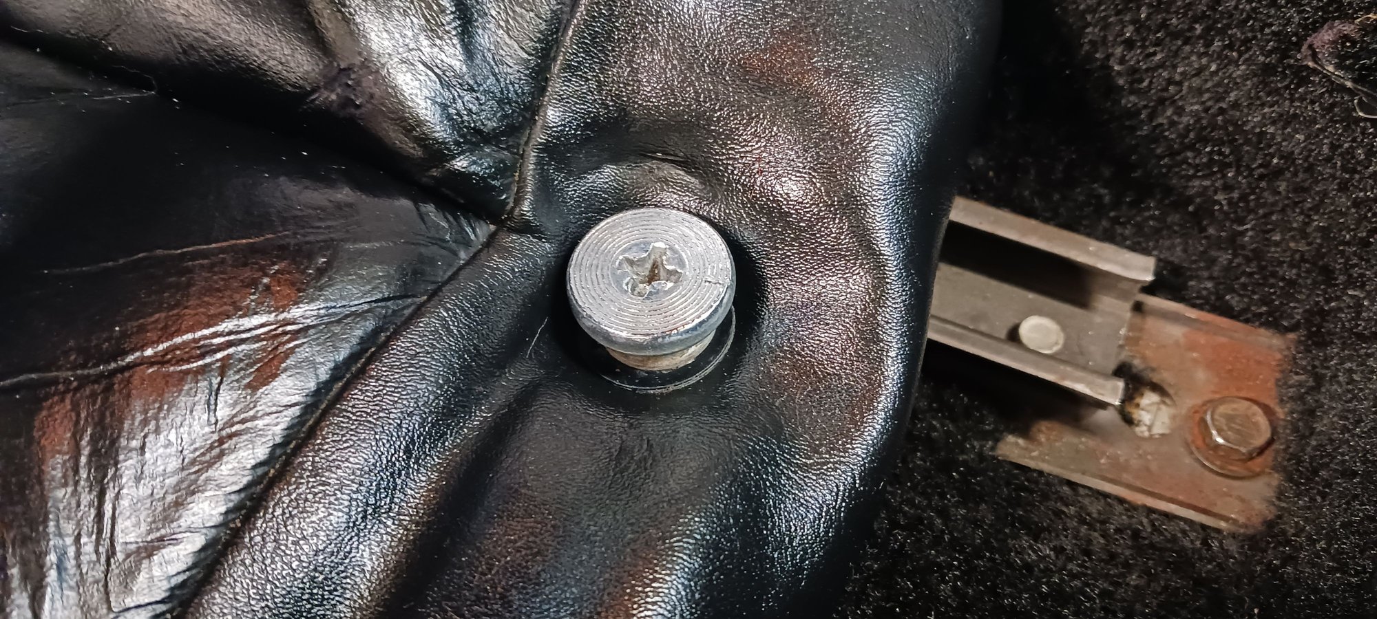

I don't recommend messing with these things.

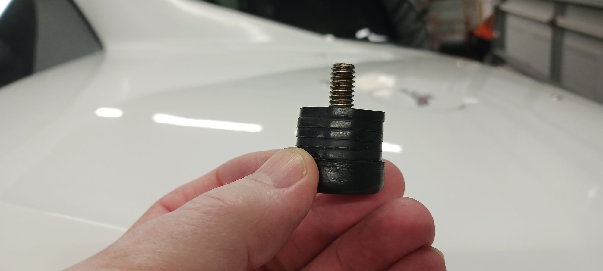

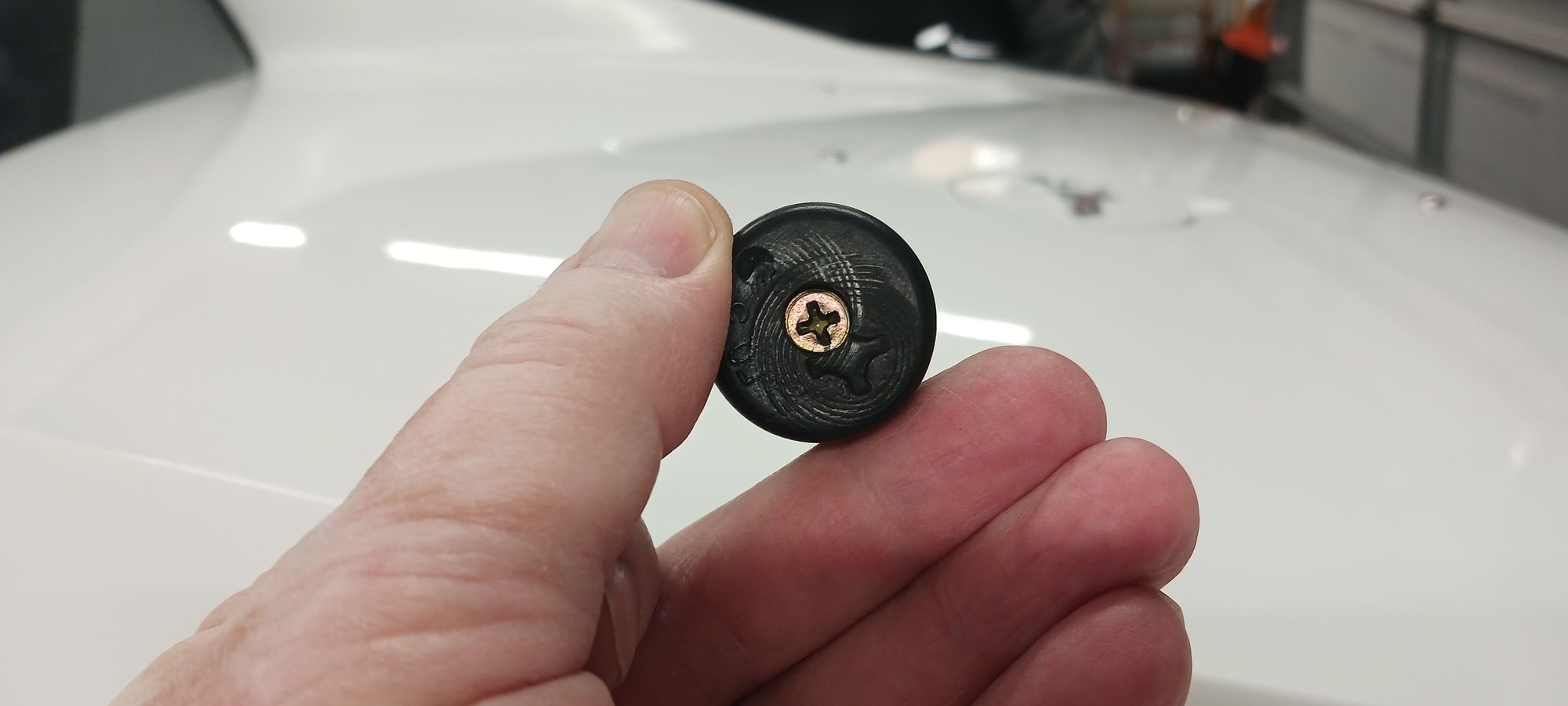

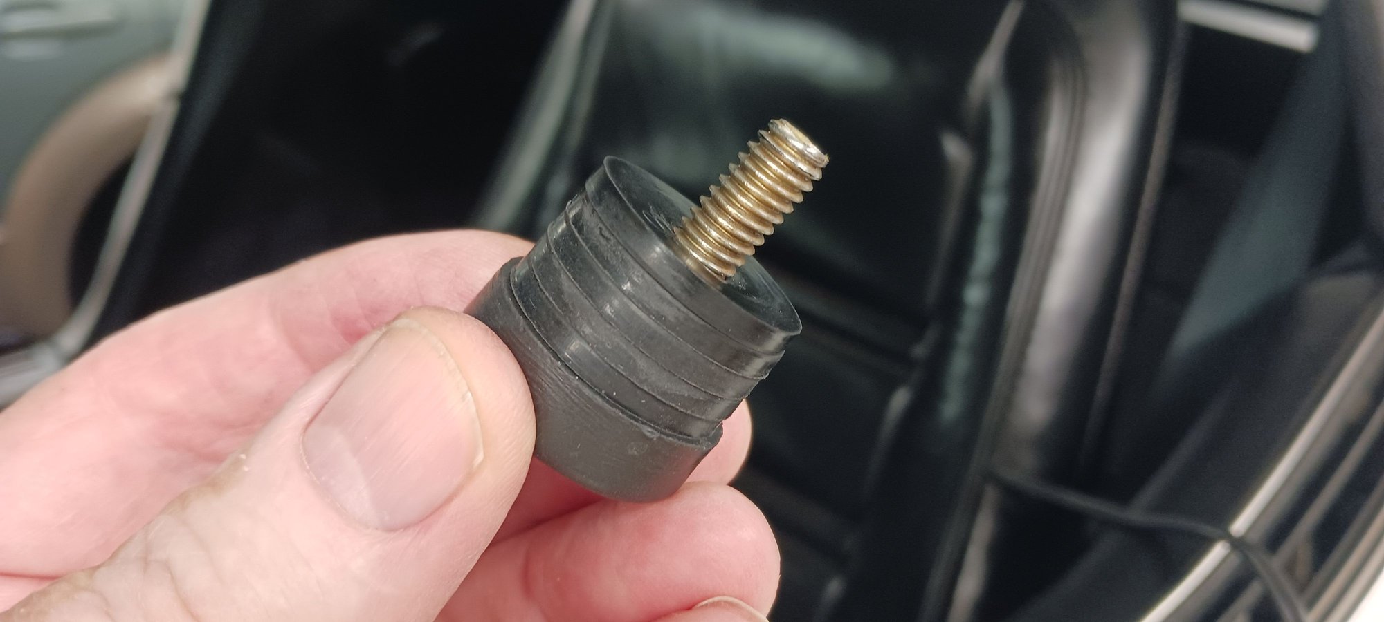

Instead, back the bumpers out of the bottom of the seatbacks...
...and install a stack of rubber shims like this:
The ID on the rubber shims is 1/4", the OD on the bolts is 5/16", but as the shims are rubber and have a little give to them, you can easily screw them down onto the bolts (or screw the bolts into the shims). You can also see from this photo that even though I've commandeered 5/8" of bolt shank, there's still plenty of shank remaining to thread back into the seatback frame to insure a strong, robust mechanical connection.
Simple and strong, and easily adjustable via adding or subtracting shims to further raise or lower the seatback angle. You can see that the shim on the far right, at the bottom of the stack, has conformed slightly to the seatback base, helping insure solid mechanical contact of the bumper assembly to the base. Stacked and slightly compressed in this manner, the rubber shims are actually load-bearing and a key component of the strength and integrity of the overall structure.

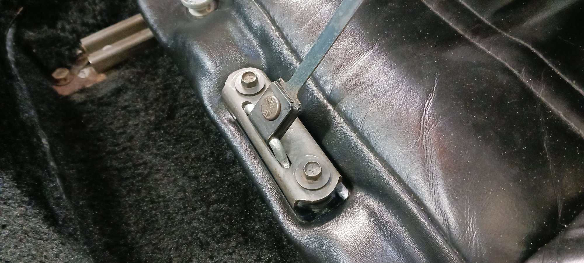

I only used three shims per side on the seatback locking mounting assembly, instead of five; this took up a little slack in the locking mechanism so the seatback now doesn't have excessive fore-aft "play" in it when it's in the locked position:
In the above pic you can again see that the shims are large and load-bearing, contributing to the mechanical strength and integrity of the overall structure. Bulletproof, in other words.

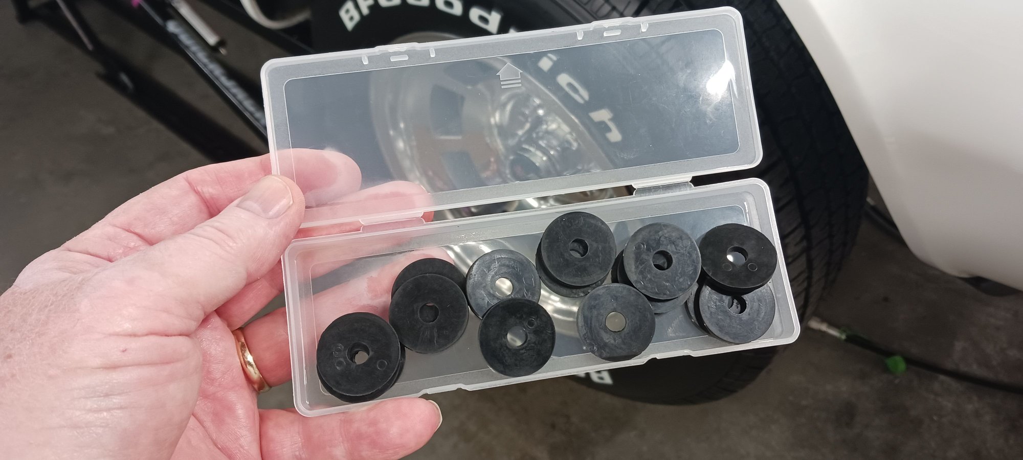

I originally bought 25 of these rubber shims, for $6.99, not knowing if they would work to my satisfaction, and liked them so much I bought another 25. In retrospect, I should have bought a 50-pack for $8.99.
