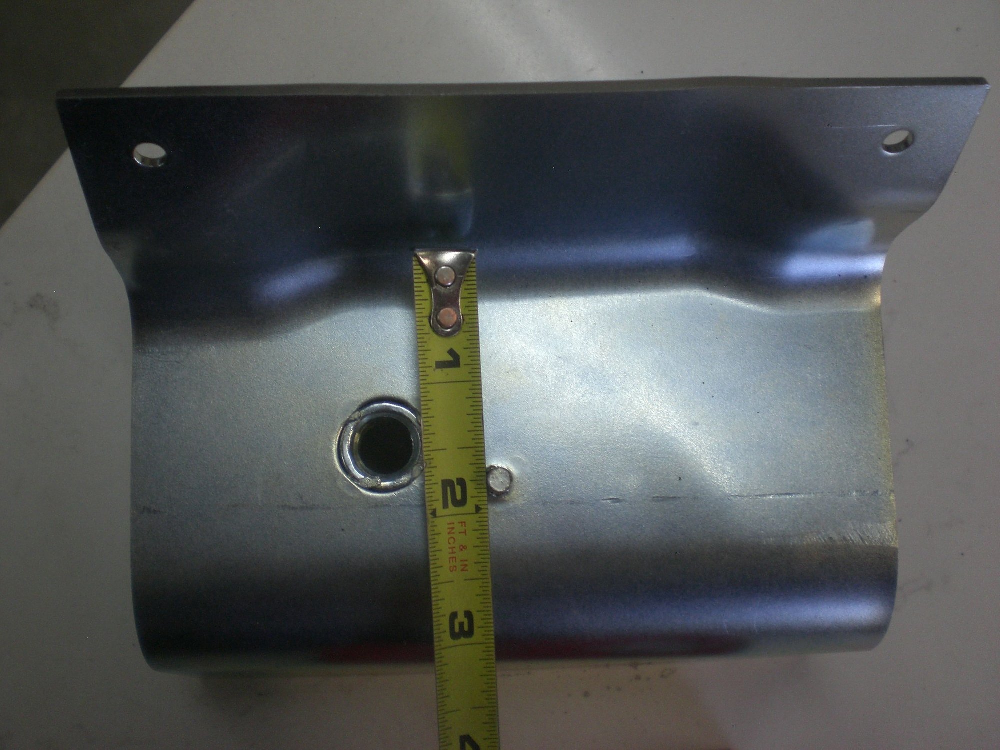

The following photos are from my '71 coupe - hope they help
Shoulder Belt Mounting Plate in RR Wheel Well
Mount plate has welded nut for belt reel and locating pin
Mount plate has welded nut for belt reel bolt and locating pin
Shoulder belt reel on inner RR wheel well hump

Awesome... thanks. I had been looking on the pillar.

Originally Posted by ClassicJoe
Good info. I'm redoing the interior of my '70 Coupe, but no obvious location for attaching the upper shoulder belt to the body/frame, no obvious threaded holes or anything . Anyone have pictures of where these go on both Driver and Passenger side.
In addition to what nwav8tor showed, you also need seat backs with belt pass-through "holes" and the trim for the front and back. If you google images, you'll see pics of the belt and back. There are threads here on CF that talk about the proper internal bracket and how to cut the passage.
