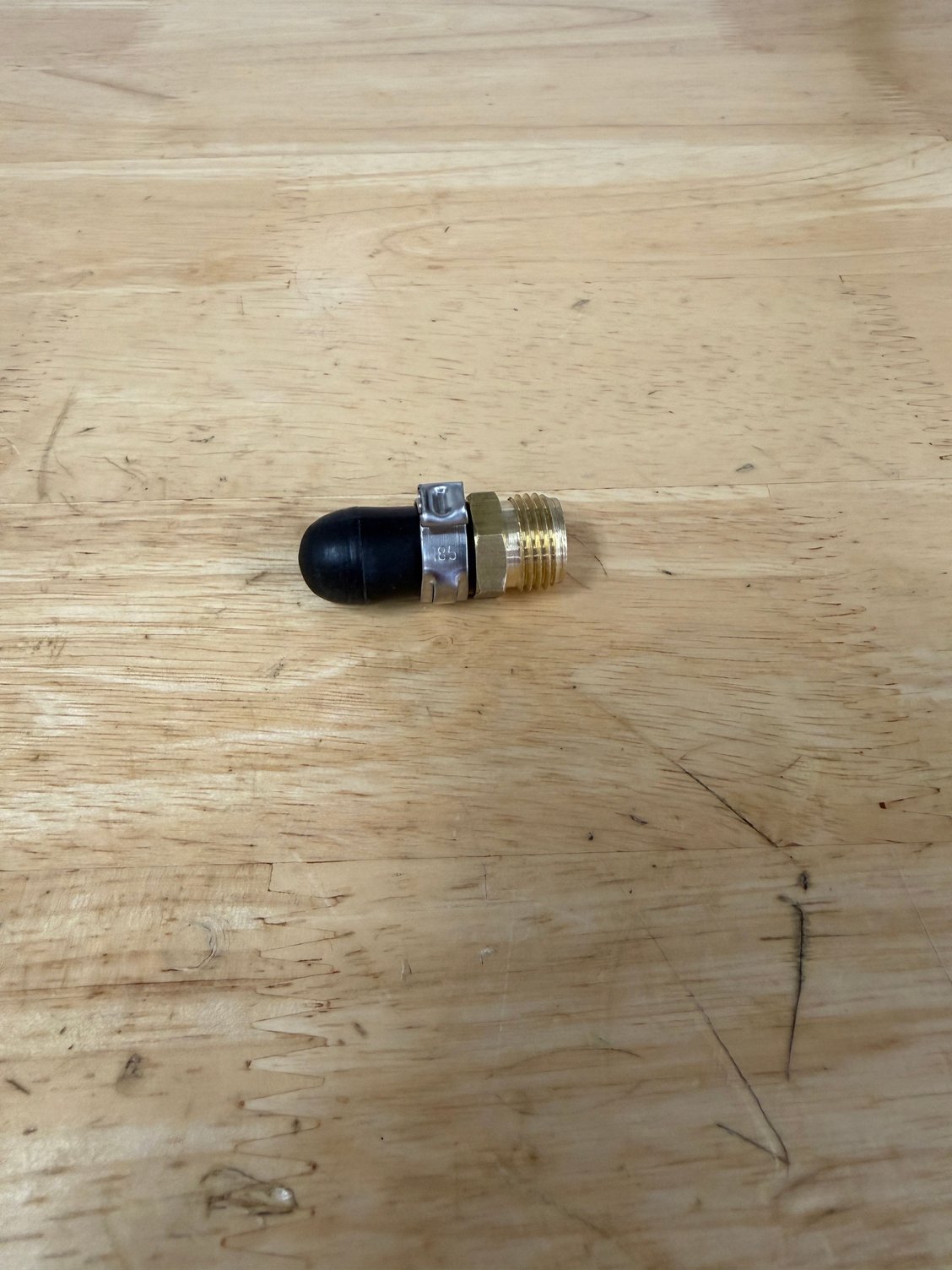

My local Advanced Auto had a 5/8-18 inverted flare to hose adapter. So I made a plug out of it so I can fish the new line in without a continuous flow of fuel coming out.
