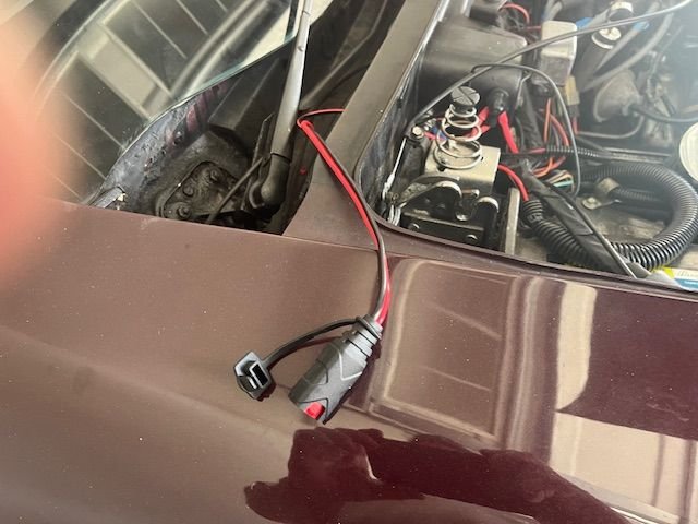

I purchased a plug in from a rv store and installed it in the wiper tray. I just lift the hood and plug the tender in.

that looks really clean, what brand did you go with? for the actual charging

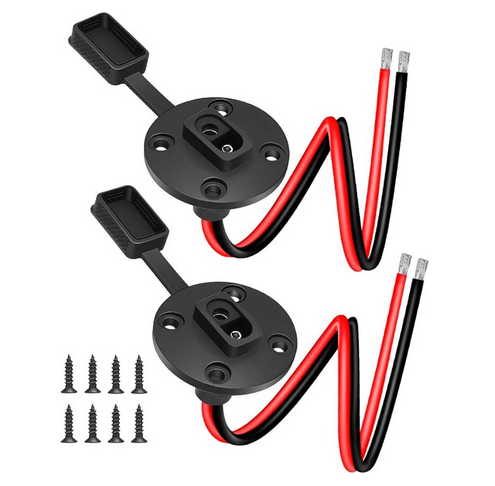

That looks like the standard solar power connector. There are lots of options on Amazon, including this one.
Though I exclusively use it to charge batteries out of the car, this CTEK charger will work to maintain as well.
There's even a CTEK adapter to go from the CTEK connector to that solar connector.

I have the battery tender Jr. It also came with the connector that plugs rite in.

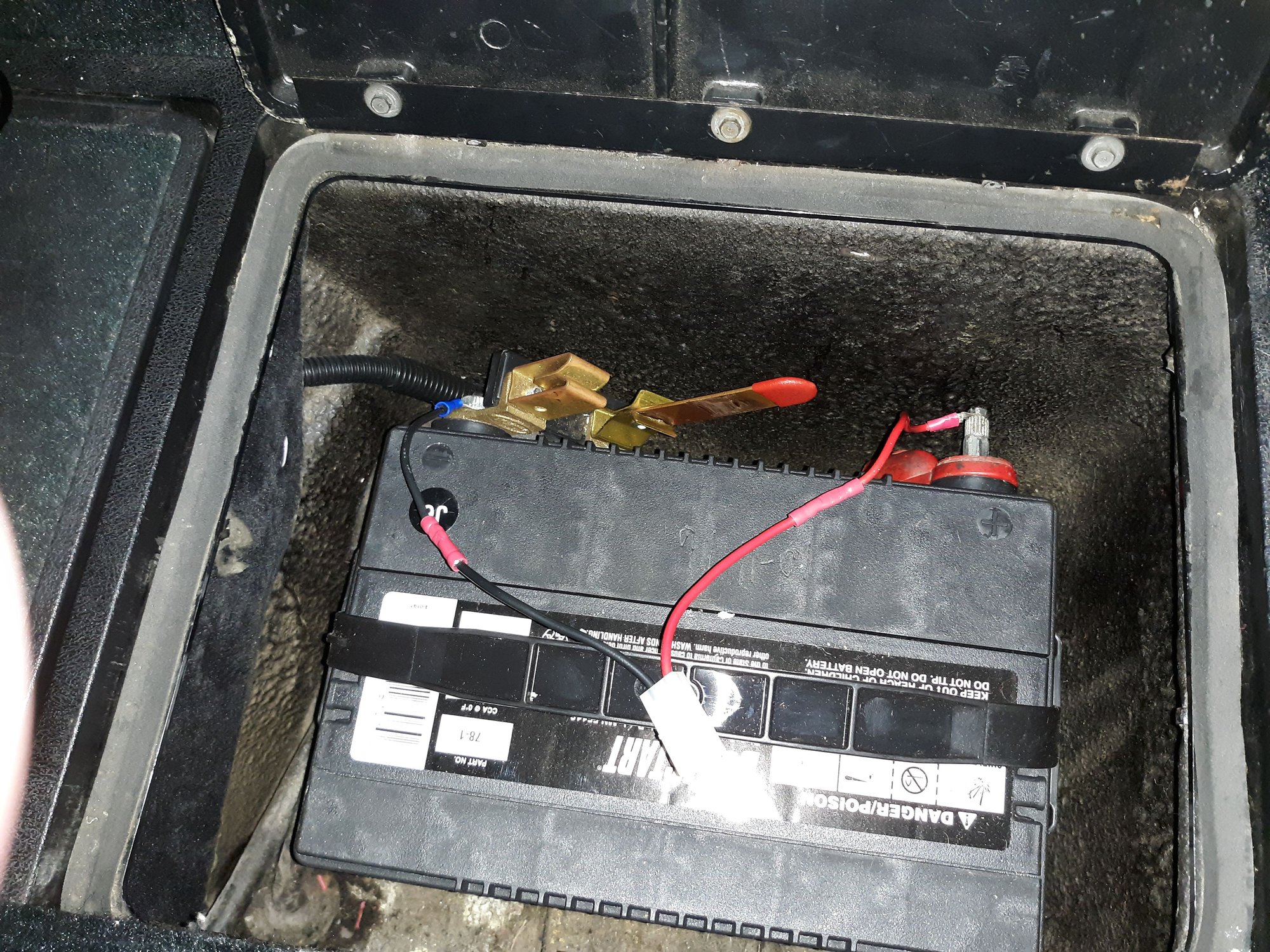

I keep Eastwood battery tenders on all the old stuff in my garage year round-3 vintage cars, a Harley, the lawn tractor and a battery from my trailer break-away. On the 76 Corvette I mounted a positive and negative lug in the battery tub and wired them directly to the battery ( the small harness came with the Tender). I just flip open the battery door and plug the Tender into that harness, I run the wire through the window and the Tender sits on the floor next to the car.
