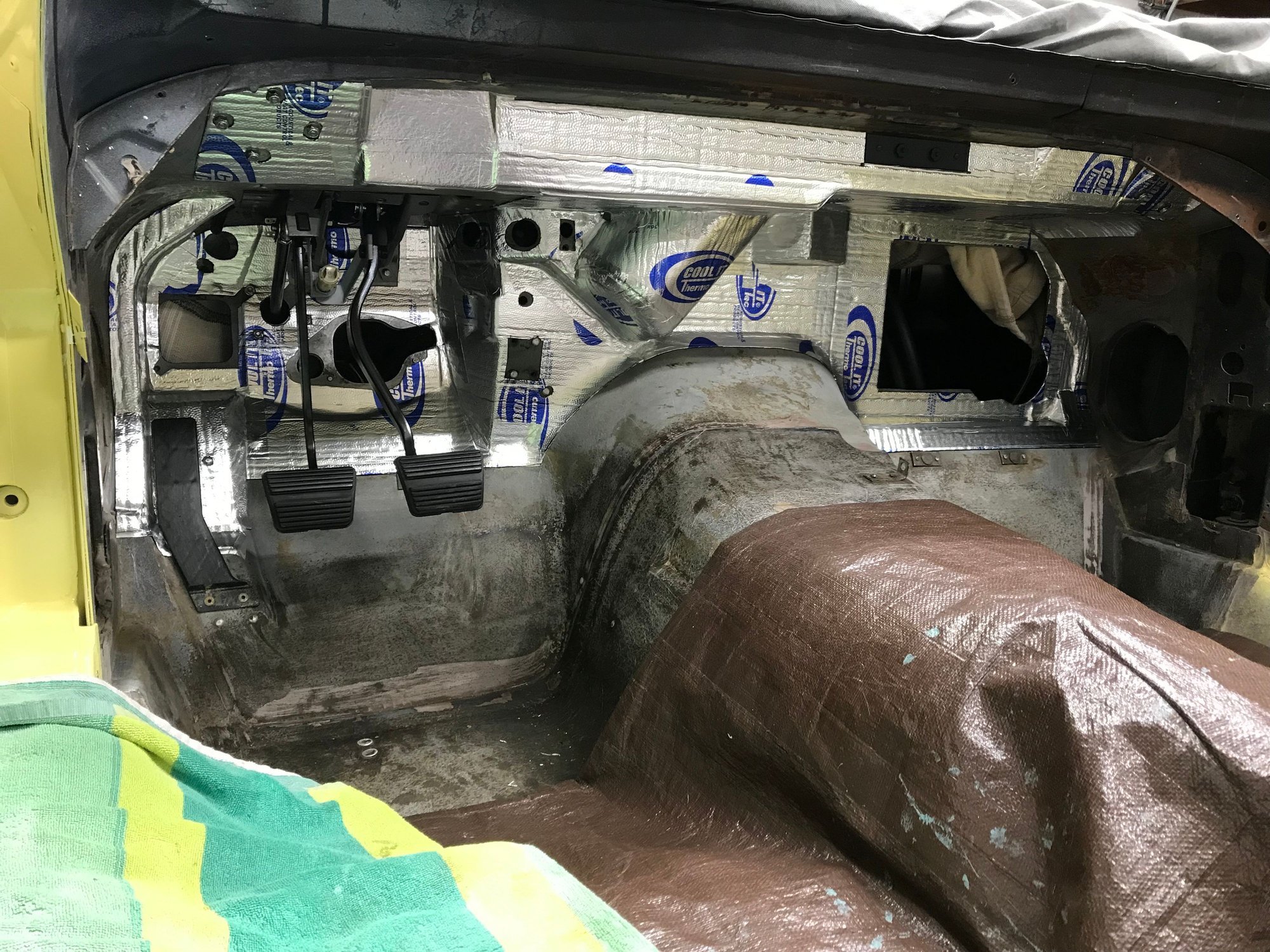

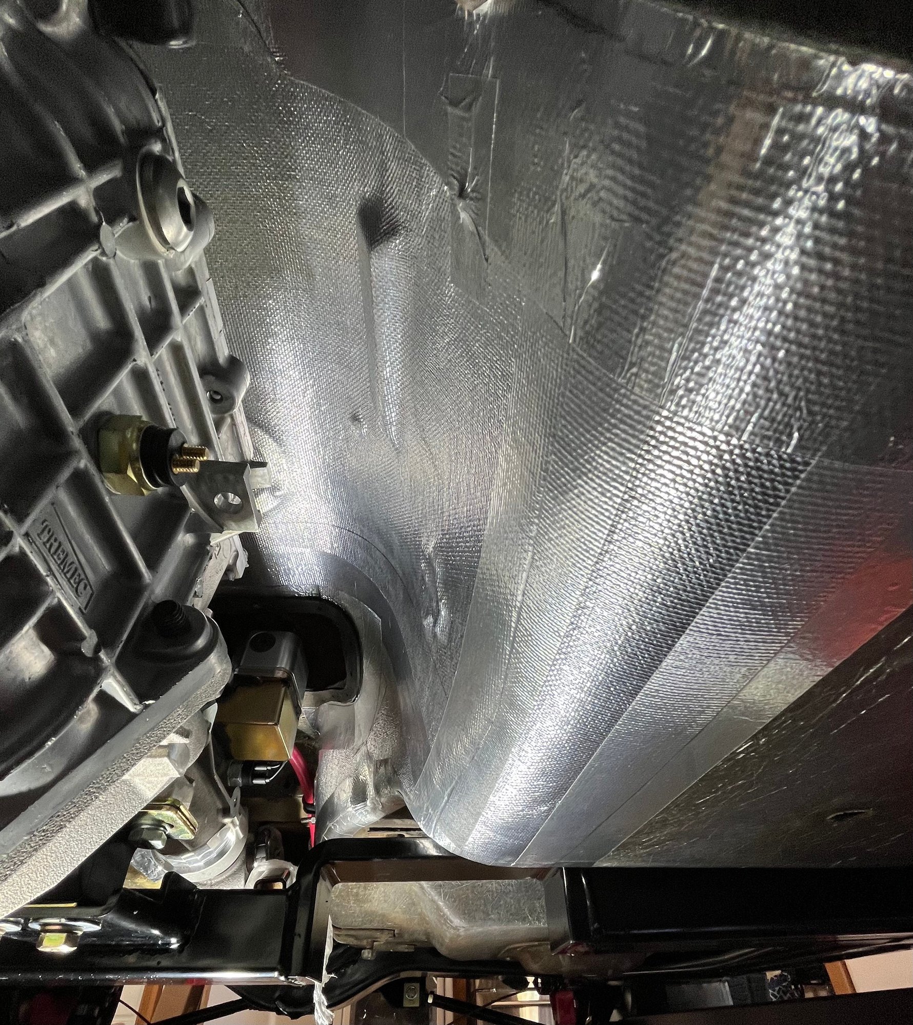

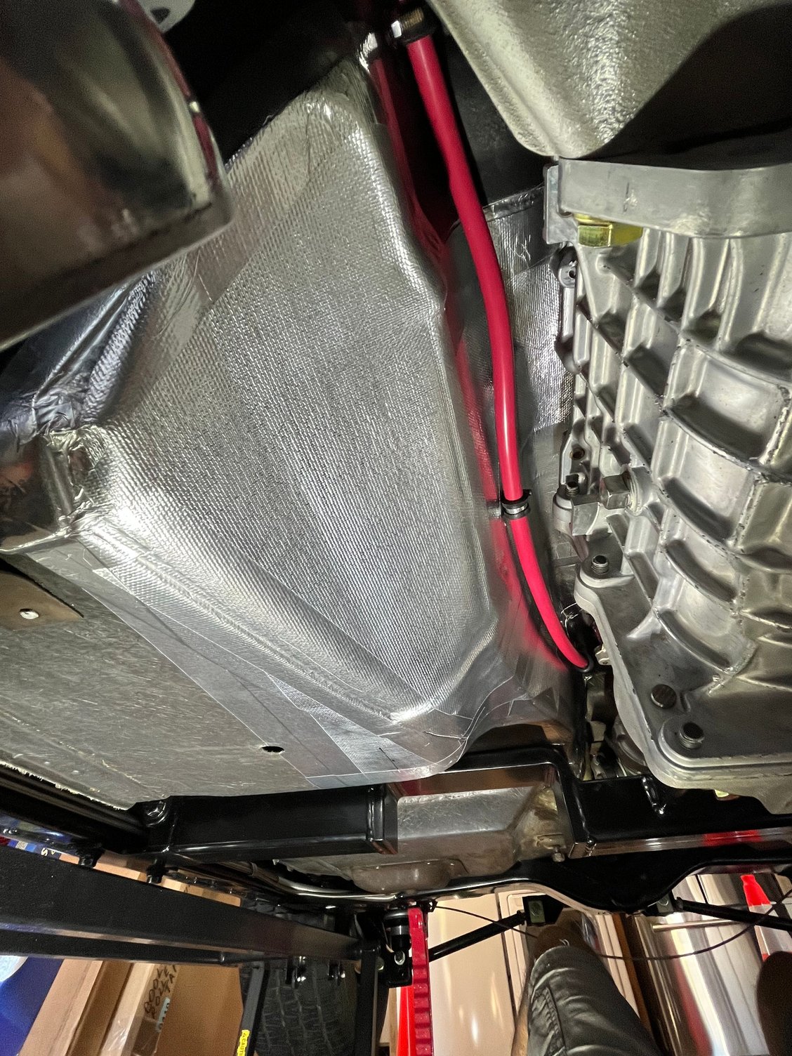

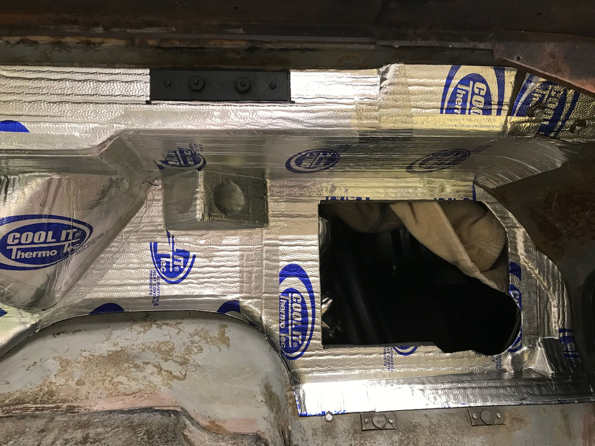

I’m using Thermo Tech Cool It Suppressor Mat in my 73’s interior, and the firewall.
I’ve only completed the firewall for now and once I’m ready to install the carpet, I’ll install the Cool It Mat throughout the interior.
I used their Heat Barrier in the transmission tunnel.
It was easy to lay down and both have self adhesive backing.
Thermo Tech also sells their own seam tape to seal the edges.
Like the other brands, it is expensive.
