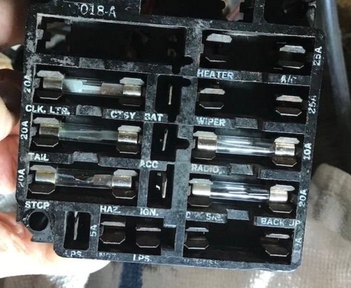

Battery has been draining, looking for reason. New battery with good 12v, ground to battery seems ok with 0 resistance to frame, now no power to dash, starter when I turn the key. Ignition switch, key cylinder, other???
Any suggestions from you good people.

I’d start by checking to see if you have power at the BAT terminal on the fuse box. If nothing, I’d try putting in the old battery first and see if you have power.
Checking a fusible link is no different than checking for continuity in a wire. Using the wiring diagrams, you’ll need to identify wire connection points on either side of the link.

I would start at the horn relay buss bar. Do you have power there? Then if yes move forward, if no back up to the starter solenoid. Power at the starter solenoid?
etc.etc.
