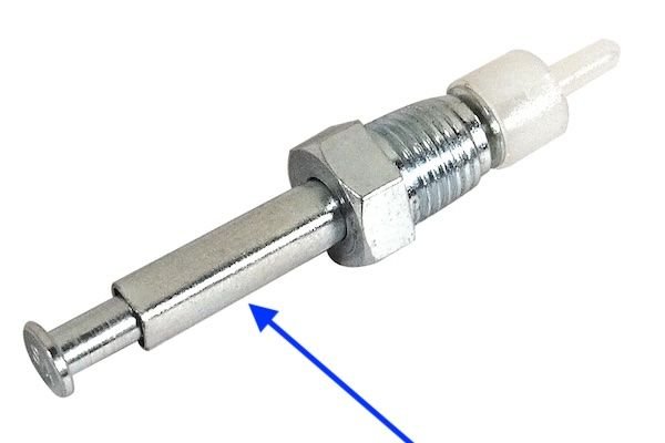

Yes, these are self-adjusting plunger switches. Gently extend the tubular section outward from the hex nut. Don't pull on the plunger itself. If you can carefully remove the wiring from the switch (not easy) then you could push the tube outward while in a vise. Once it's extended, when the door shuts the tube is pushed inward the proper amount.
The switch below is in the fully extended, ready to be installed state:

Thanks for the quick reply! I will definitely give it a shot.

That advice worked great! Thanks again.
