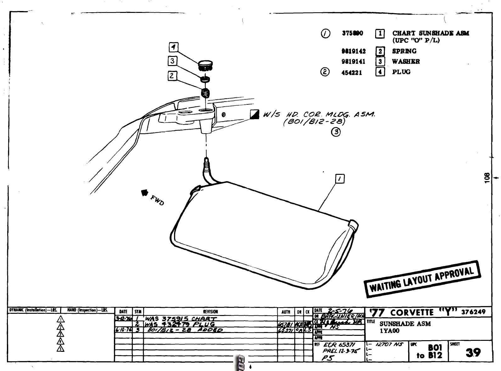

The shaft does not pull out...
You remove the Plug, then unwind the push nut & spring...

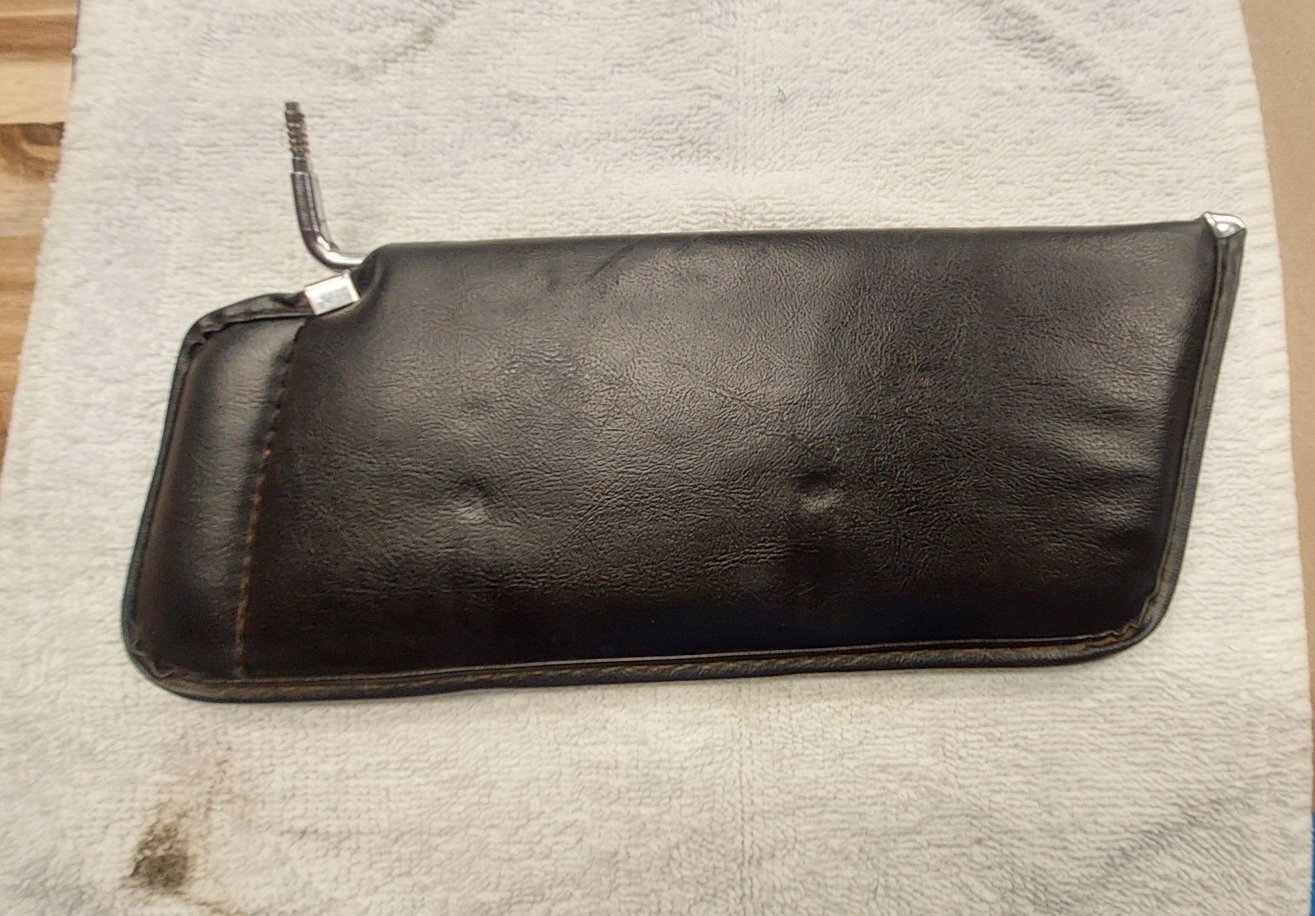

Yes the pin comes out, but unlikely without removing from car...

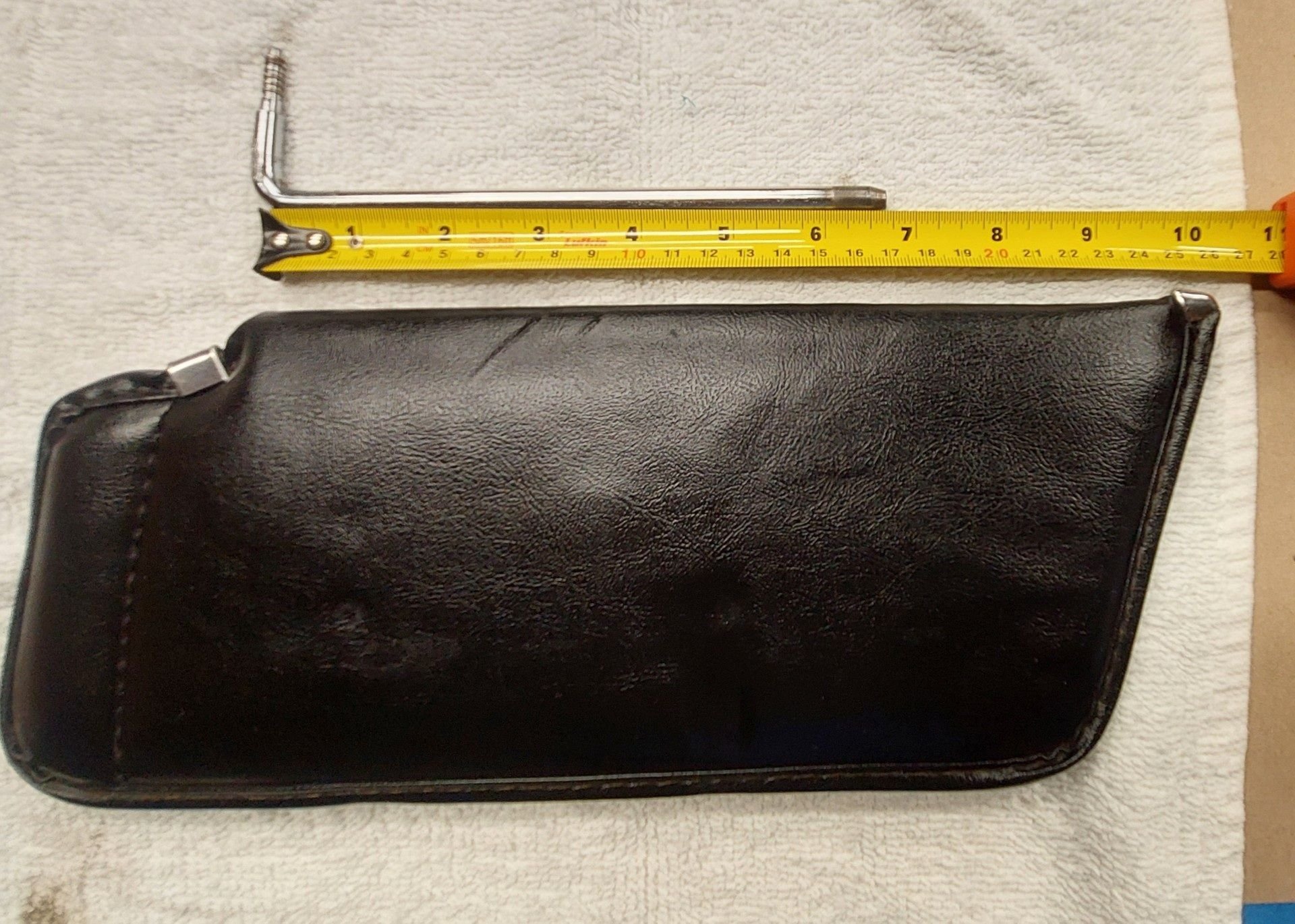

I few drops of Kroil penetrant, chuck it up in soft jaws vise and rotate back in forth while pulling, add a few more drops of Kroil, back in forth pulling and it came out after several cycles...
The pin is about 6 3/4" in length...
