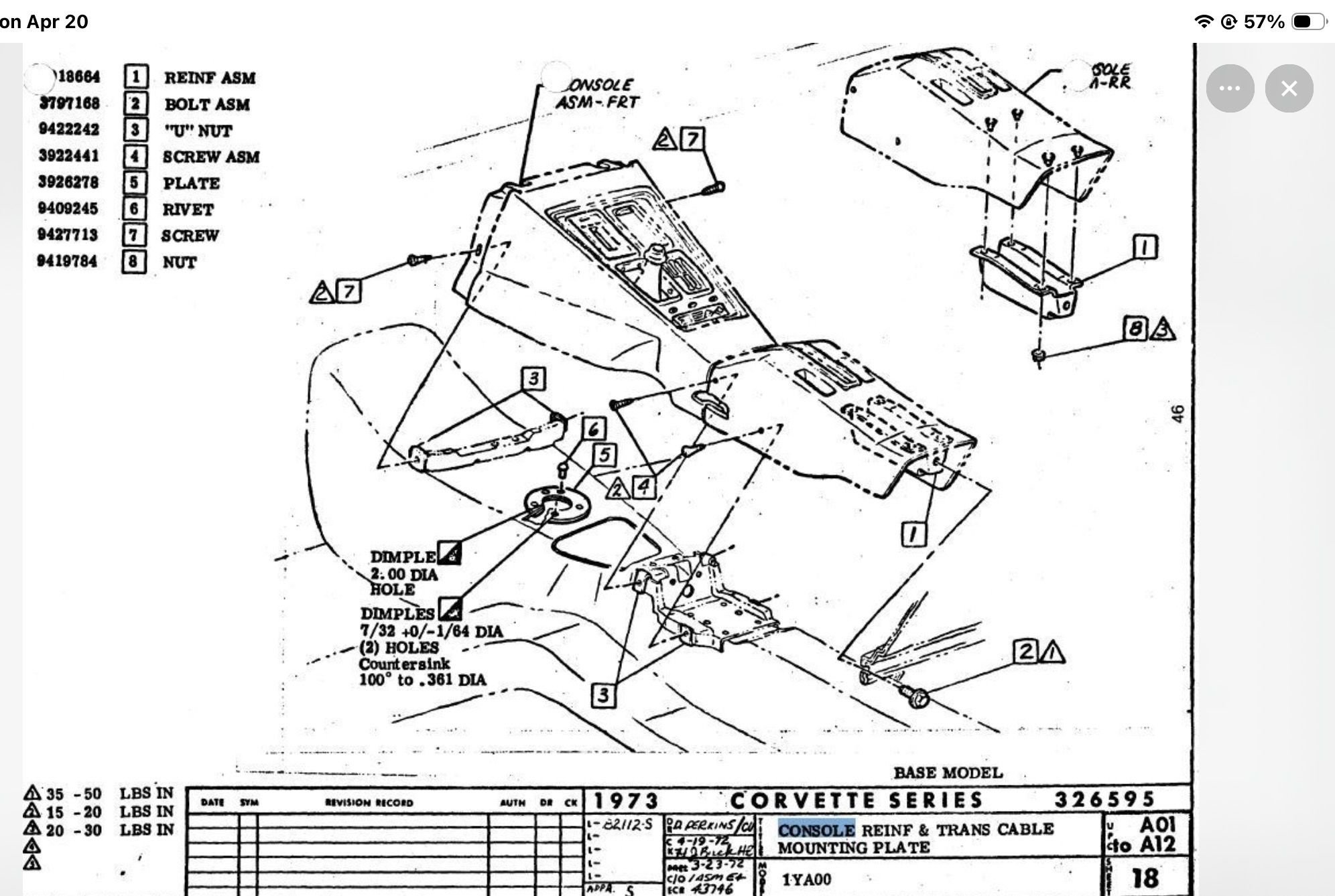

This graphic is from a 73 but illustrates the lateral bracket that is attached to the top of the tunnel to which your console reinforcement bracket attaches to.

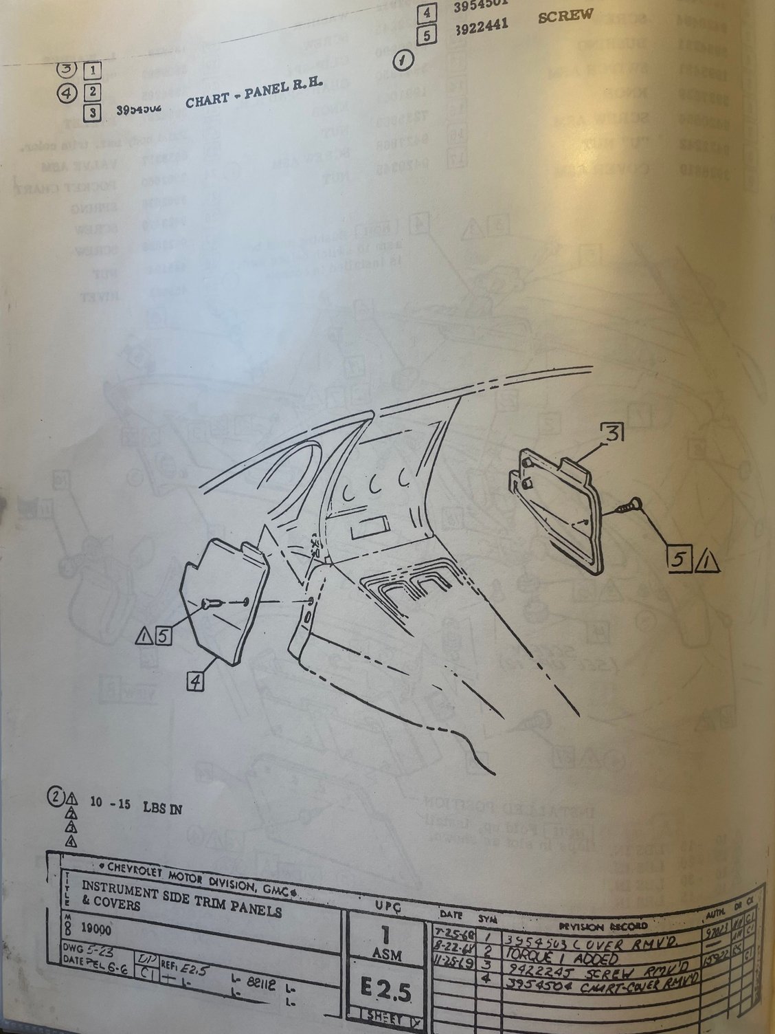

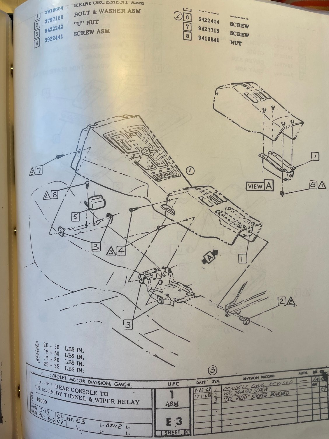

Here is a couple of pages from my 69 AIM

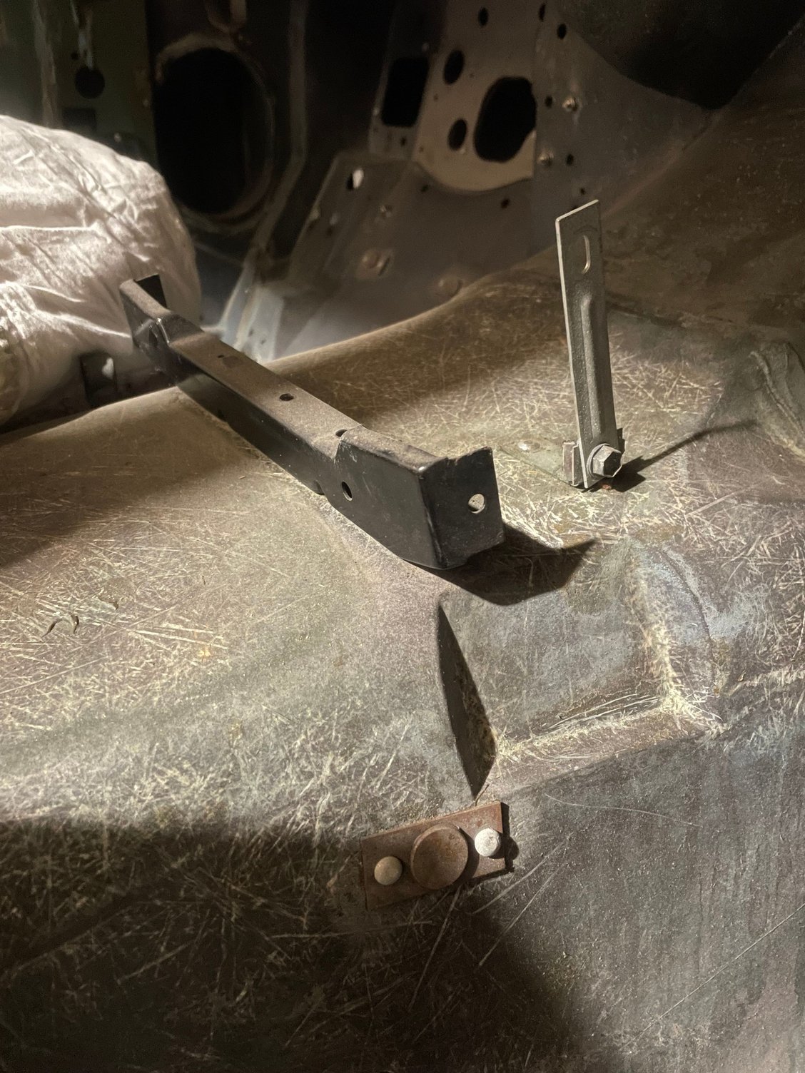

I just took this pic of my 69. The bracket is riveted to the tunnel. The console attaches to the bracket. The smaller bracket is the radio support.

OK. When I installed my reproduction shift console, I wasn’t sure how to attach the console to the tunnel. This is very useful information. Thanks very much for the info and the picture!
Thanks everyone for taking the time to help me out!

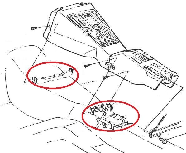

There are two metal brackets on the tunnel that the console gets attached to. The rear mounting also holds the front of the parking brake console in place. This way the front and rear of the console are held in place.

I didn’t realize both consoles had mounting tabs. Looks like I’ve got some more work to do, lol. Thanks for the information and picture.
