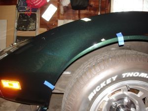

In 1978 if you ordered the 255/60/15 tires they did some trimming to provide some clearance. As you can see in the first pic between the blue tape it is trimmed and also the inner corner of the fender lip was also trimmed. (small triangular cut). Smaller front should work.

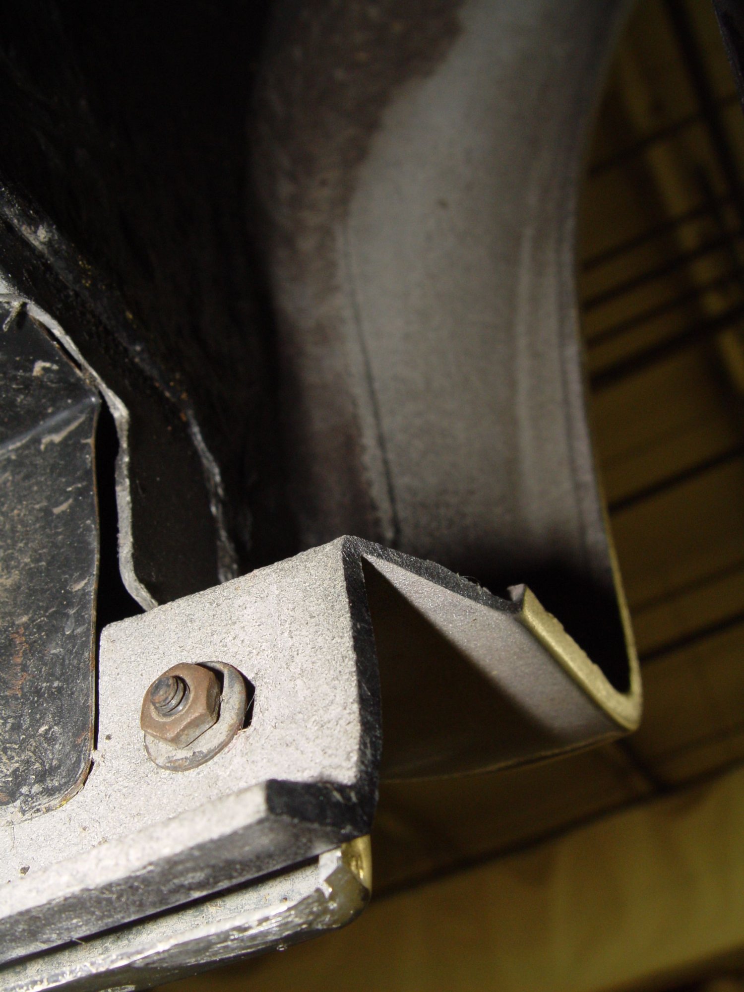

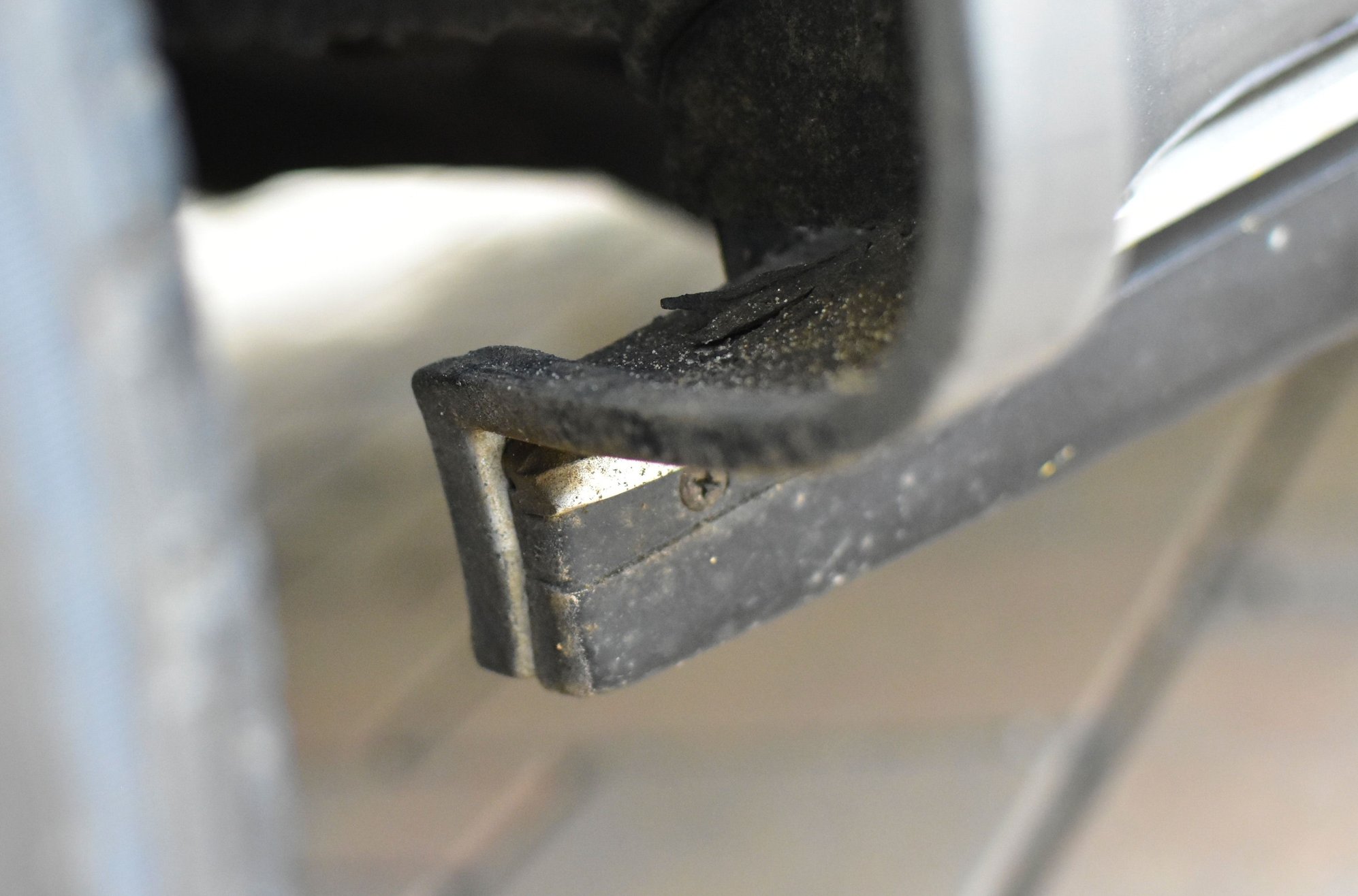

Just to add to BKarol's post here are a couple more photos of the trim to the fender lip and the rocker panel lower corner
This is the rocker panel corner trim
This is the non-trimmed corner of the rocker panel
