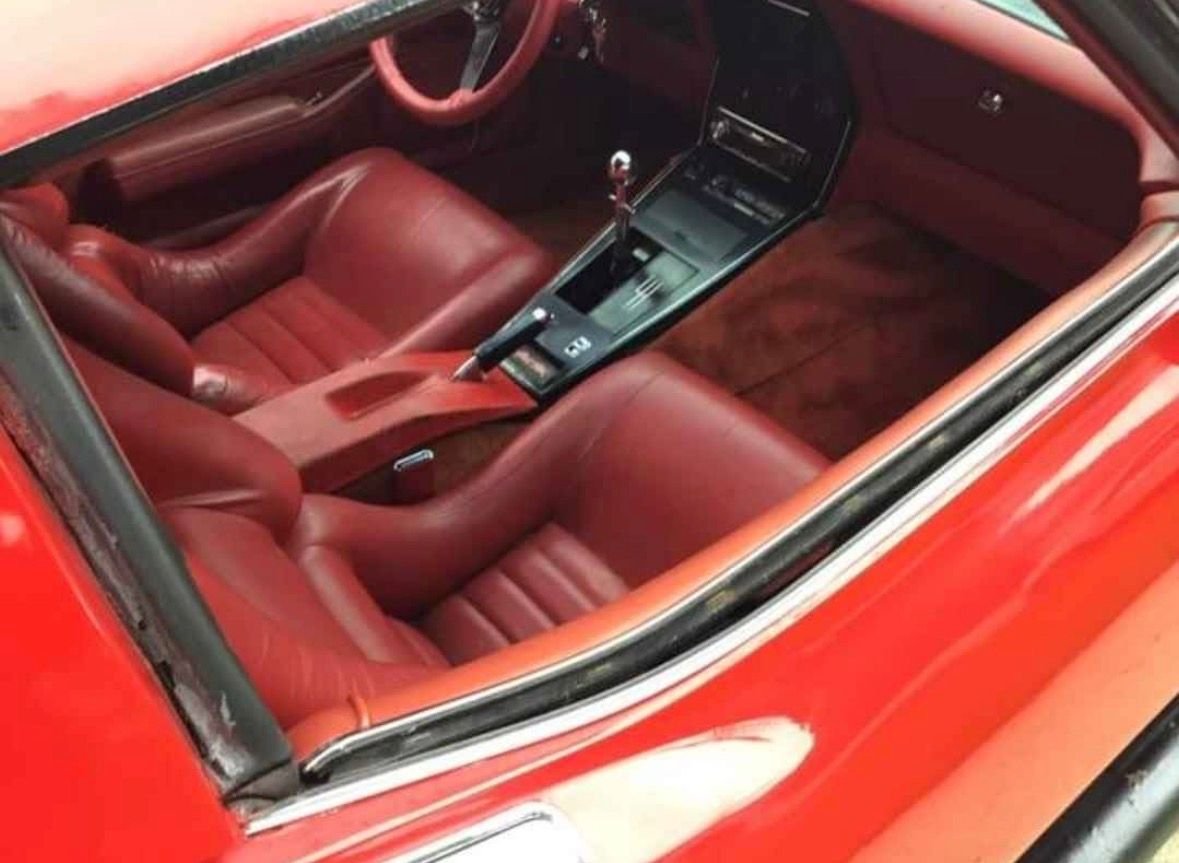

Here are some pics from the listing

That interior pic shows a four speed shifter, not an auto.

Yes it is a manual not auto I had it wrong originally.

looks like the weather stripping could use some attention.

what was done to interior? pics of before and after? new insulation?.

Went and looked at it a few hours ago and it was a train wreck to say the least.
First of all, for anyone who looked at that post and scrolled through the pictures and thought that it was extremely clean and maybe too good to be true. It was.
The car was completely different in person, I borderline don’t think those pictures were from the same car or at least not taken in the last 15 years
The paint had bad 10+ bubbles, 10+ large scratches and chips, and was not at all like the photos or what was said to me over the phone
The interior had multiple cracks, scrapes, and tears in the leather and plastic and was not at all like the “freshly restored” condition that the pictures showed or what was said over the phone. Leading me to believe the photos were taken a decade ago or he was just straight lying and the photos are from a different car.

It was a little suspicious seeing the listing pictures with the engine bay not finished. Glad you dodged a bullet!
