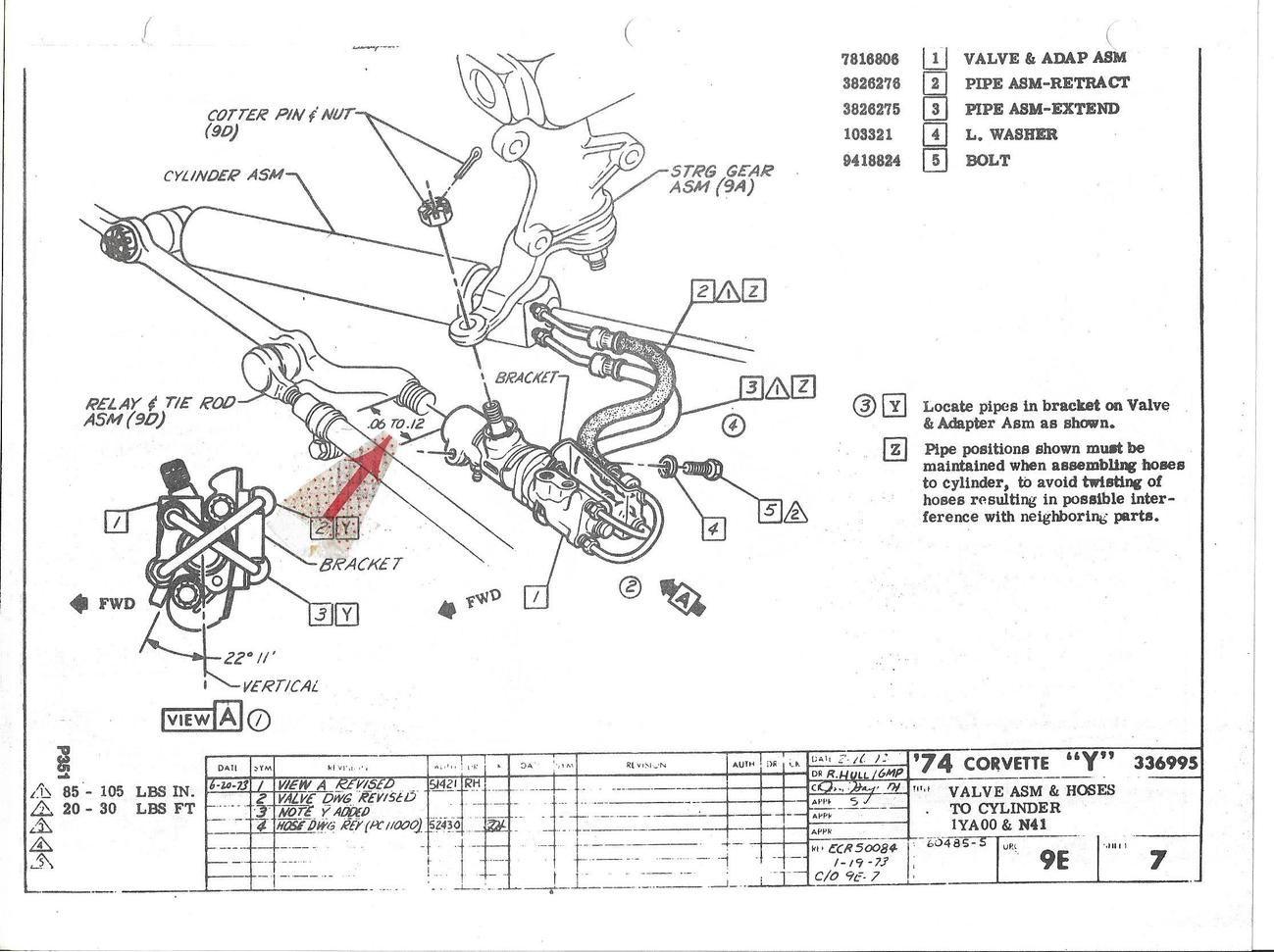

You have to get under your car and inspect everything closely to pinpoint the leaks.
The PSCV or the cylinder might be leaking or one of the four rubber hoses, or it could be leaking where the filler tube meets the pan, or it could even be the transmission cooler lines or any of the rubber hoses on the ends.
