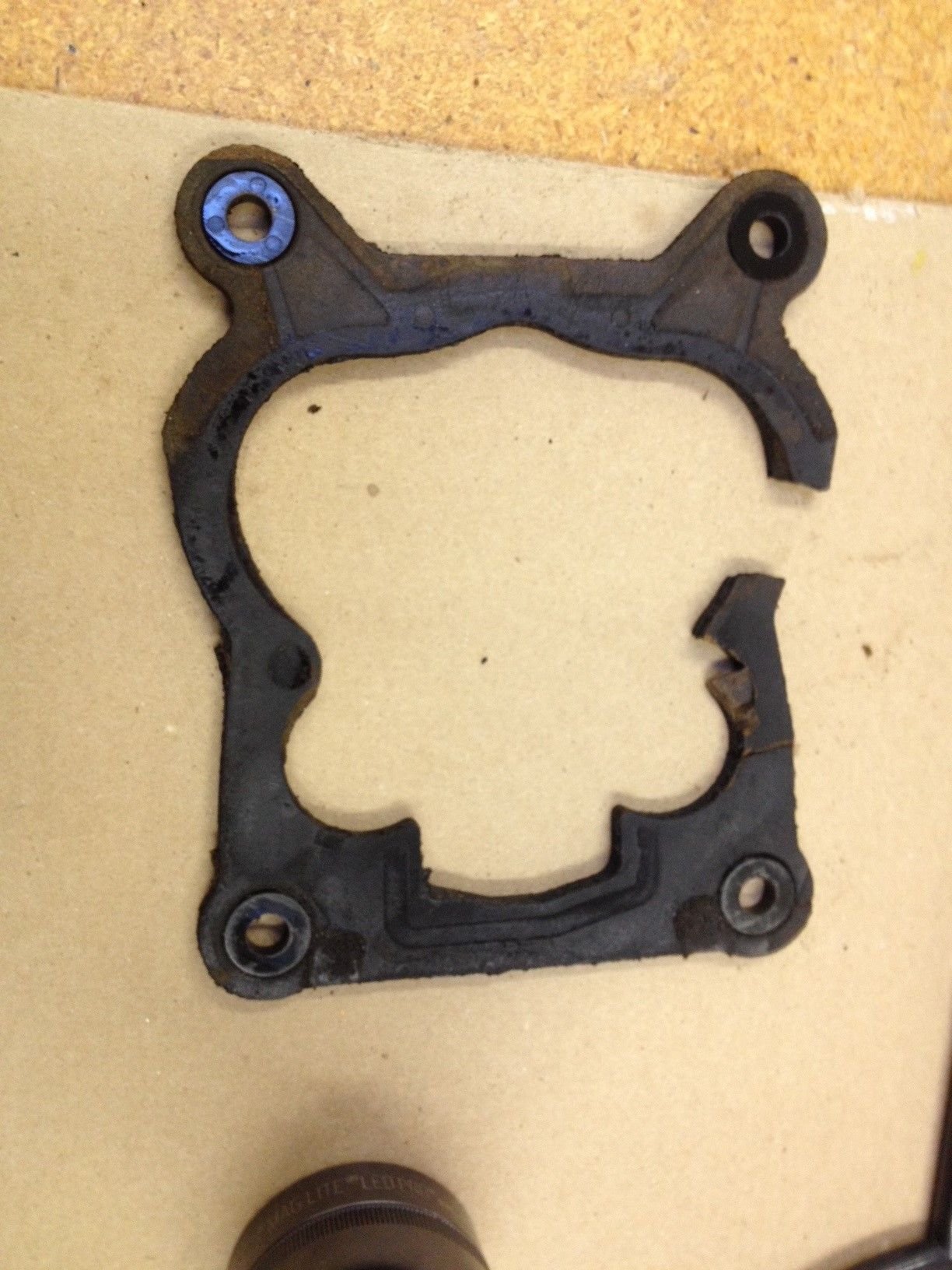

Not saying this is your problem ( no indication of a backfire - lean condition) but maybe worth looking at, my 76 L-48 was running great one day then next day total loss of power with engine dying, only way to keep running was to pump accelerator pedal. Would also occasionally shoot a nice flame up through the carburetor as well with the air cleaner removed. After extensive troubleshooting and deciding to remove the carburetor to have a look internally I found the carburetor base gasket had become brittle and broke apart causing a huge vacuum leak. Good Luck.
The large section missing broke off while I was scraping it off the manifold but there was a small piece missing....
