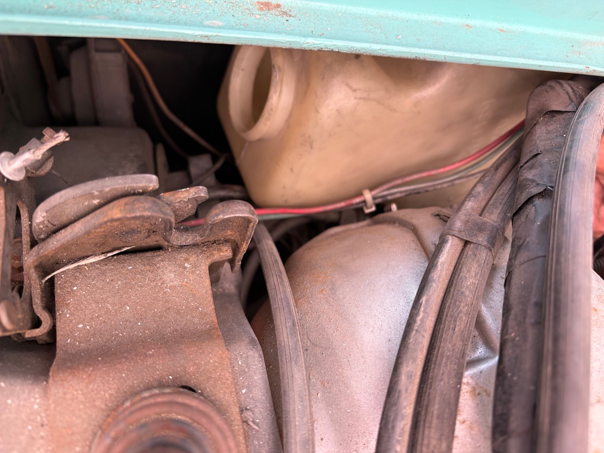

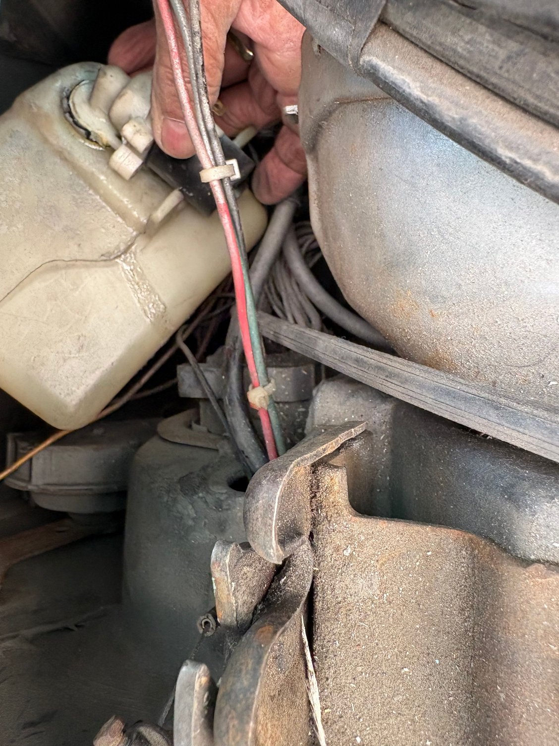

I had taken this out before to replace pump but unable to pull it up and out on my ‘77 this time. What am I d
Maybe I need a bigger hammer
Won’t fit between fender and brake booster

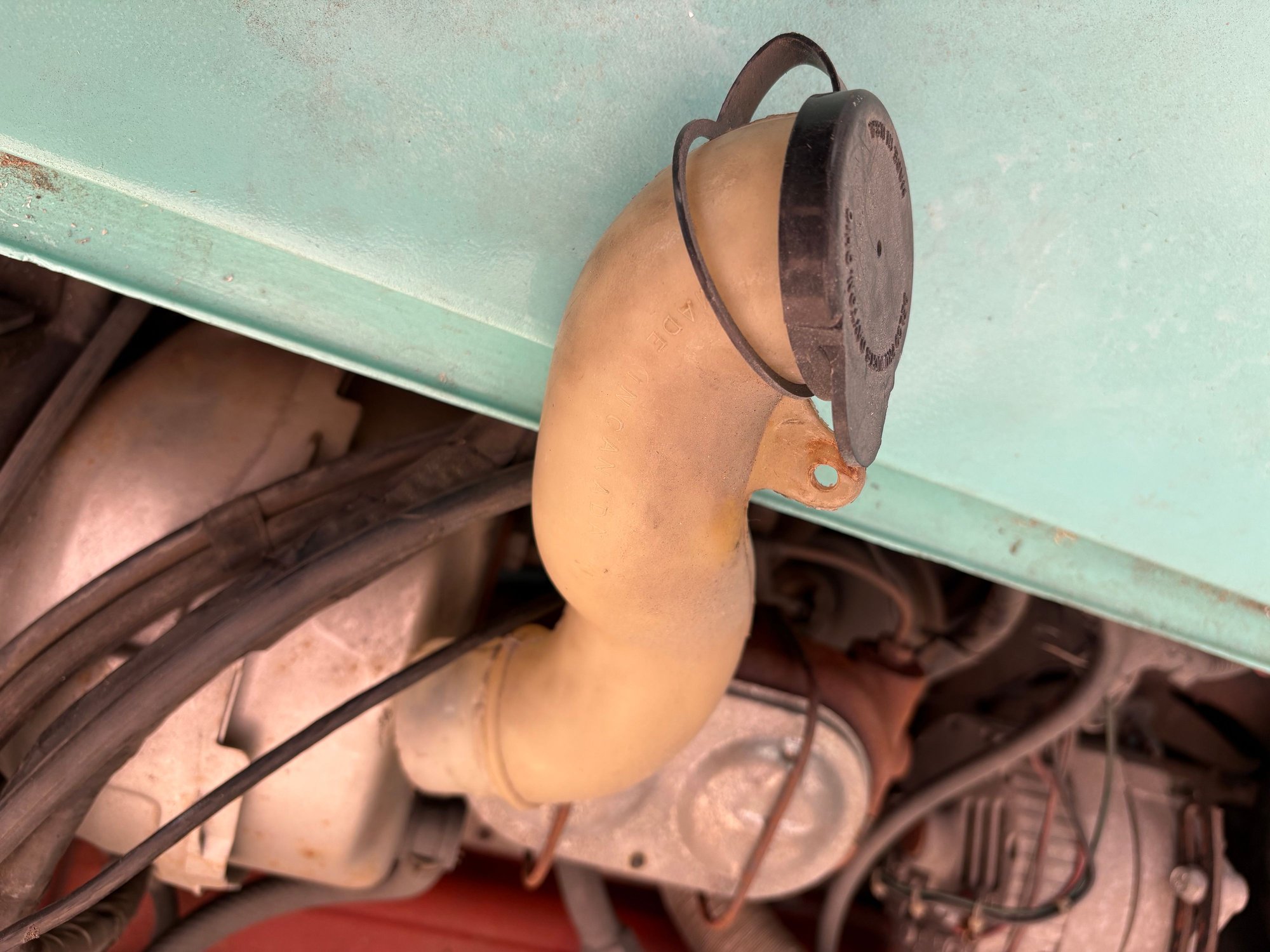

No problem removing spout. It has to come out because tank is leaking

How about out the bottom?
Remove your rocker panel trim, remove splash shield 3 bolts holding that on...

Yup, out the bottom. I replaced a pump in mine once. Was able to get it turned around in there. But not out. Once upside down I changed the pump with the tank still in the car.
