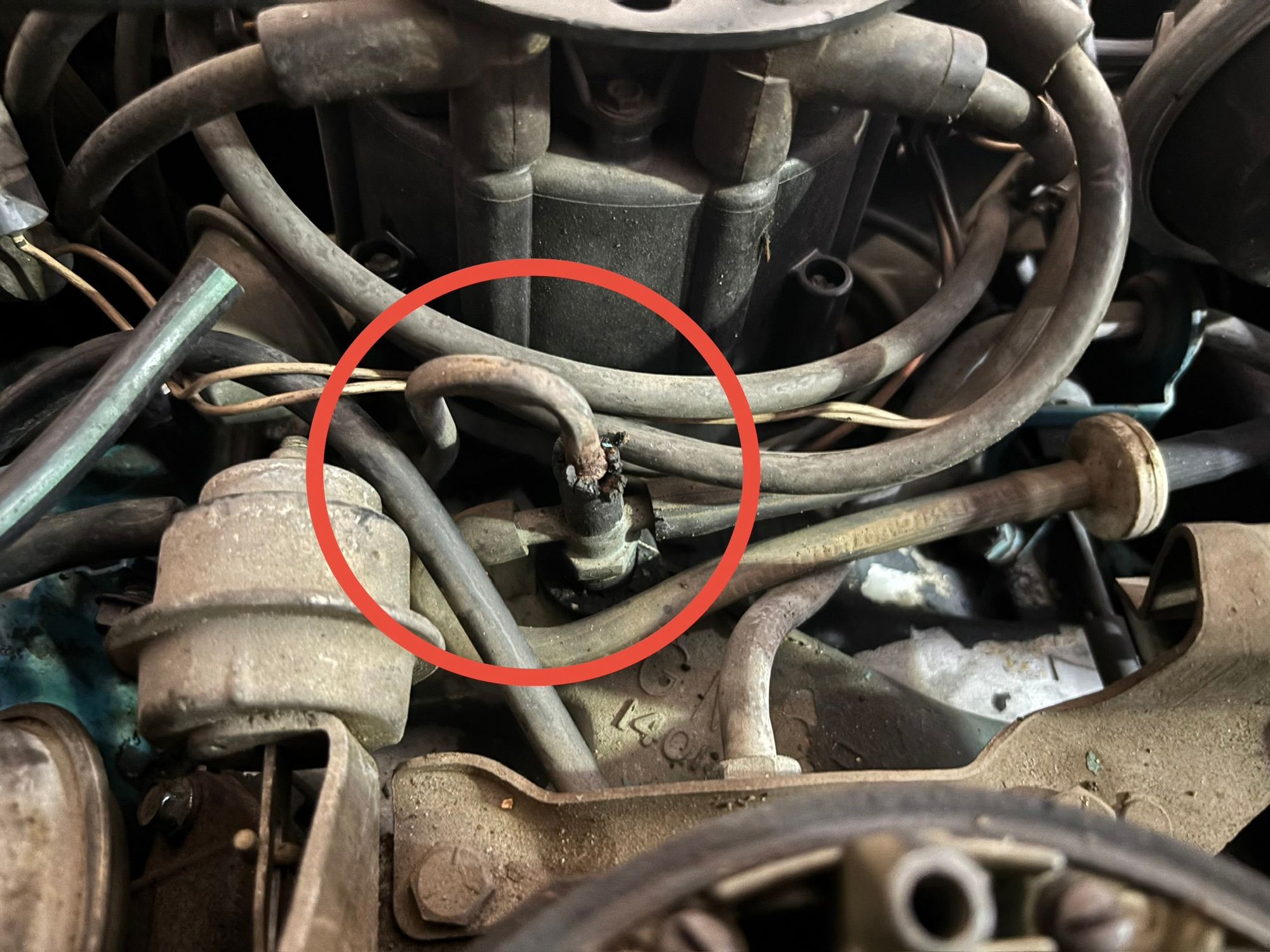

I’m trying to fix up an 1980 C3 that has been neglected for a while. Can anyone help identify what this is? It needs to be replaced. I try to know what parts are before I start removing everything.

A little too close to get a bird's eye view of the different connections, but I'm thinking it's the automatic transmission vacuum line to the modulator. Looks different than my '72, but it's a metal pipe connecting to the manifold T and heading down the passenger side of the trans tunnel.

I went out to the garage to check. My 80 does not have that, so the vertical feed and the hardline must run to the vacuum modulator on your TH-350 automatic transmission.
In the short term, you should replace that rubber hose (an any others that look like that). In the long term, you'll want a manual transmission instead.
