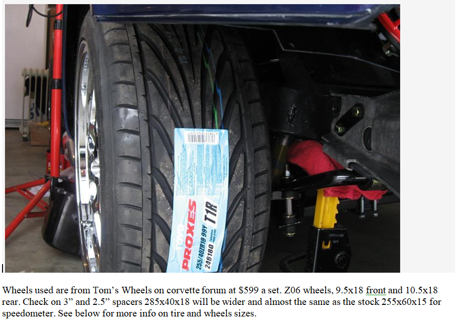

275-60-15 and a 1" spacer/adapter, photo below.
You'll have to relocate the brake cable bracket if you don't want the spacer. without the spacer it's a very tight fit, almost rubs on the trailing arm.
